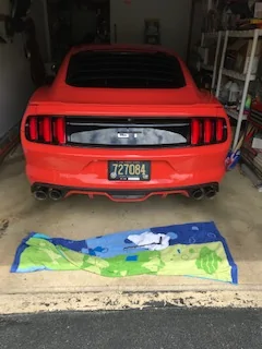

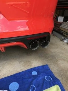

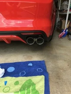

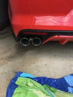

I just wanted to thank the Author for this DIY post. I successfully installed my quad tips this weekend on my car and I'm in love with the look. All done for about $80. It took me awhile to cut the valance to my liking, but it was well worth the time. I still need to adjust the mufflers due to them touching the inner side of the valance, but I'll take of that soon.
