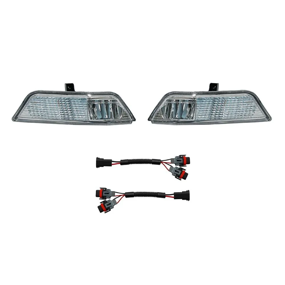

Relevant part to point out from the item description of that one:
Please Note: This kit does NOT include any additional wiring and/or switches that would be necessary to upgrade a 2015 V6, 2016-2017 Base Model V6, GT350 and GT350R models that were not originally equipped with Fog Lights from the factory.
I'm not sure how it functions without the additional wiring in there (would the fog part always be on or never come on?).
