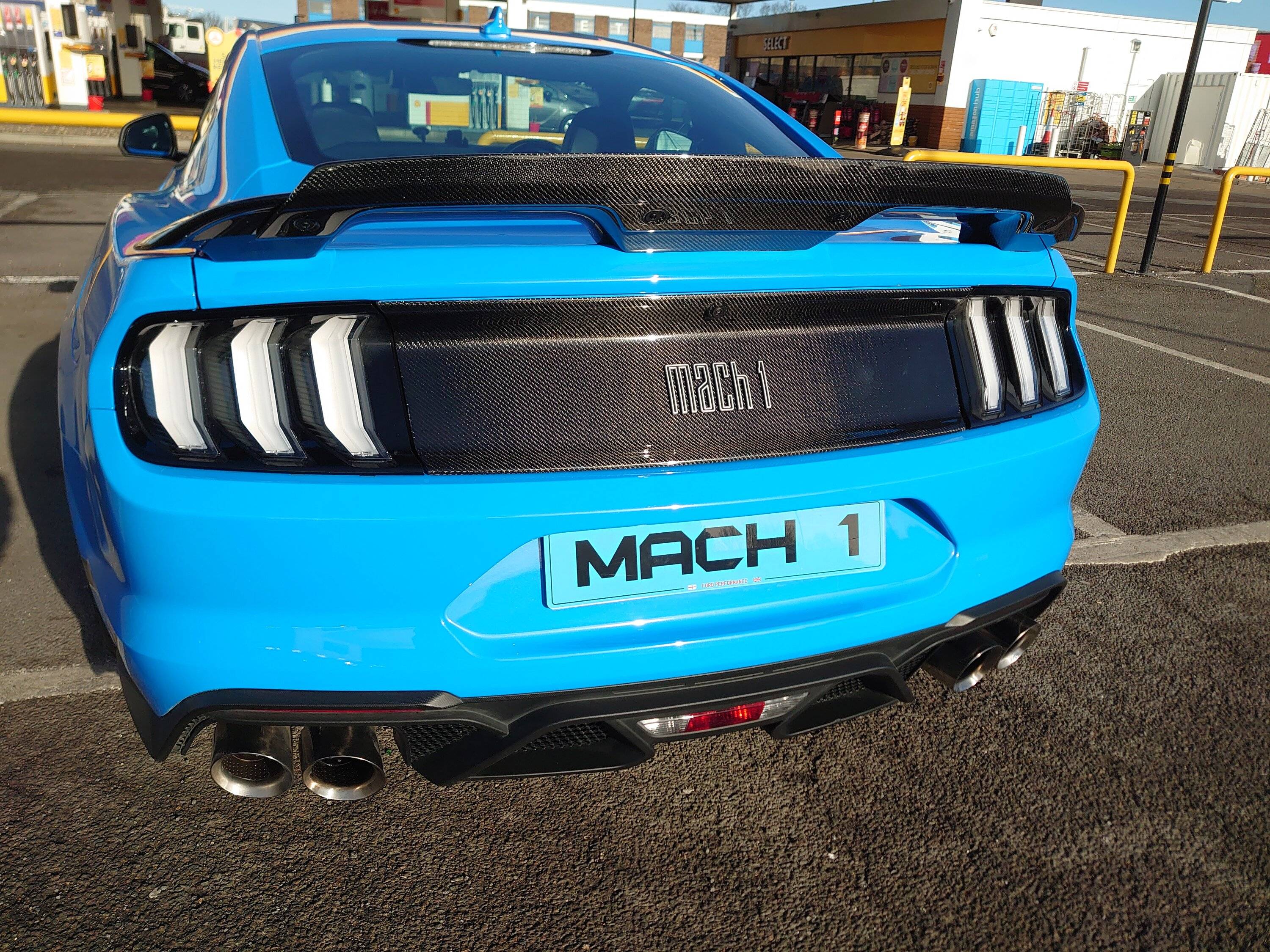

I added a carbon one...

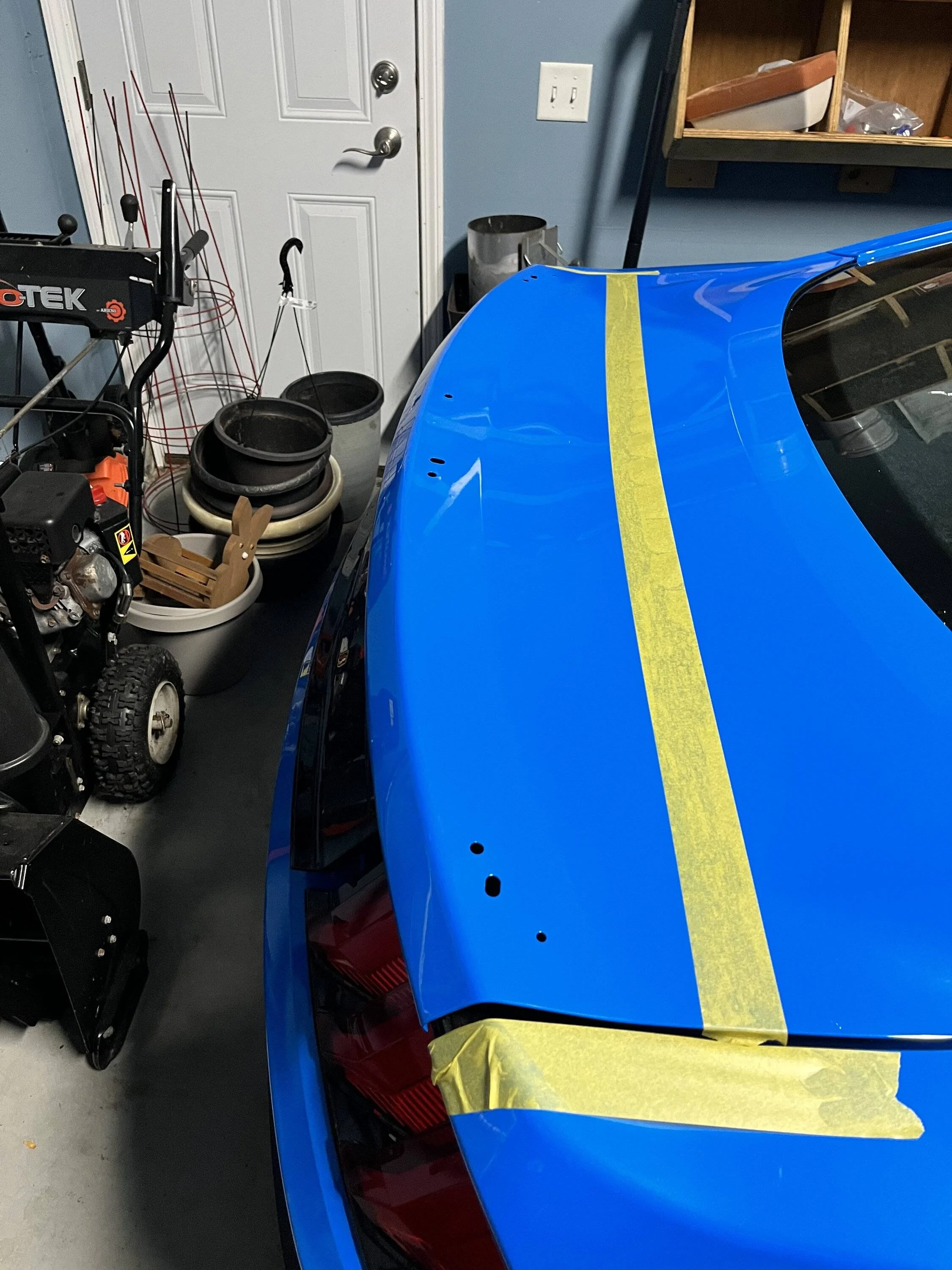

I don’t have a Mach but I assume the mounting holes are all the same. Didn’t have to drill any holes, the FP Swing uses all the existing. Here’s a pic of mine after I removed the lip spoiler so you can see all the different holes used.

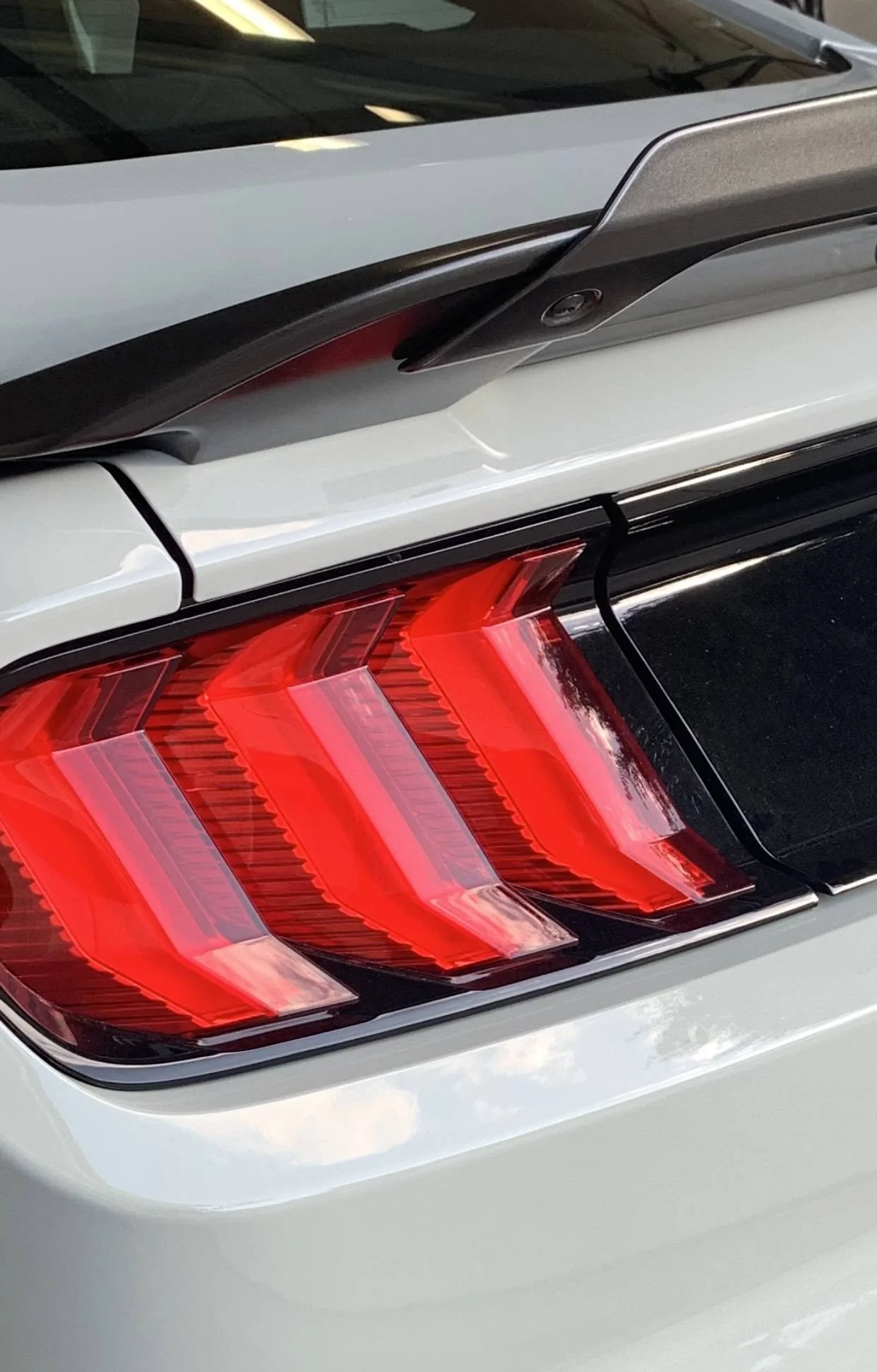

I know the one I am looking at is gloss black but am I correct to say the one that came on your HP is not gloss but a more matte look and not as shiny?
yes correct see pic below
