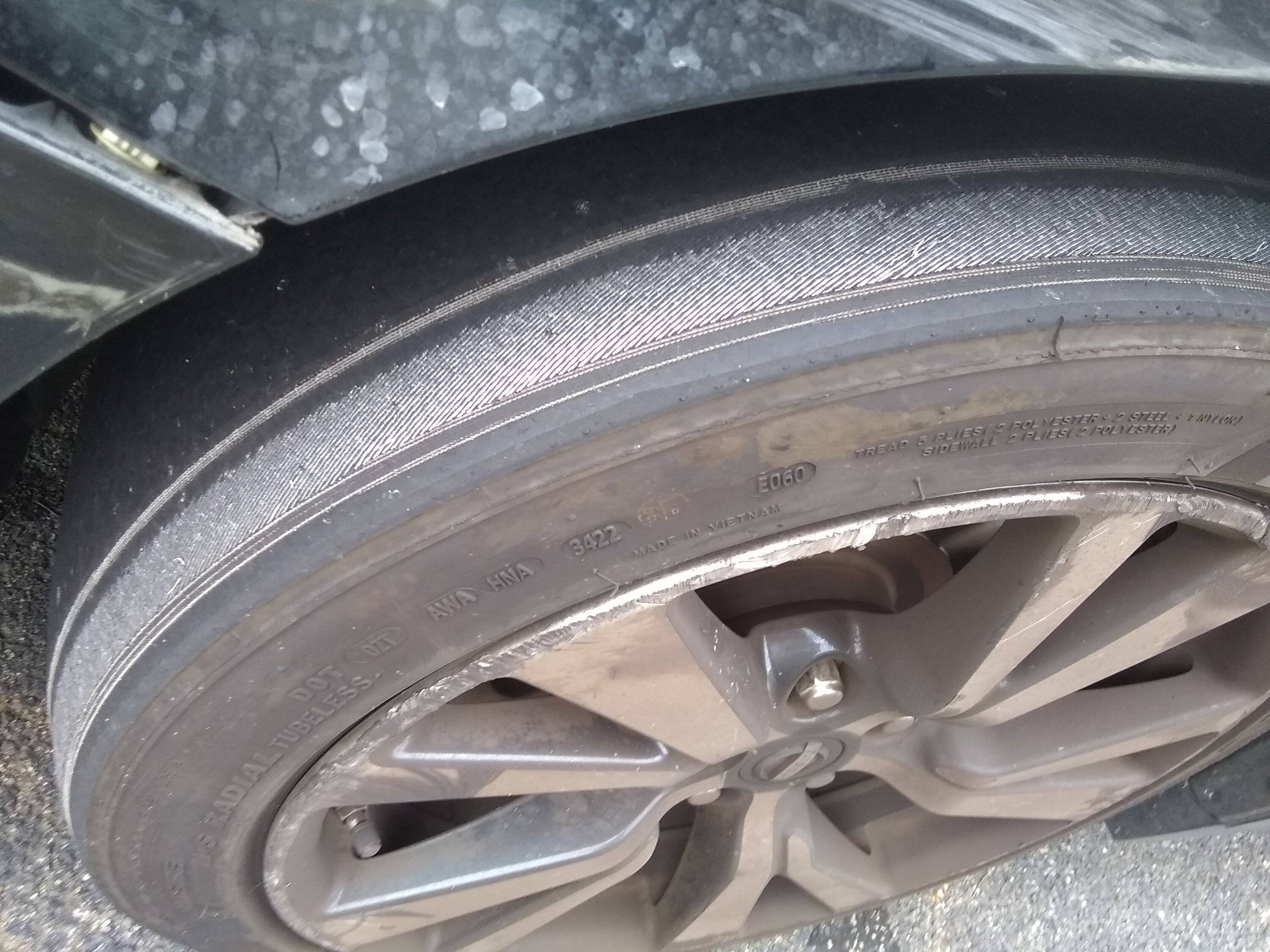

but last way more miles than summer tires.
Well yeah. But tires are intended to be worn out as fast as you can. It's a muscle car and heavy at that. Your supposed to be buying tires every year or so. If you want to buy tires every 10 years, buy a carolla or cuv.
We change politicians every 2 years, why shouldn't your tires be likewise? Please tell me you're not this guy.
Ps. Some statements may have been slightly exaggerated for effect.
