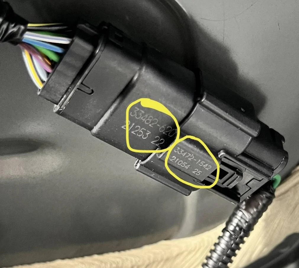

Image below is of the trunk connector showing the numbers that I’ll need for the harnesses.

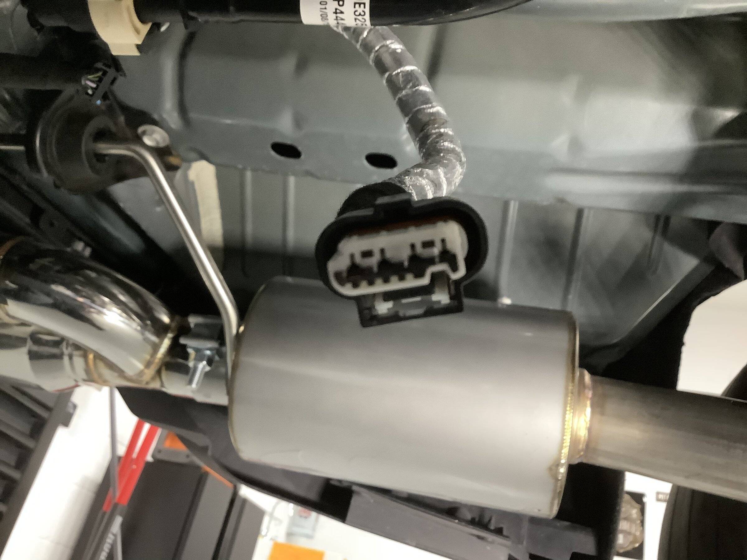

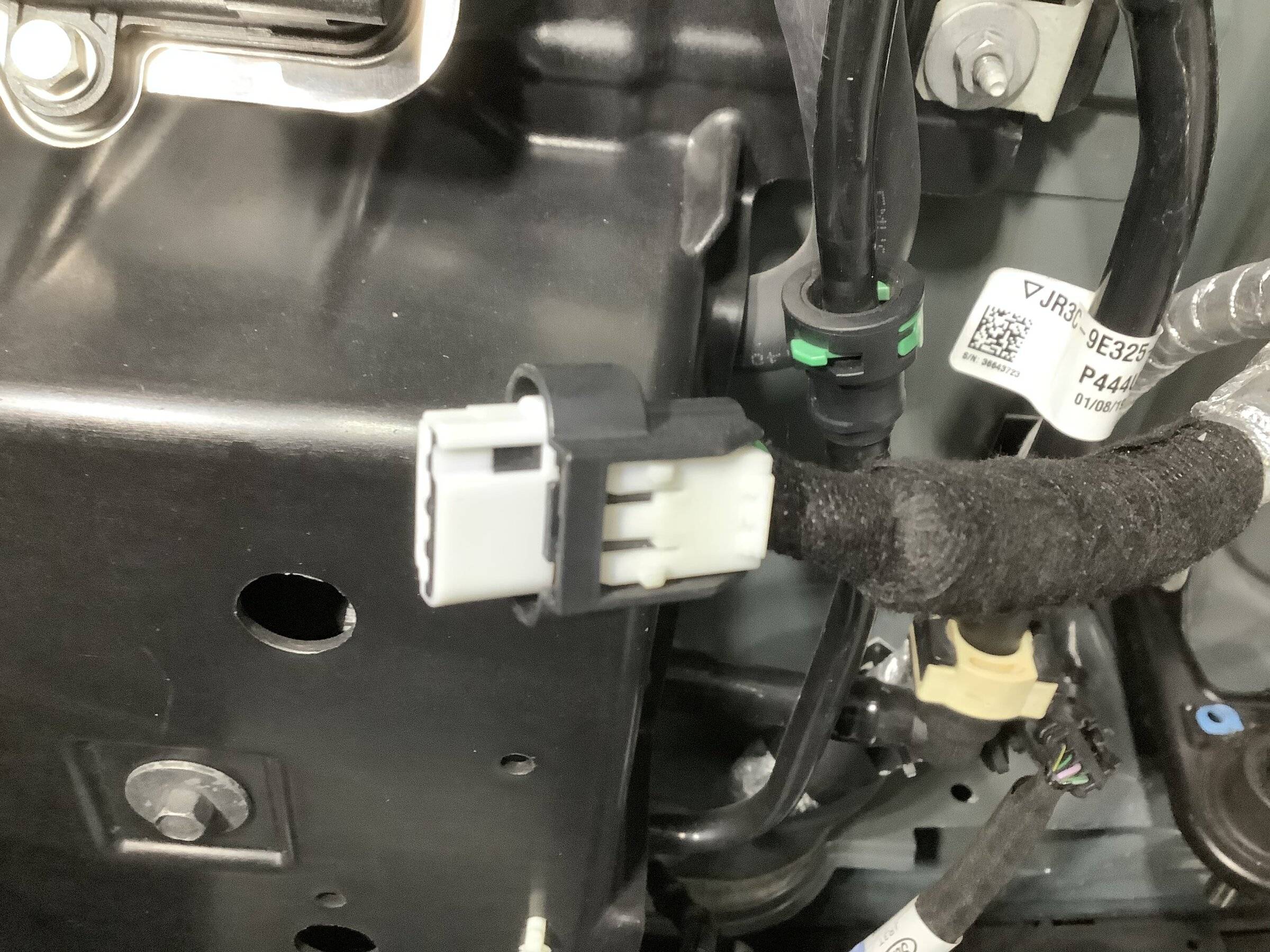

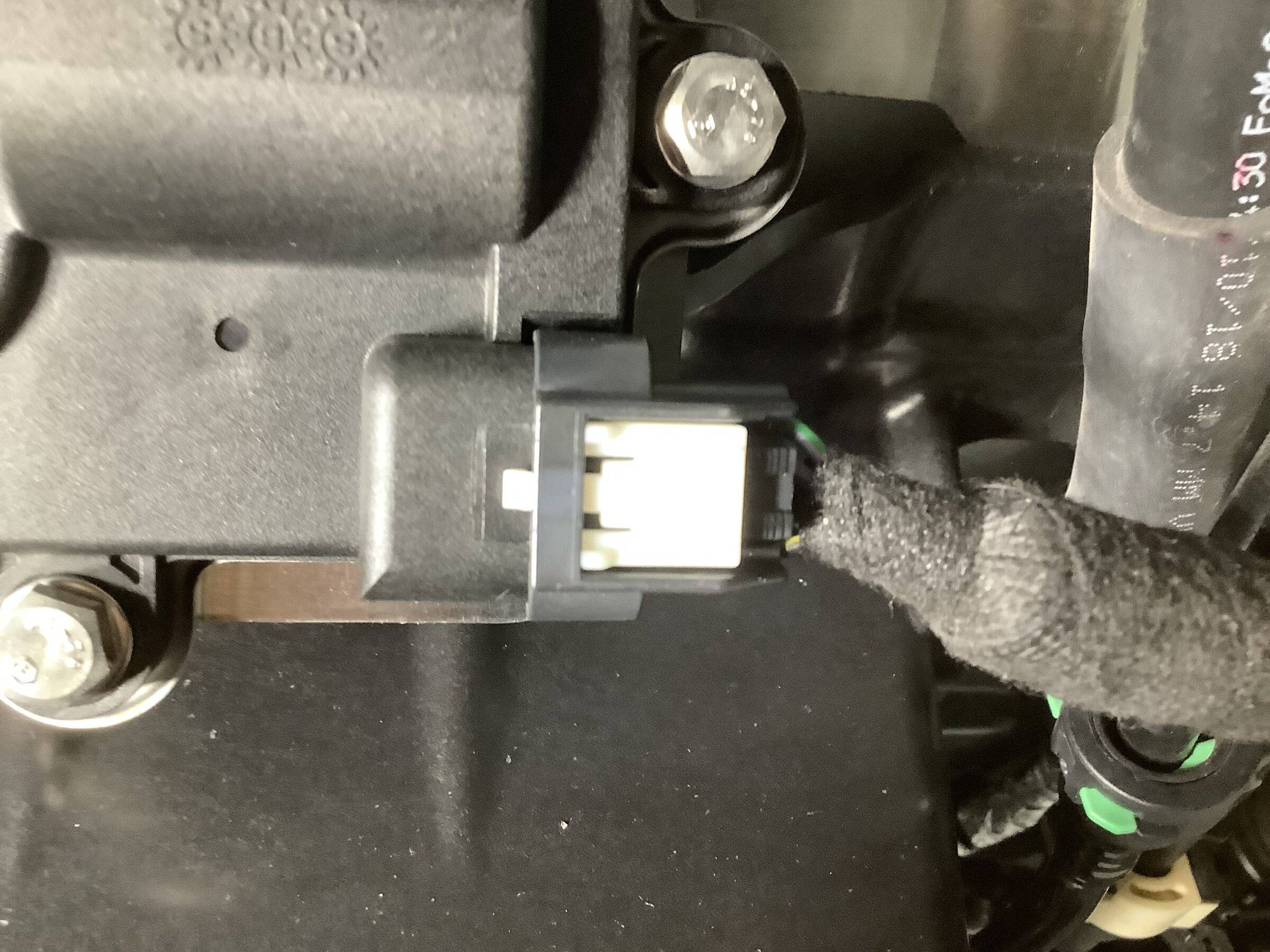

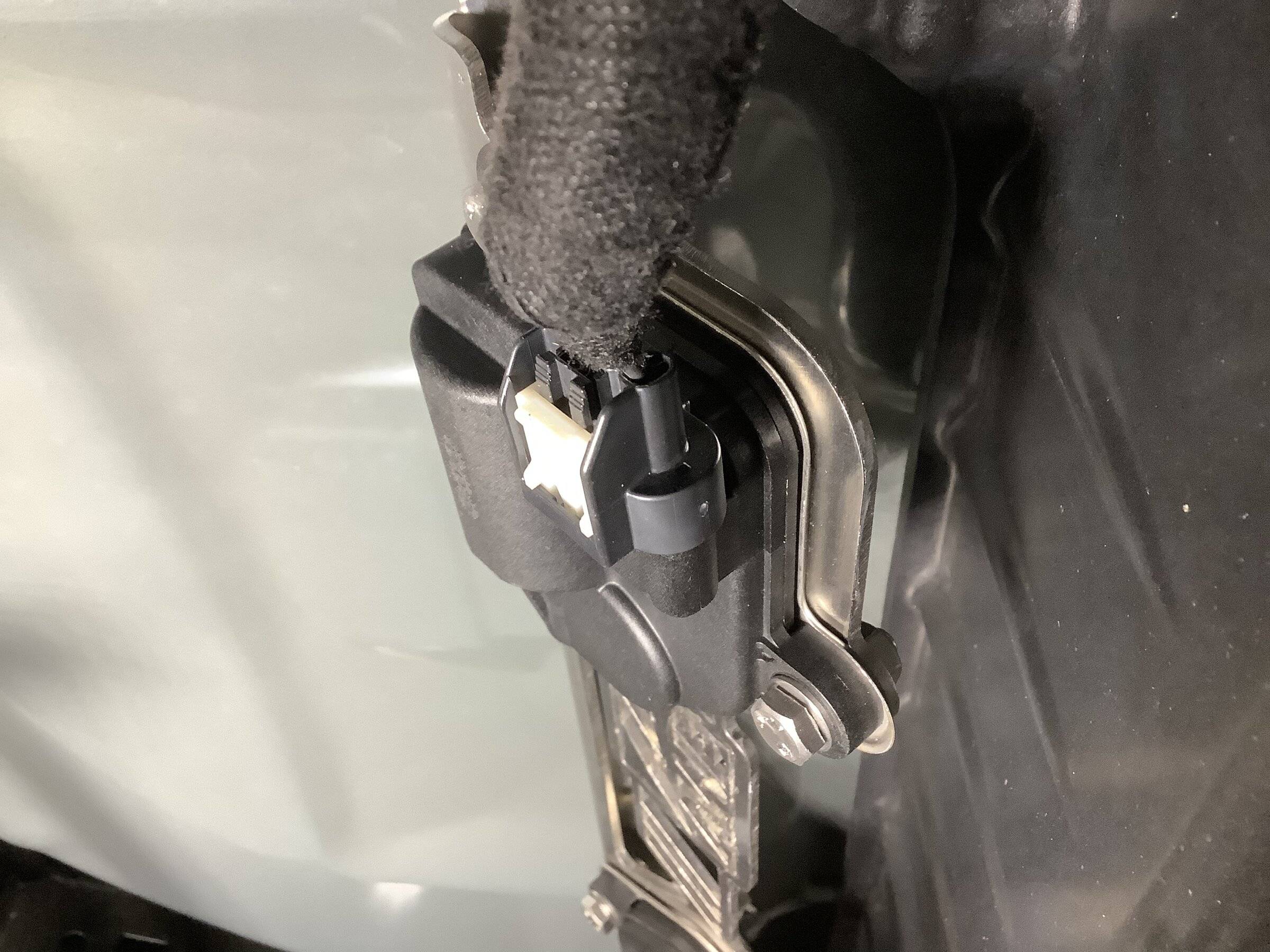

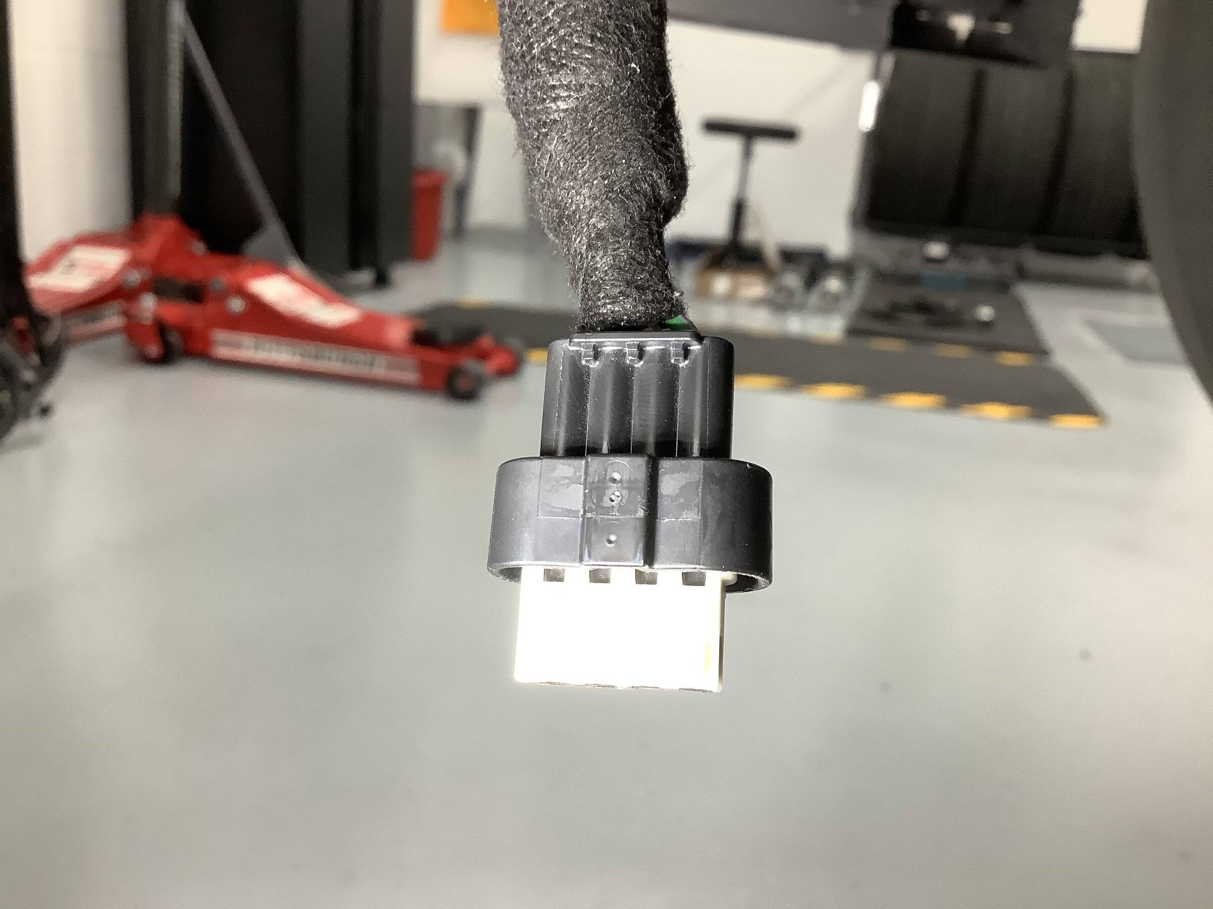

Not sure how high of a resolution pic you need, but I just went and snapped these for you with my iPad. Car is a 2019 Bullitt, but the harnesses are the same as the 2018 GT.

These are perfect thank you so much! Looks like there’s no molex number on the connector themselves but these pics will help me find the right one. Thank you again!
