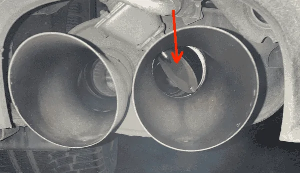

I recently purchased a 2021 grabber yellow manual 5.0 My stupid question is How do I know if I have a Active exhaust ?? What is it supposed to look like ? Looking in American muscle cat backs they all say w/o active or w/active mines look like stock muffler and no valve screwed on top of the quad tips .
Look inside the innermost tail pipes. If you see a valve, then you have the active exhaust.

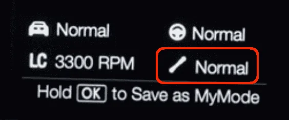

Or press the Pony button and see if there's an item called Exhaust Mode in the menu. If there is, then you have the active exhaust.
Then, in the same menu, go to MyMode, Show Status, and see if a setting for the suspension is displayed (it has an icon that looks like a damper). If it is, then you have the Magneride.

Check the window sticker and or look for the exhaust flaps. I made sure my 2020 had that option and Im 100% satisfied with it. Paired with the active Borla Atak my car sounds like fucking Godzilla on start up haha.

So I don’t have it ,But I am now thinking of deleting the resonator but will that void my factory warranty?
