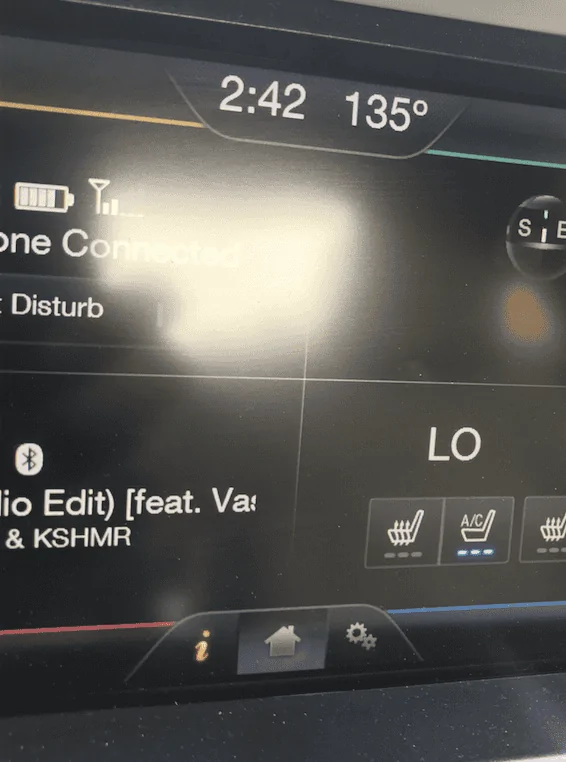

May I join the party? :doh:
AC went out a few days ago while heading home from work and the outside temperature was around 125 F. I almost melted on the seat. For reference, the car milage is around 17K.
I'm glad this did not happen a couple weeks ago when the temp was...
