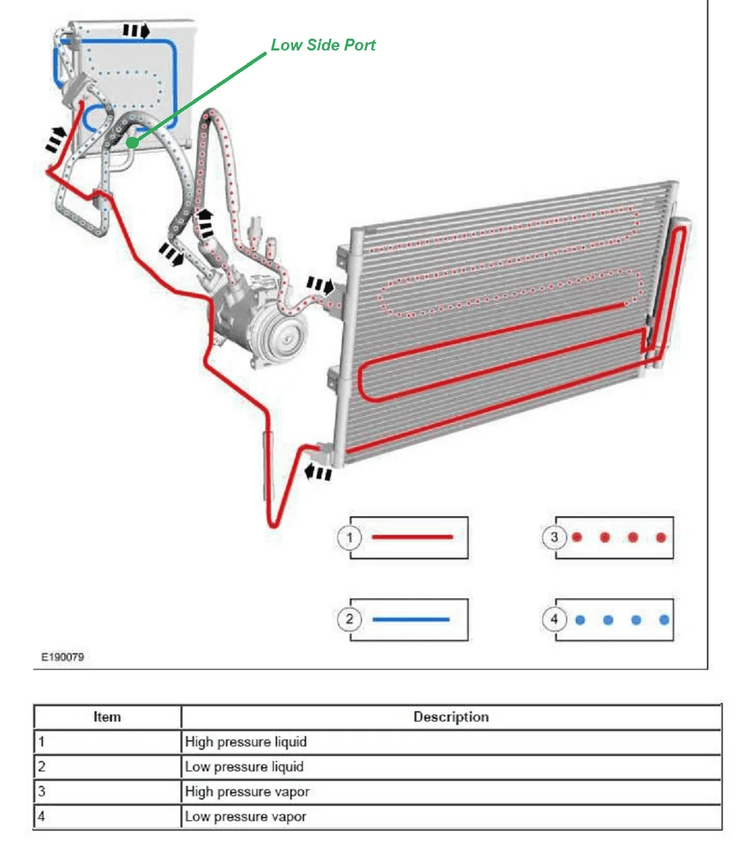

Any idea where the high pressure port is on a GT? I can't see it in my car, so figure something is blocking my view. Am trying to hook up manifold gauges to both high and low. Been searching the web and this forum plus the factory service manual but no pics of where it is. A zillion pics and videos for the low side for people only wanting to add freon.

Not 100% sure, but looks like it could be on that stinger tube coming off the low side line. See attached. Let us know if that's indeed where it is.

The high port is right above the compressor in that pic. In reality it is above but forward of the compressor. I had been looking for it between the compressor and the firewall like the low side was. Doh!
