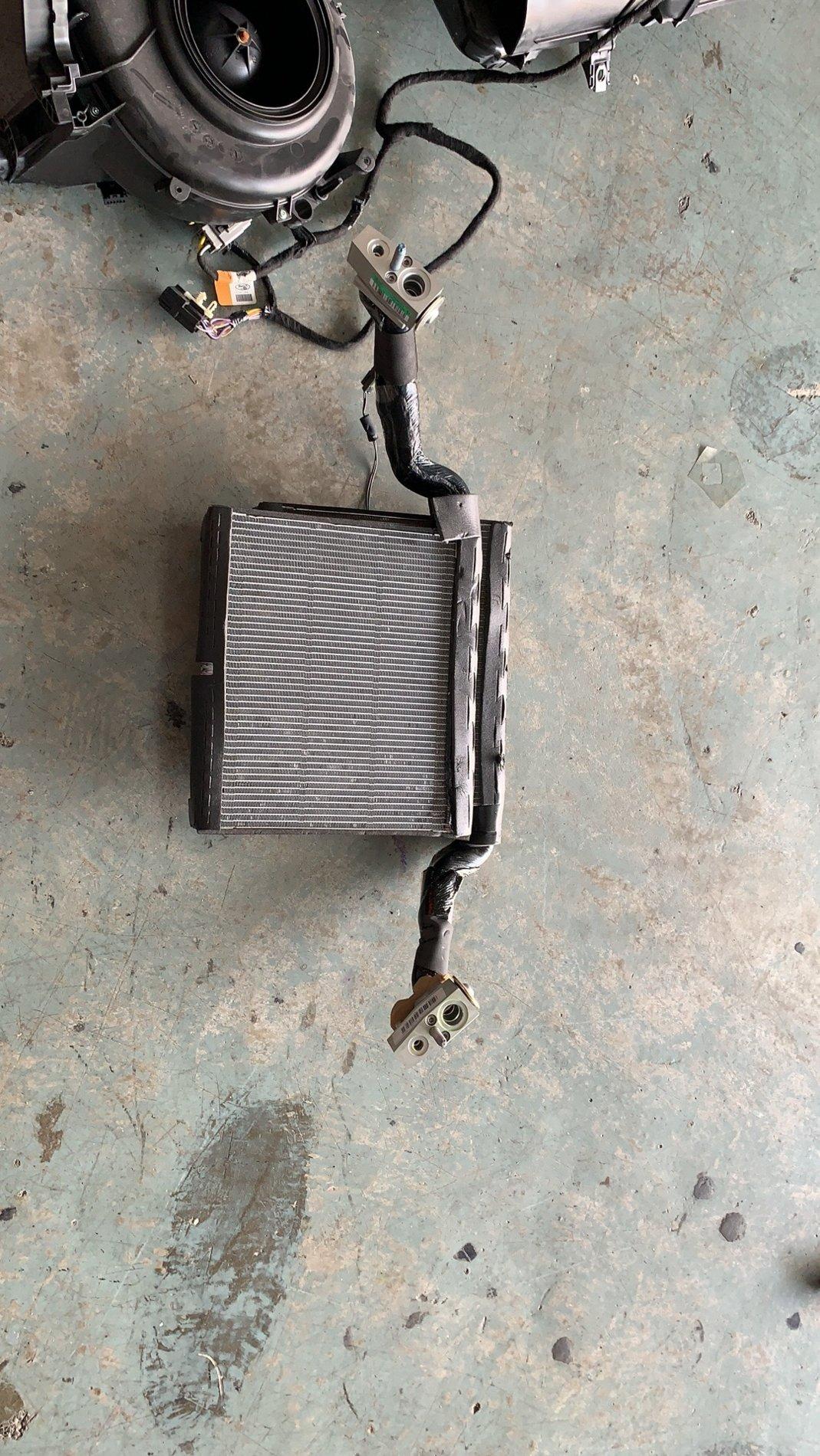

Your car was RHD, I do own a 2016 Mustang at Malaysia. A/C evaporator leak. From what I know, Ford US, do offer only evaporator change for LHD mustang, this I order base on the bulletin part number. But the evaporator was unable to use at RHD mustangs. Piping direction different. Do you know the RHD mustang evaporator from Ford?
Below was the evaporator picture, top was FR3Z-19860-A, for LHD, below was original from my car, for RHD (not part number indicator on the evaporator)
