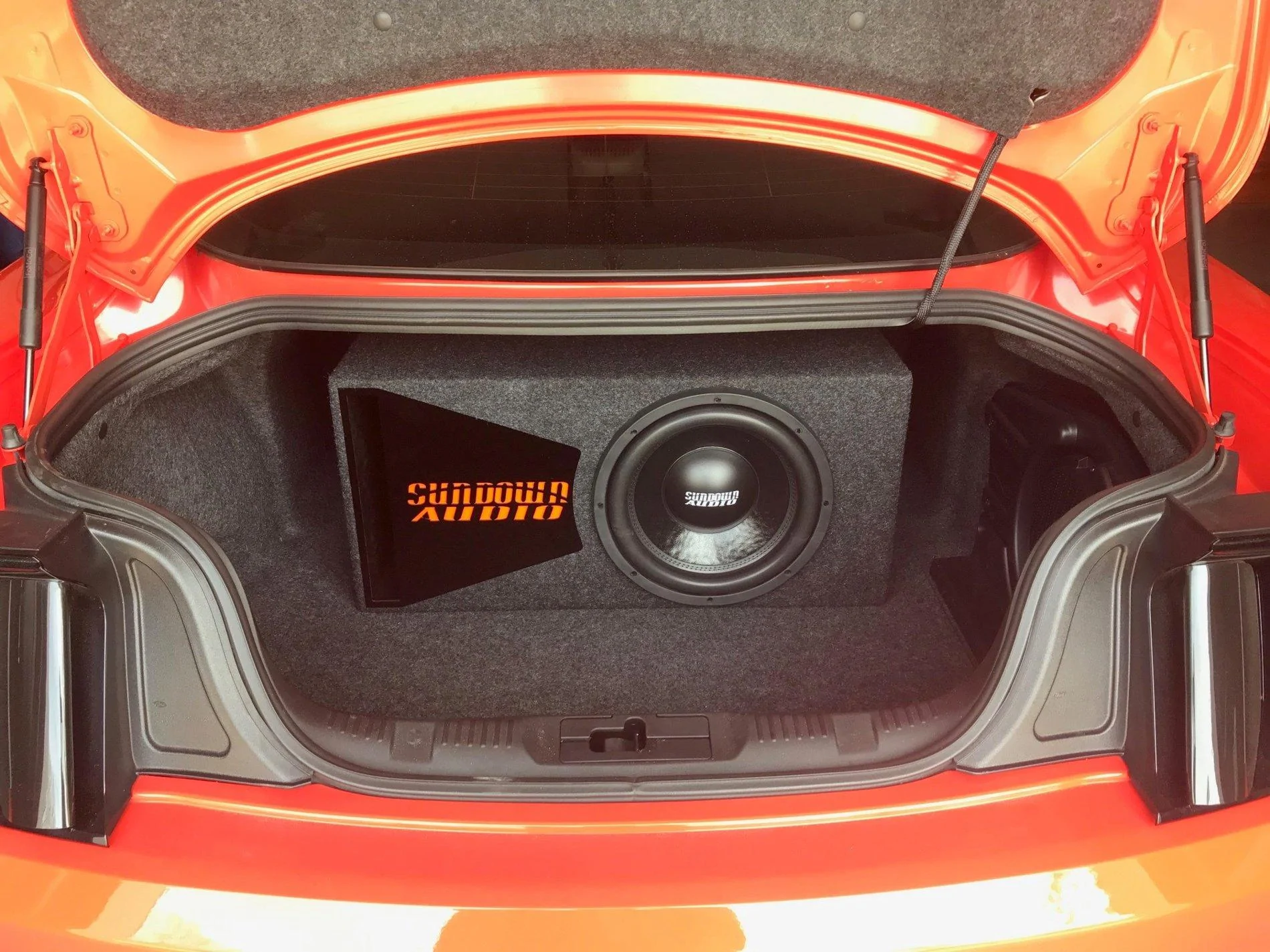

I'd honestly spend a little more and get better speakers. I'm very happy with my 2 sets of JL Audio C3 Comps paired with a JL Audio 400 amp. I've paired that system with two 10" Sundown subs and a RF 1000D amp and a Audio Control LC7i. My Mustang has a 12" Sundown and a JL Audio 1000 amp but I have yet to do the mids/high/amp yet. I'll either stay with JL or go Hertz.
