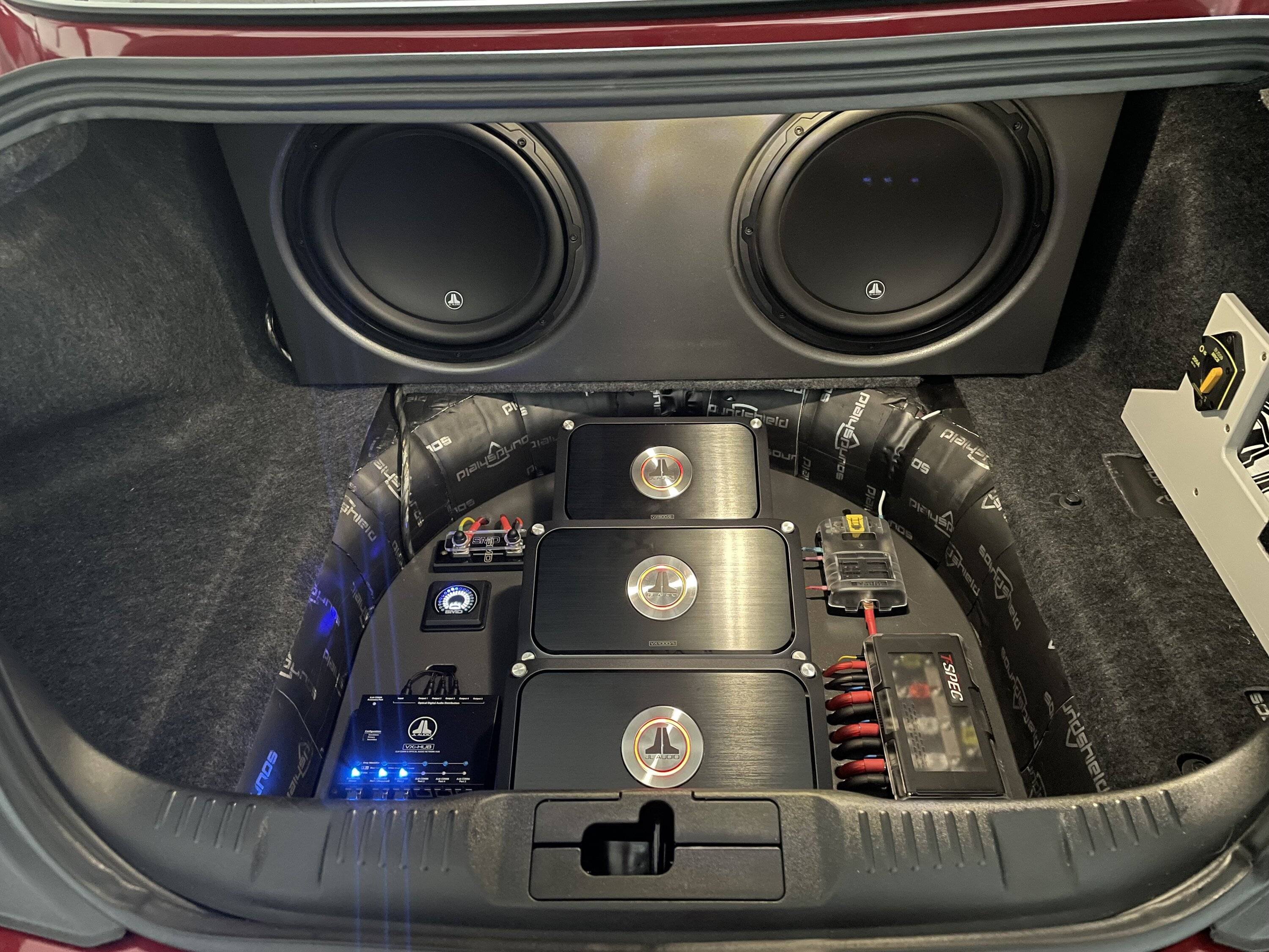

I installed a full JL system in my car with C7 components up front and C5 coax in the rear.
Dude this is nice. You are obviously a person who truly appreciates good sound and a nice system, very well done. For anyone looking at this, this is what a high end system is.
