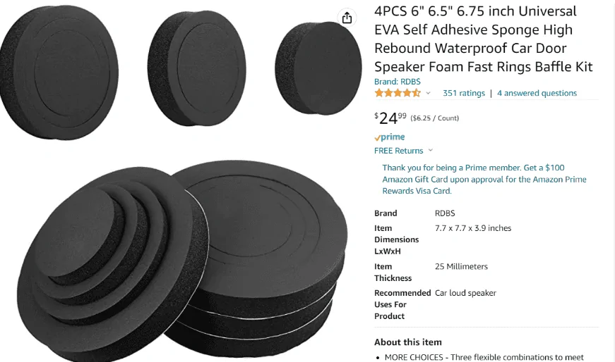

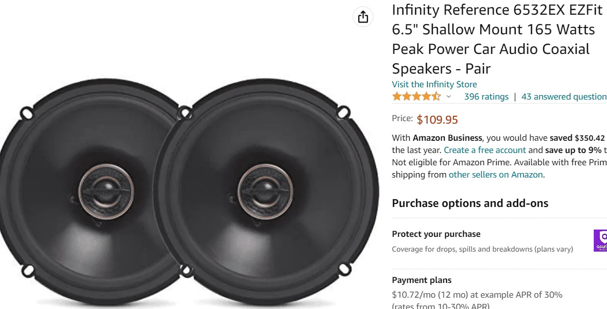

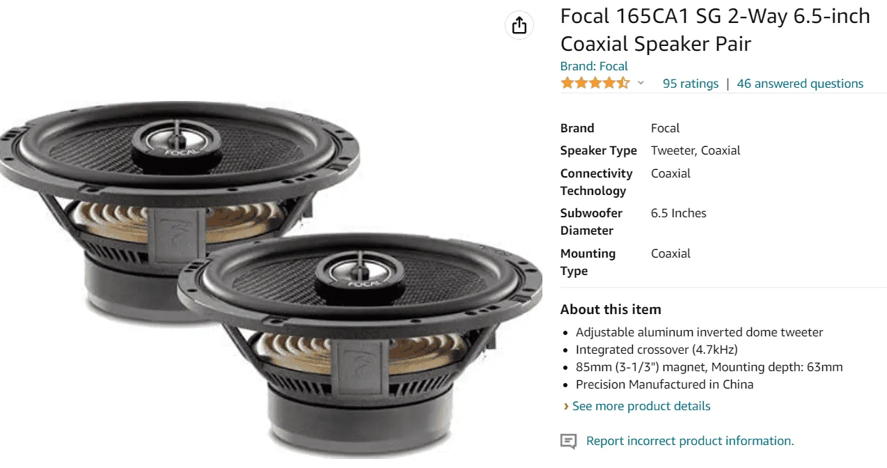

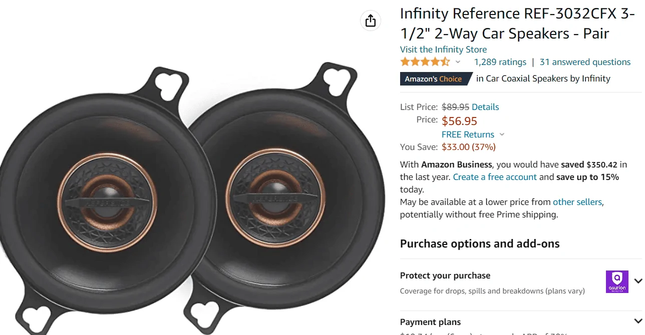

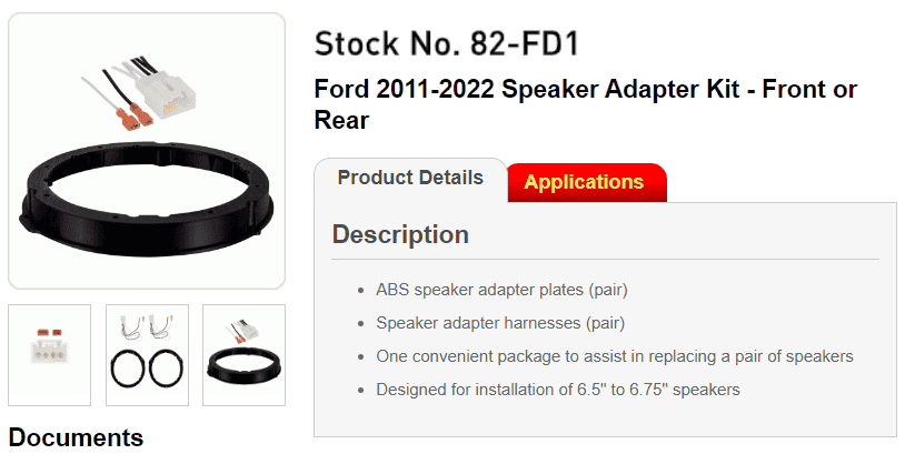

Hey Doug, do you mind telling me what speakers you bought and anything else to keep in mind? I'm trying to replicate what you did.
Due to my Mustang being a Performance vehicle and not a Luxury vehicle I didn't
go to crazy with my speaker selection. They work nice.
NOTES:
1: Disconnecting the front Center Dash Speaker Hands down made a Huge difference in sound quality at high volumes.
2: Punching holes in the rear deck panel to allow the air flow/sound from each rear deck speaker to come through unobstructed from my rear deck panel, made a Huge difference in the sound you hear coming from the rear deck speakers.
Good Luck
3: If you use the 3-1/2 Infinities, you will have to trim the door panel some to clear the speaker connectors, fit proper or solder the wires onto the speakers. So research your speakers to see which way you want to go with the 3-1/2. I am sure they have ones which do not require trimming but I just went on and trimmed and then applied rust preventative metal coating to the bare areas I trimmed.
4: I also install a custom enclosure which fits perfectly in the trunk forward space which has dual 12" Dual voice coil, Comp Speakers and 1200watt amp it was way to overboard.
BUT: This was absolutely way, way to much bass for me so I am going to remove and install the JL Single 12" Bass woofer enclosure.
Good Luck
