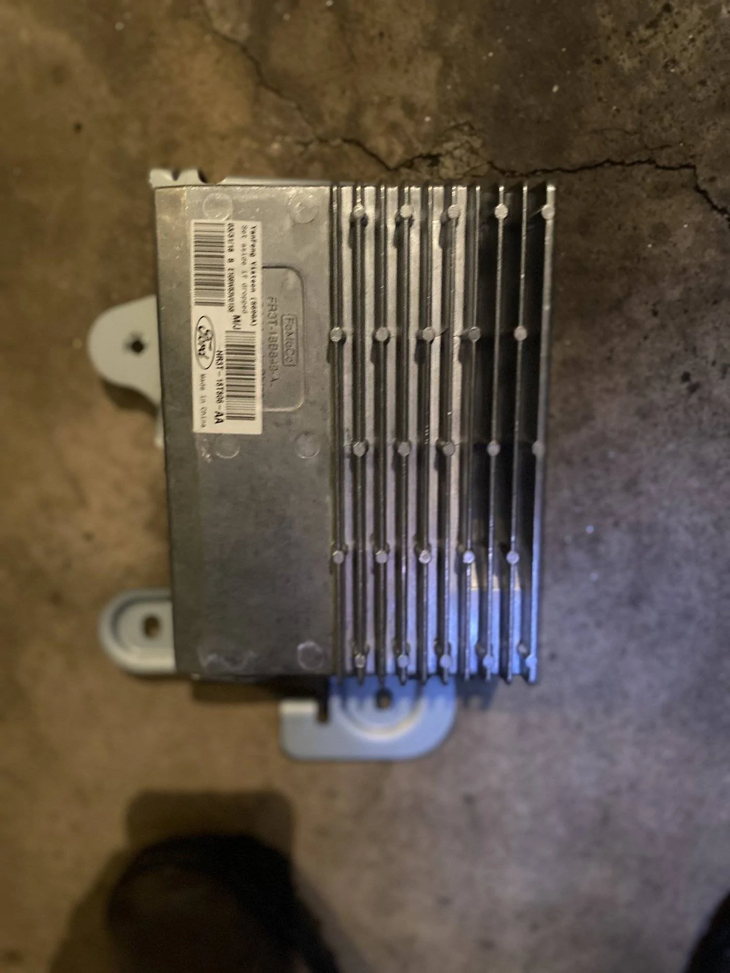

My original thought was to remove the factory amp and put the DS1 there. I got the two bottom bolts of the factory amp plate off but it’s bolted somewhere else and I can’t seem to easily find where..
Any tips removing the factory amp? Any tips or tricks? I can easily mount the DSR1 nearby but it won’t be as clean.

Got it out but that sucked... But perfect mounting spot for the DSR1.

Oh and future reference the bottom bolts on the factory amp were 1/4” and the top one on the left was 5/16. Once you get all the bolts out you have to really finesse it out. It’s a super tight fit but just be patient. I had to use a small ratchet with an extender.
I’m going to use industrial strength Velcro for the DSR1. Or some 3M double sided tape. And maybe a screw, but not even sure I can get a screw driver in there.

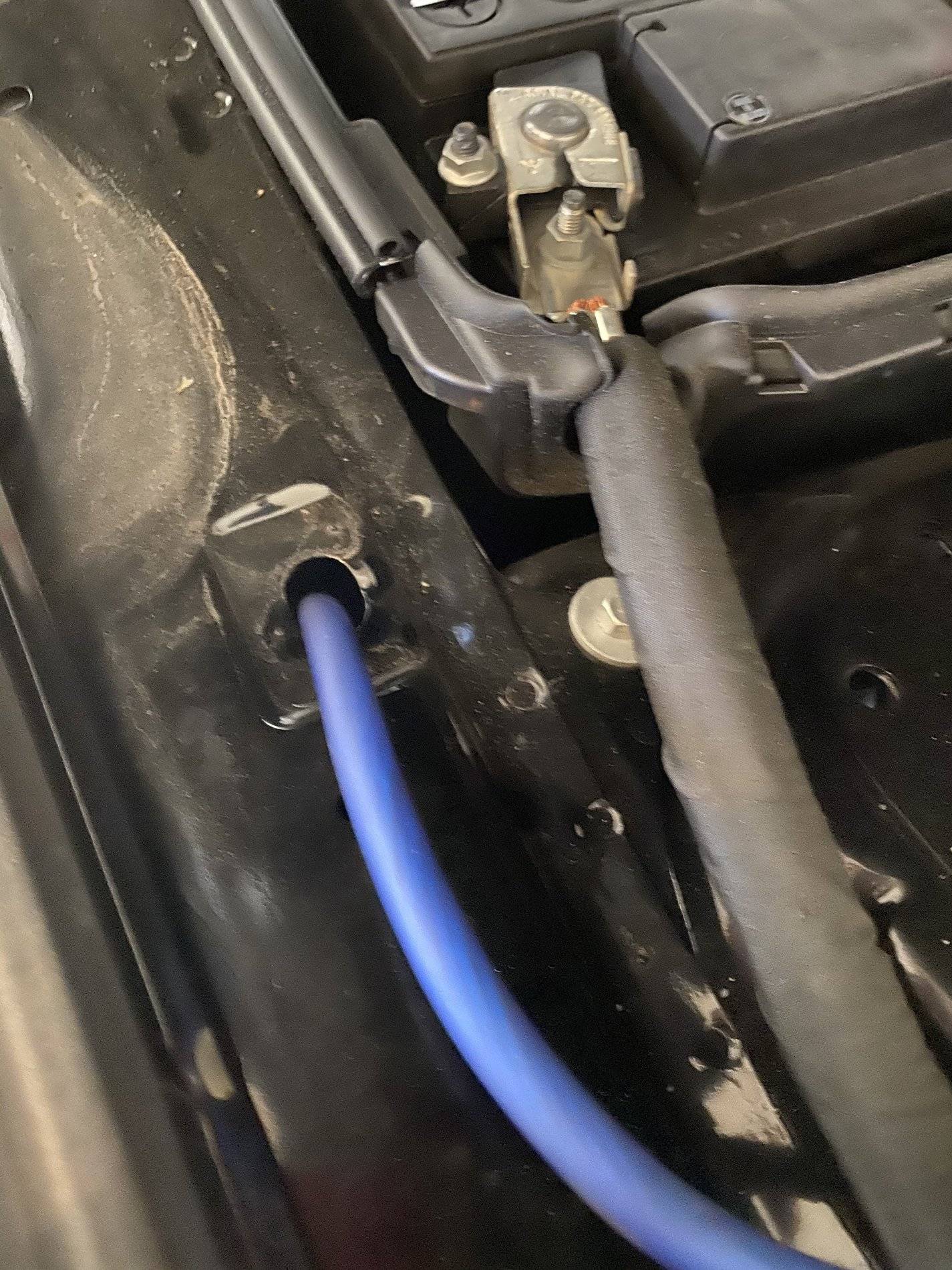

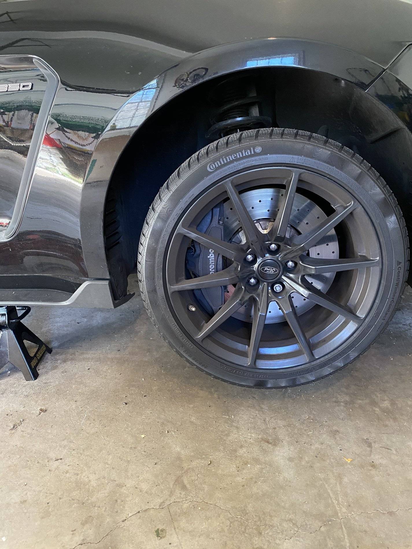

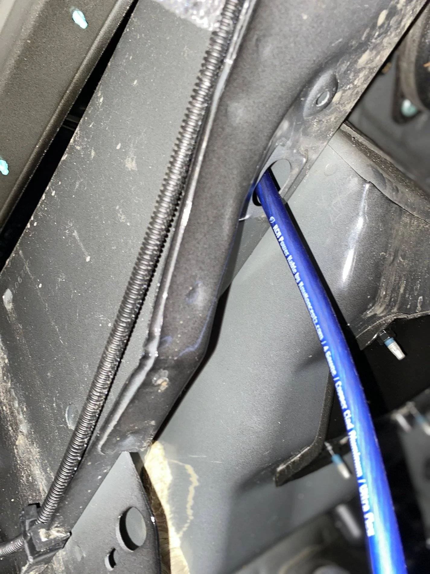

Made some good progress today. Was able to run the main power cable. I can’t fully connect it yet as I am waiting on a 0-8 gauge crimper. But the wire was run. It’s pretty easy, I had to remove the front side passenger wheel so I could access the fender liner. From there you just cut a small slit in a rubber boot and pull your cable through.
I ran the wire up through the top (there is a factory hole you can access from the removed fender liner and it places the cable right near the battery). I did destroy one push pin (I had to pull like 8 of them), but overall it’s a straightforward job. Some pictures below.

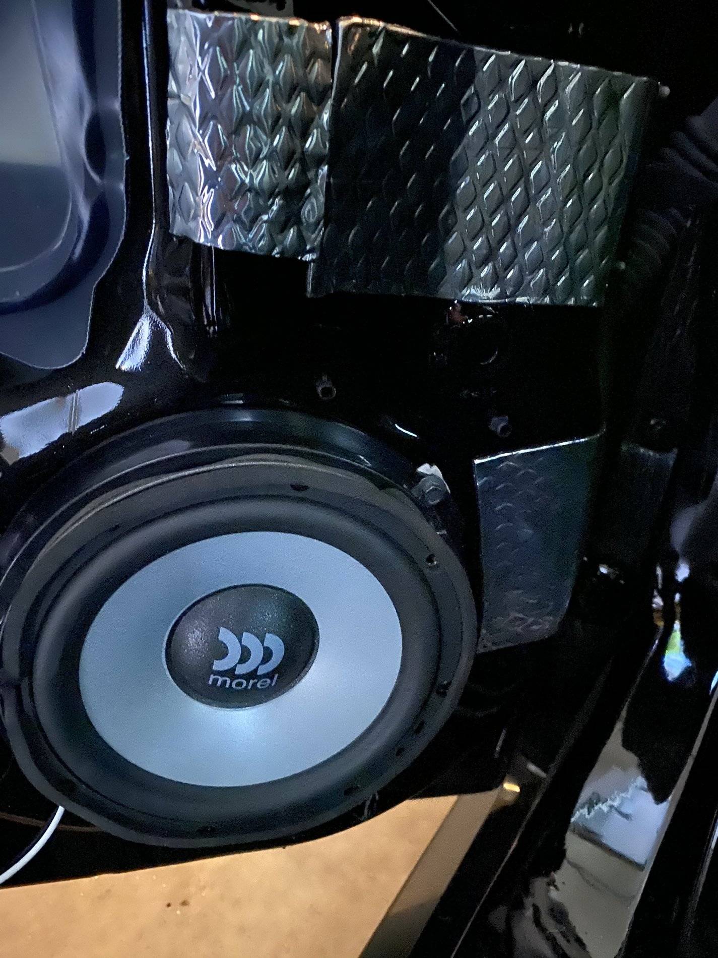

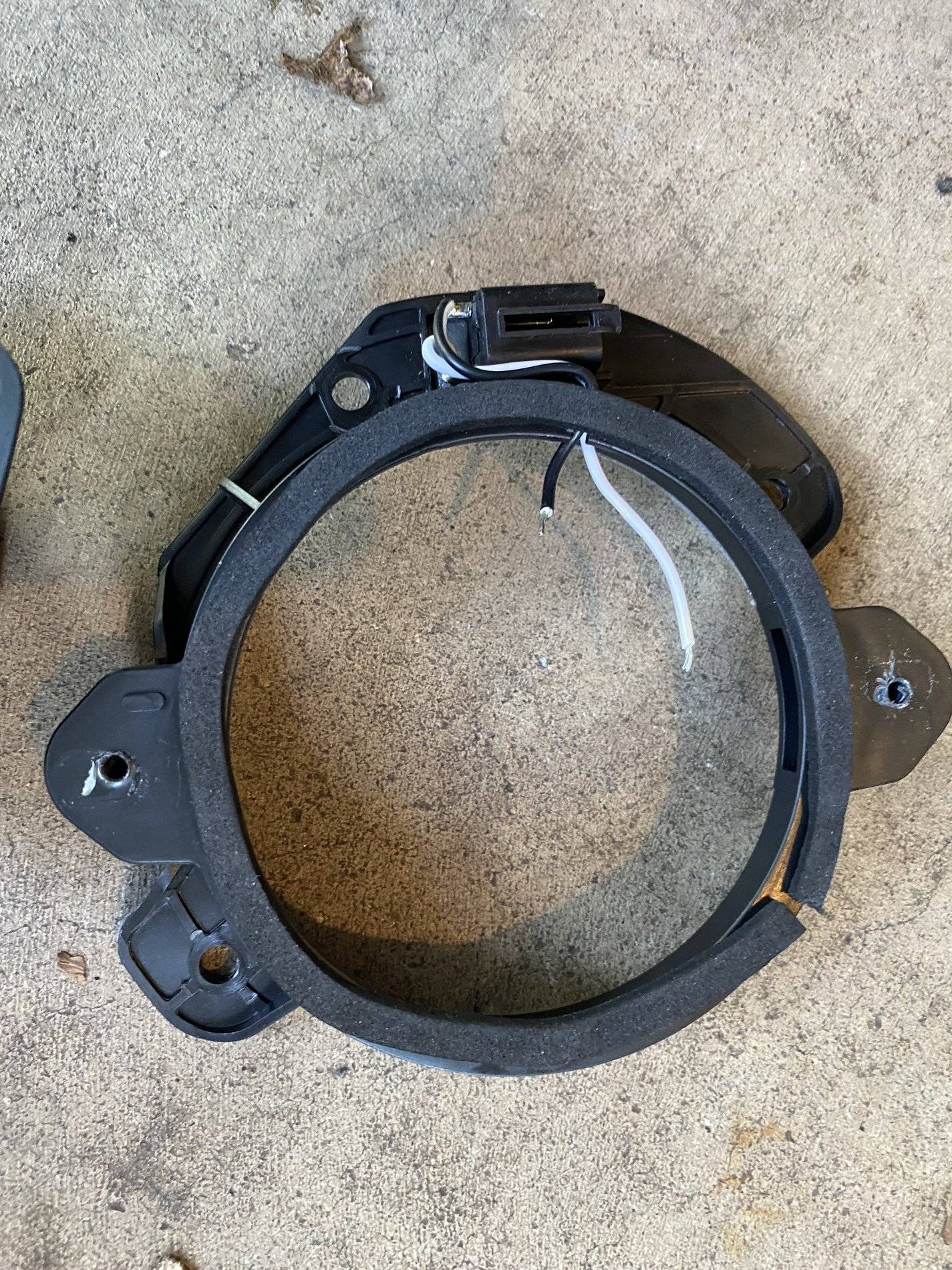

Next I took the front driver door panel off. Man, that was not as easy as I thought. I had one cable that would not release even when pushing in both release tabs. I ended up having to pull some wire grommets so I could move the panel far enough to the side. Also the door release cable (not sure what to call it) is a huge PITA. Had to watch a few videos on how to remove it. Took way longer than I thought but the passenger side will be much easier now tomorrow.

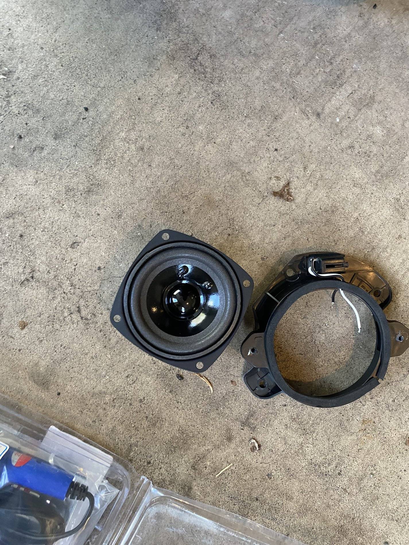

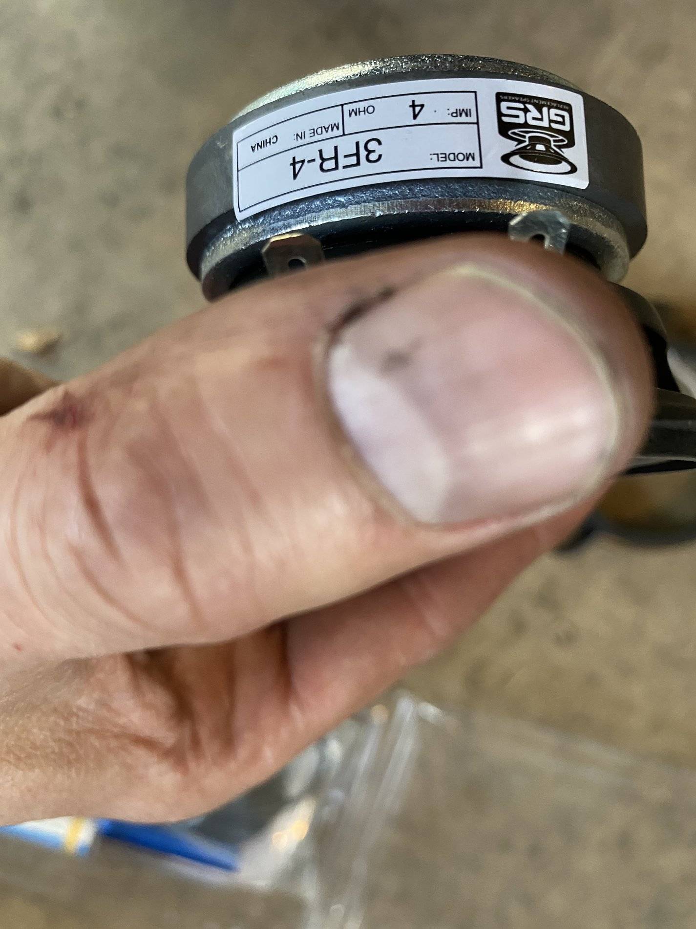

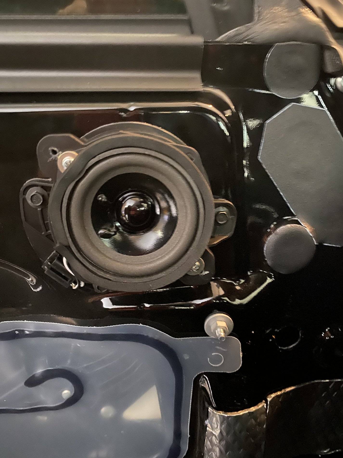

For the good news the midrange 3.5” speaker replacement from Parts Express was the perfect size. There is not much depth for this speaker and I was able to use the stock trim and factory harness with zero modification. Very happy about that. I just had to solder the new wires to the harness but it was straightforward, See pics.
I love Crutchfield. With my Morel components they shipped me the Metra harness that connects to the factory harness and new brackets/spacers. I did have to do some minor mods to the new spacer but it all worked out perfect. I don’t want to add a ton of weight, but I did add some sound deadening to the inside panels for both woofer and midrange, and I also added some to other areas of the door. I did add more after I took pictures. But I’m not covering the whole door. I also used foam to the front and back baffles for all the speakers. I went ahead and put the front door mostly back together but I’m confident everything was wired correctly and I did check polarity.

I’m a bit concerned that you have the power wire going through bare metal holes. Are you planning on adding any protection for the wires in these spots to prevent the wire from having it’s casing rubbed/cut through and grounding out? Also, do you have a fuse on the power wire within 18” of the battery just in case of a short? Other than that, it’s looking good!
