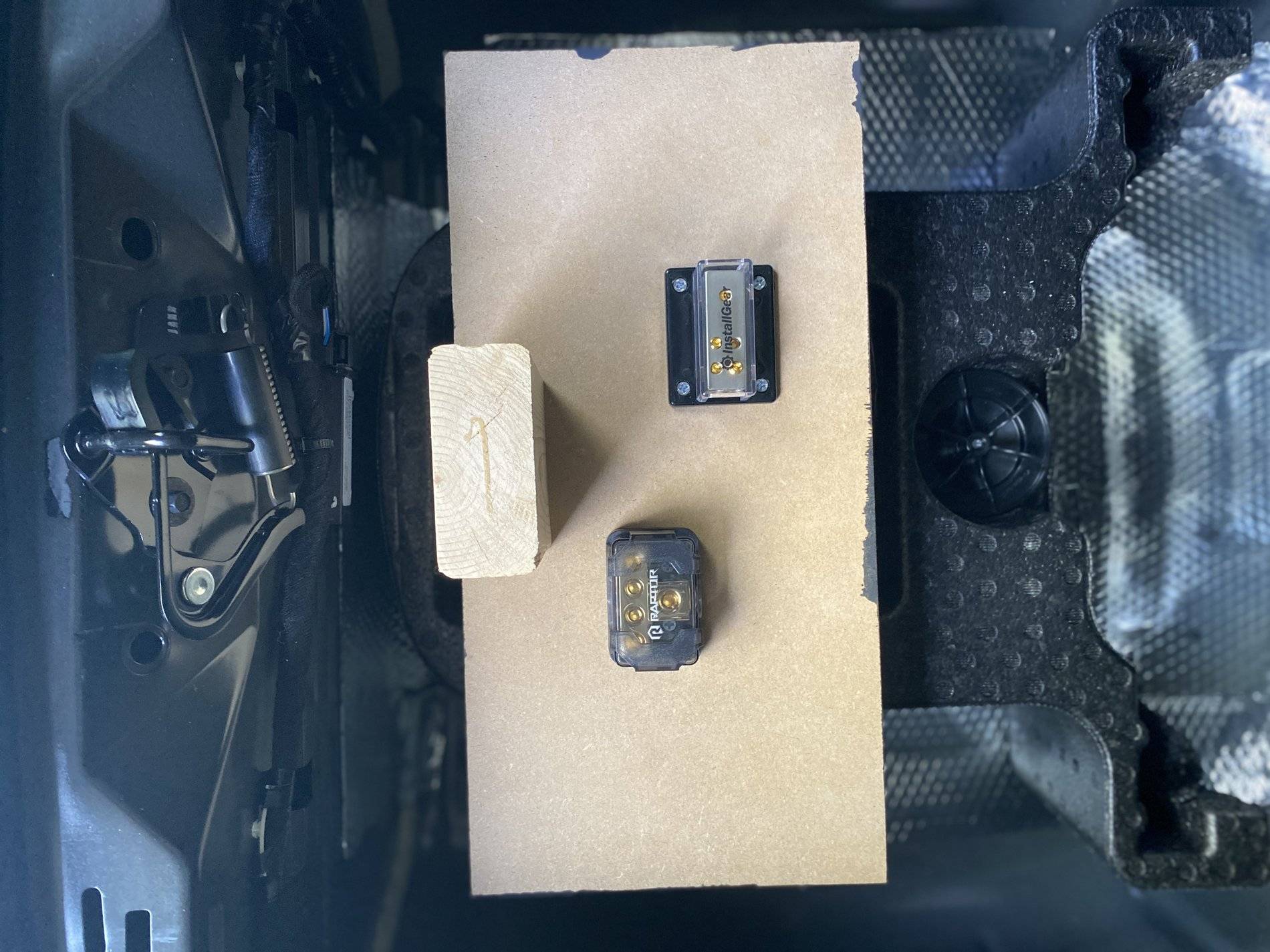

I’m a bit concerned that you have the power wire going through bare metal holes. Are you planning on adding any protection for the wires in these spots to prevent the wire from having it’s casing rubbed/cut through and grounding out? Also, do you have a fuse on the power wire within 18” of the battery just in case of a short? Other than that, it’s looking good!
Yes! Good catch and thanks for the feedback. I do have a protective plastic sleeve, it got delayed from Amazon but I will install it from near the battery through the metal. I also will use zipties where appropriate to keep the wires from moving around.
I am planning to attach the fuse holder on the outside of the plastic battery box. I estimate about a 10-12” connection want to keep it closer to 10”.

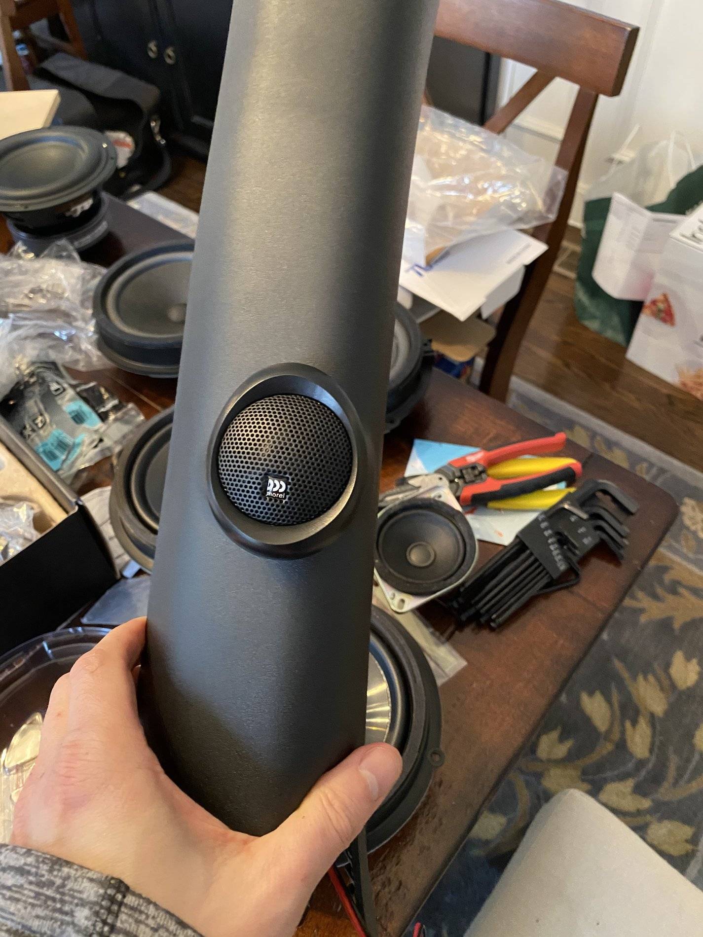

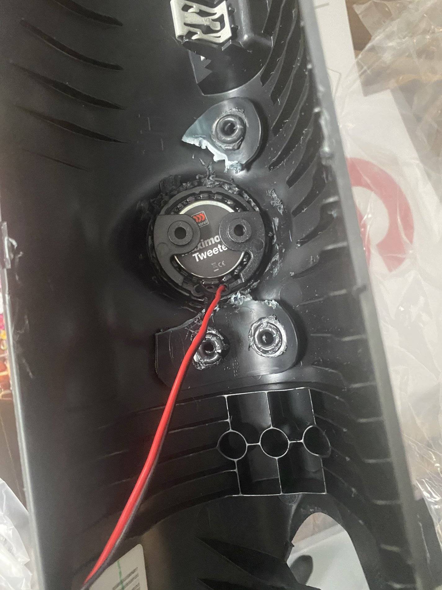

I was able to get both the a-pillar tweeters installed. Just a little Dremelimg needed. Added some silicone and the tweeters are locked in place. I also was able to remove the rear deck speakers and am about 70% done sound deadening the rear deck area. Tomorrow I will finish sound deadening the trunk area and start putting together the amp rack and wiring it up. Work has been busier than ever so finding time is scarce.

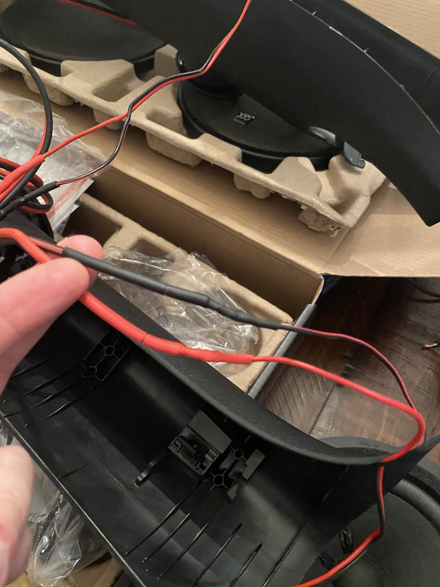

More work done. I got my speed wire and other wires all connected to the Maestro harnesses. I soldered and wrapped all the connections. Also wired up both the a-pillars and soldered and heat shrinked those.

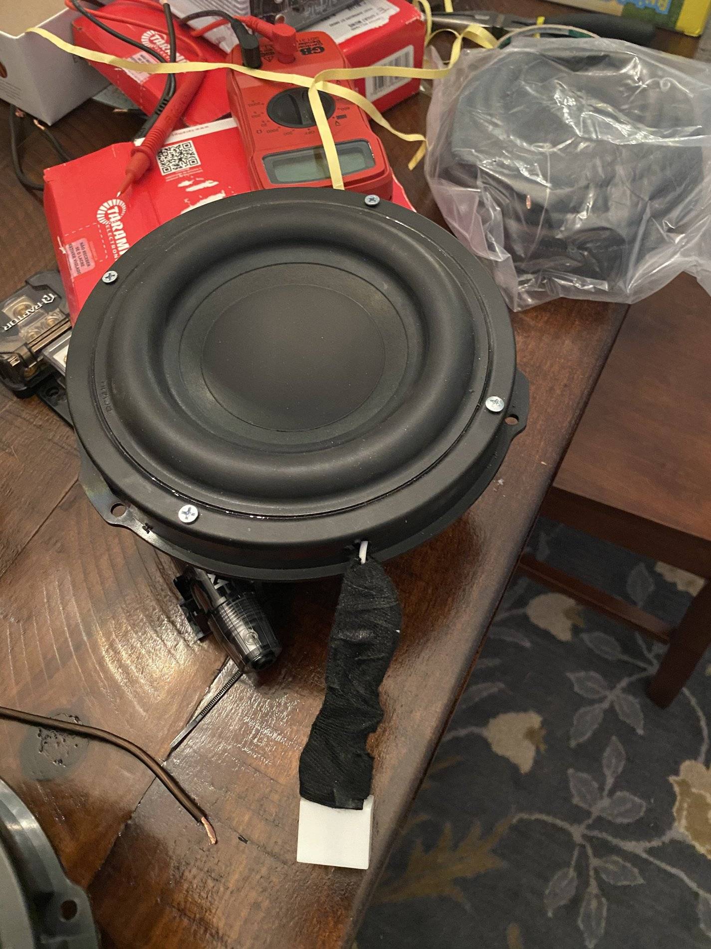

Have the dual 6.5” subs ready to go. I used Metra adapters and harnesses so no splicing and a perfect fit. Zip tied and wrapped the connectors in Tessa tape. Have all the sound deadening installed and the amp rack is cut and painted.

Me too. I did find a number of people who have done this and said they did not have issues. But one or two said they did have rattles. This is why I am using zipties and Tessa tape. I don't expect any plastic to metal contract on anything in the trunk, and I did use sound deadening liberally on the rear deck and trunk area.
If there is too much rattle, I will just pull them out and buy an integrated sub box and call it a day. But I am not a huge bass head for my car, I want some, but am hoping the new Morel speakers really improve the mid range and midbass.

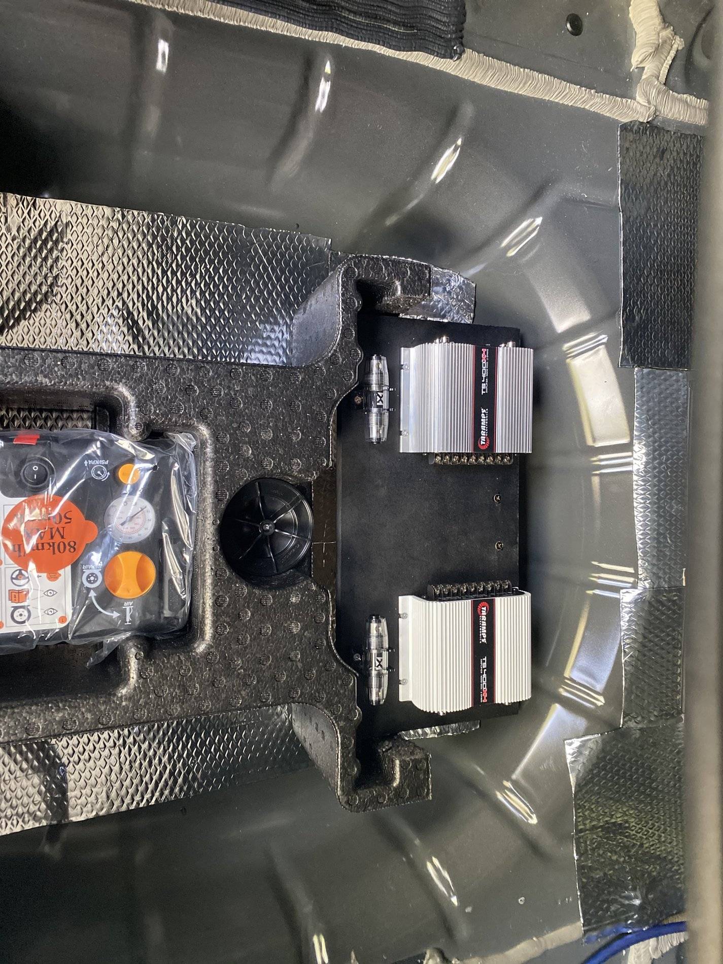

Installed the subs in the rear deck and started on the amp board. I found a good location. All the harnesses and wires are ready, so tomorrow the target goal is to get everything installed, and dialed in. Then put the car back together.

Amazon they are pretty popular, and yes they are small but were measured by an independent party and put out a solid 65watts RMS 4ohm and 100 watts RMS 2ohm, Bridged you can get over 200 watts RMS x 2.
I have everything just about hooked up but ran out of time to setup the DSP and set the gains. Then I have to tidy up and put the interior back together.
