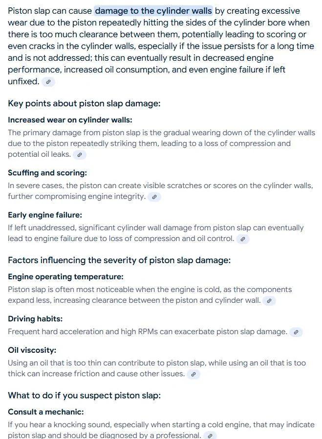

So the infamous bbq tick is most often caused by piston slap, which happens when the piston inside the cylinder has excessive side-to-side movement, causing it to lightly hit the cylinder wall, creating a ticking sound, especially when the engine is cold and oil is not fully circulated.
CERATEC works by adding microscopic ceramic particles to engine oil which adhere to metal surfaces within the engine, creating a smooth protective layer that prevents direct metal-to-metal contact, thereby reducing friction and wear on engine components. Essentially, the ceramic particles fill in the tiny irregularities on the metal surfaces.
You are just echoing a popular internet myth that is 100% false.

I've been doing this for a while, piston slap is when their is excessive play between the piston skirt and the cylinder wall. if I thought I had excessive piston skirt play issues and knowing what the end result would be if not verified/fixed, I would stop driving and remove the Heads and do a Deck Height and Piston Rock check. if it is outside of movement specifications for piston to cylinder wall. I would disassemble my engine and replace my pistons, inspect the cylinder walls for excessive wear etc.
But that's just me. I think of the "What If's" Plus disassembling my engine would give me an excuse to heavily modify. LOL. Good Luck
https://www.google.com/search?q=wha...IQARgKkgcFMjcuMTCgB8nxAg&sclient=gws-wiz-serp
