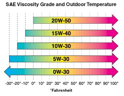

Don't forget that 5W-30 is good down to some pretty cold temperatures....5W-20 was usually only found in places like Canada until around the year 2000 when OEM's started using it for CAFE ratings.
