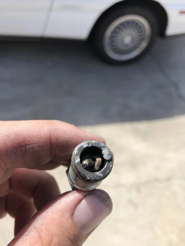

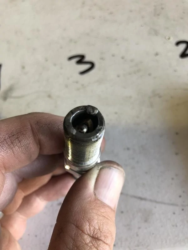

Oh yeah brotha mine exited stage left in dramatic fashion!
My fault really, I was showing off for a buddy on about 15 psi with less than 1/4 tank of fuel.
Went lean and munched #3 piston.
Moral of story... DO NOT beat on your car with any less than 1/2 tank!

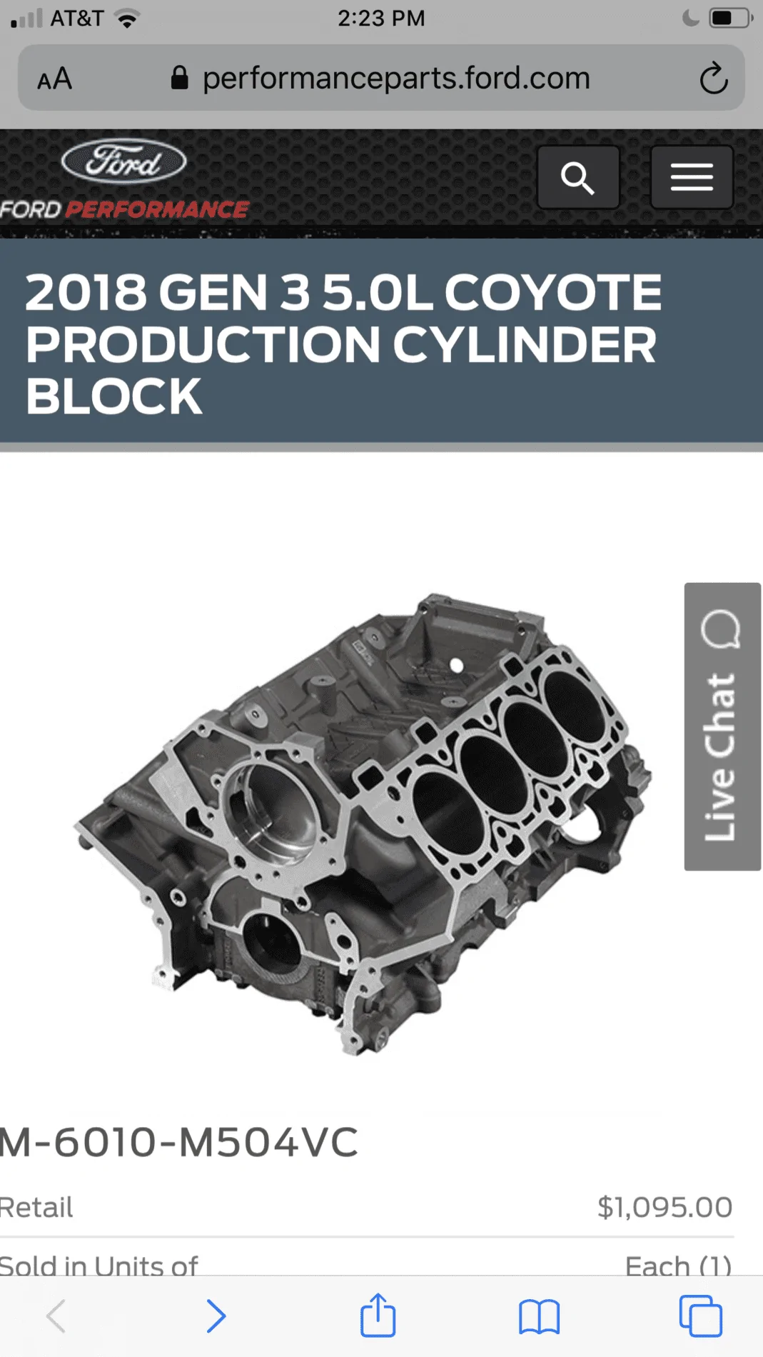

The Gen 3 has a much more open deck than the Predator block. https://performanceparts.ford.com/part/M-6010-M504VC
Thanks man . I know you had a lot of experience with these builds but I can’t really see the difference based on the pics on the website .
Also any thoughts on using a coyote crank vs the longer stroke predator /ford racing crank in a 5.2 CP build ?
I know the stroke is 0.012 shorter , and as you pointed out the piston will be below the deck .
Also I expect 11.9 vs 12.1 compression and 3 cu inches less (which I doubt I will notice on a mostly street car ) with the coyote crank , but is there any difference in the strength (both fillet rolled ?)
Thanks

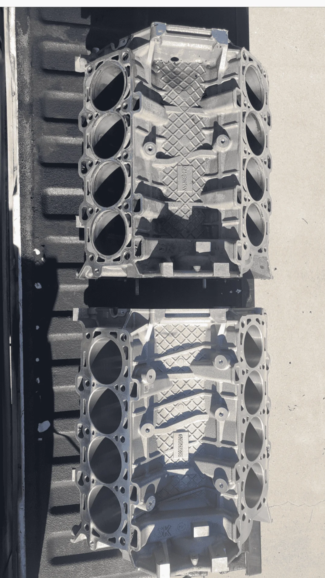

Here is real life pic of a predator block .
I believe it’s the same as the Gen 3. 5.2/voodoo.
Below that is a pic comparing the “Gen 2 “ voodoo to the Gen 1 .
I think the only difference between Gen 2 and 3 voodoo is the oil squirters that come with 3.

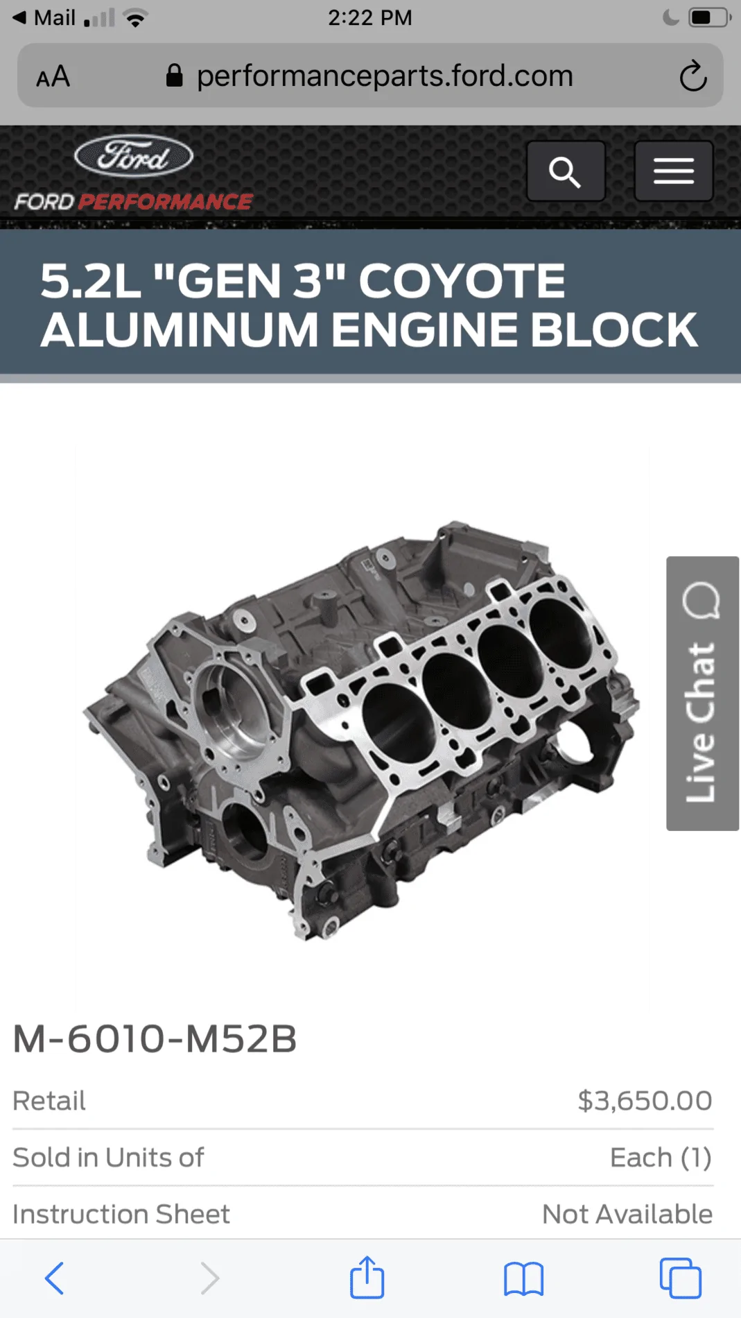

Is the top one the KR3z-6010 or M-6010-M52B?
The top one is the KR3Z-6010-A . I think the M-6010-M52B is just the Ford racing version .
The one below (in the pic comparing to Gen 1 )is the M-6010-M52A - Gen 2 .
That is what RPG used to build the block that Is in my Hellion car .
I believe it’s the same as the GR3Z-6010-F (E is discontinued)which may be what they are using in the Voodoo/GT350.
That’s the one I ordered for my build
It’s a few hundred cheaper than the KR3Z-6010.
