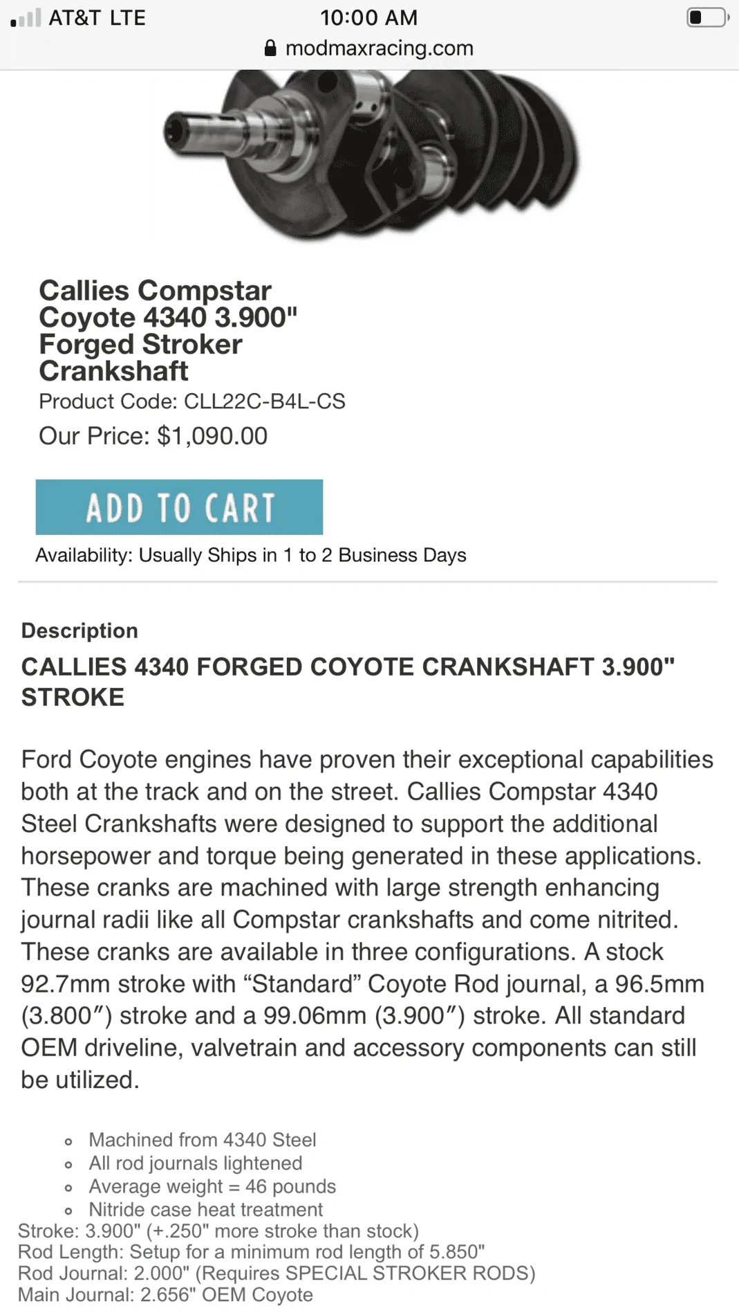

    I am planning a “spare “ short block for my 18 and I came across this
    I don’t see the the correct bore pistons offered for the 18’s but If you start off with a predator block(has the same deck surface with required knock sensors bosses )and you get a “5.4” !!
    Add ARP main studs and you can get a badass block for under $6K.
    http://www.modularmotorsportsracing...n_page=product_info&cPath=84&products_id=1056 D984A27F-ECE2-4CE1-BAD6-5D967B04706B.png

    I wonder how the water jackets are bored over that much?

    How are the rod angles? I'm suspecting this will take away 8k RPM capability which shines with forced induction.

    I like it. I have to wonder if there is adequate ring land thickness though. Any guesses?

    I don’t see where they get the space and not leave that skirt way of of the block.
    Any idea how this would affect redline from a piston speed perspective?
    So many questions.

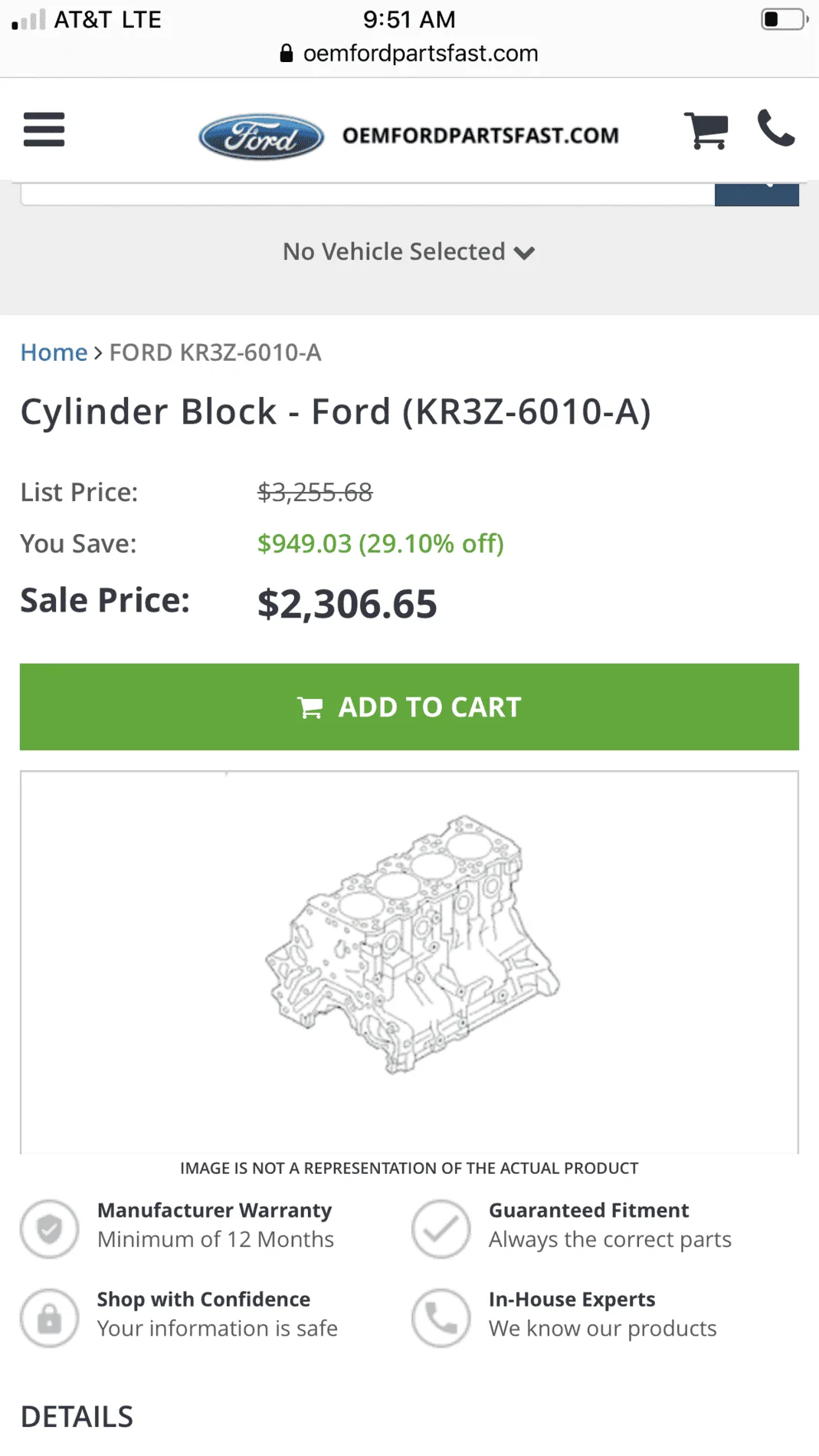

    Where are you finding a price on a predator block?

    Part number is KR3Z-6010-A
    Lowest I have seen is $2300.

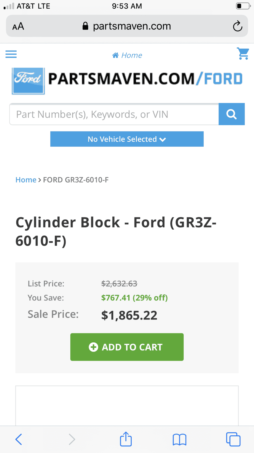

    The “voodoo variant “ is the GR3Z -6010-F (the previous Gen 1 ended with E and is discontinued)
    That’s a little cheaper at $1900
    I hear the only difference is the oil squirters.

    That’s an awesome idea. To me, the idea of a low-compression 91-octane 5.4 stroker is really appealing. I would think 850 rwhp is possible, reliably, without the need for e85. I only worry about the ring land thickness.

    I have already have 2 sets of brand new stock voodoo/Mahle pistons/rings ,Manley rods(5.9333 length) -specific for the pistons and stock stroke crank - ( I got quite a deal) and just paid for the block . Not yet bought the coyote crank but it’s a little late for the stroker now as would need an entirely new set of stroker rods and pistons .
