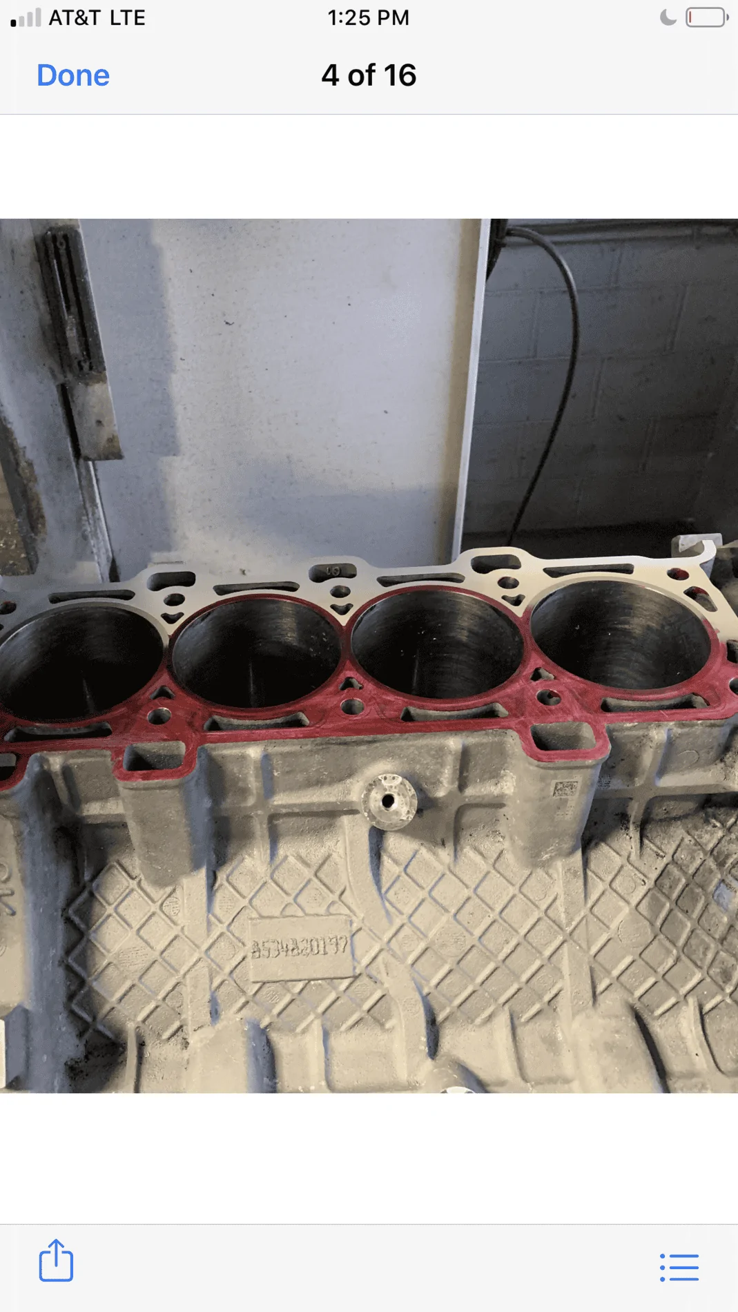

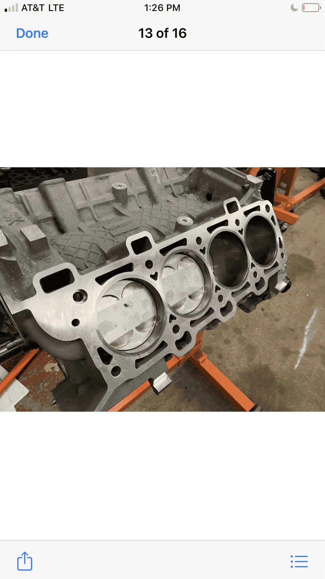

I have a brand new FRPP gen 3 5.0 coyote bare block delivering next week.
I’m gonna pack it with Manley HD pistons and H Tuff rods.
I’ll be into it right around $3000 all in.

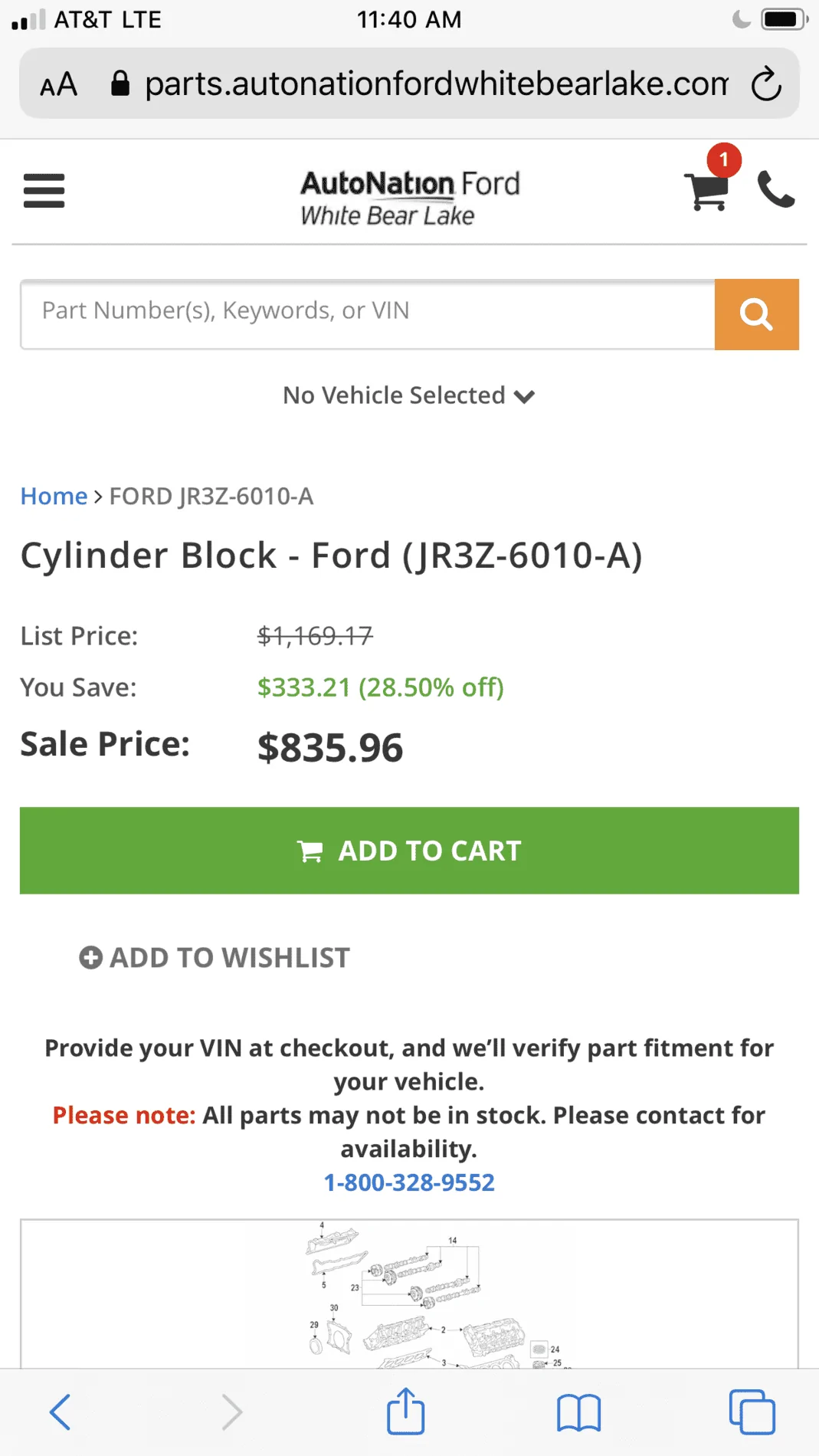

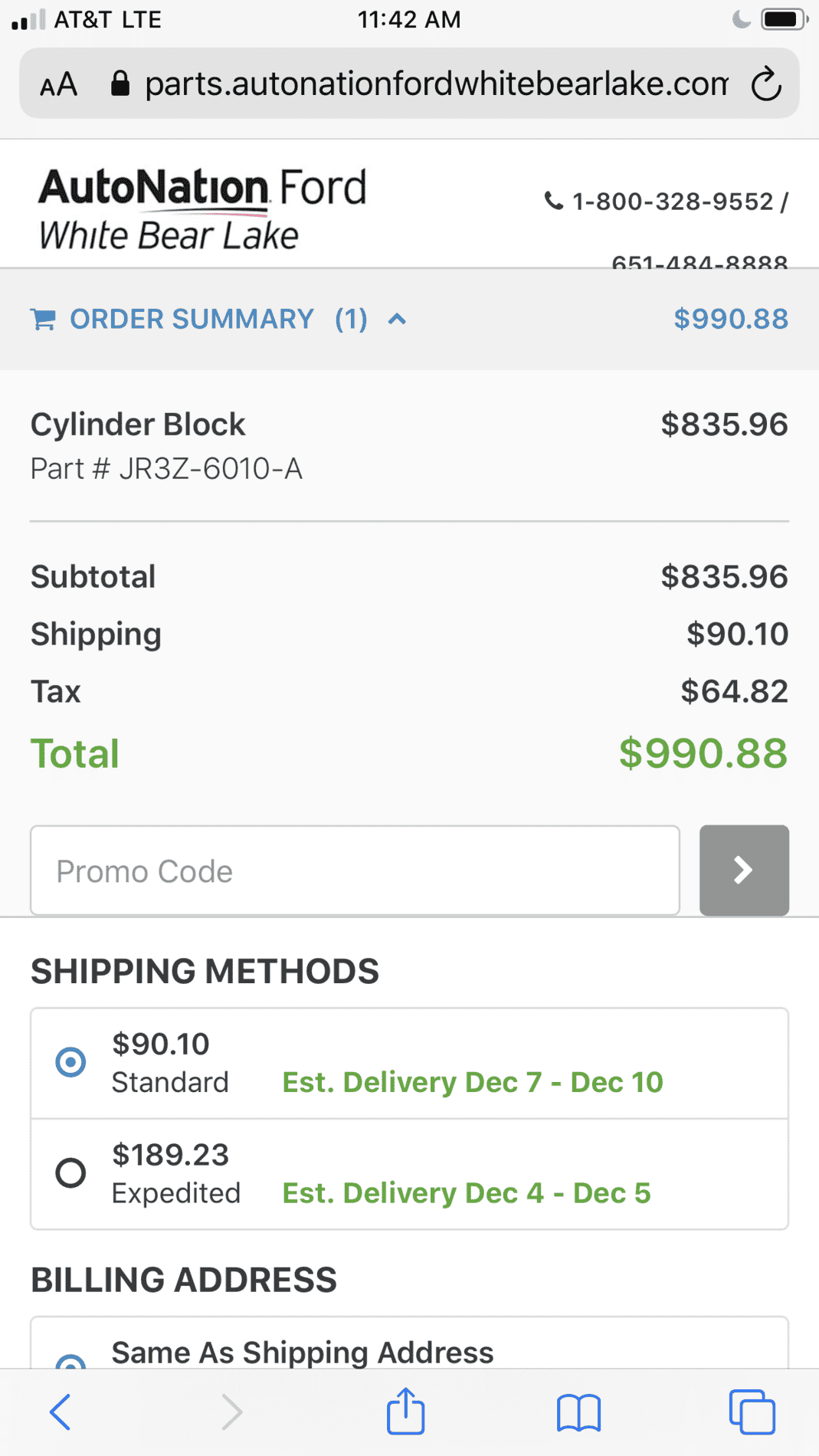

Retail is $835 but $990 when you add shipping and tax .
Cheapest is if you can get your local dealer to price match .

Please can you take a pic in the intake surface when it get it ?
I want it see if it has the same bracing as the new voodoo/predator block .

Great news for you. How do they "clean up" a spray bore block? Im curious on that one.Well I got good news. Machinist called me this morning. Block _will_ clean up at .005". So gonna send it. Will have stock crank, Molnar Power Adder Rods and Diamond Mod2k pistons. I can tell you, it's definitely cheaper to use a Gen 3 block than what I have in machine work. Live in and learn. Definitely interested in what others come up with.
