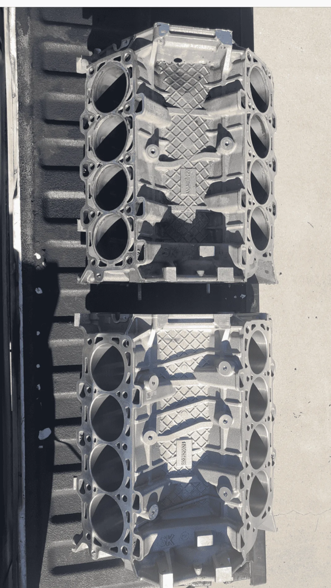

It looks like there is extra bracing that is "raised" at the top and bottom of the valley on the Predator block that is not present on the Gen 2 block.
However, that bracing also appears to be present on the 5.0 Gen 3 coyote block?? Have a look here.. some great pics.
http://www.mustangandfords.com/how-to/engine/1709-inside-look-at-the-new-2018-coyote-block
They are exactly the same, I originally thought he was asking about the deck (where cylinder head bolts to).
I may confusing with my pics .
The picture below shows the Gen 2(voodoos/5.2)block below the Gen 1(voodoo/5.2)
It looks to me as well the Gen 2/3(voodoo/5.2) and Gen 3 coyote all have that extra bracing .
shoot ... I see it now .
Do you think that difference could lead to a potential issue bolting Gen 3 coyote heads on to the predator /Gen 2/3 voodoo block ?.

Extra like .
If it did I would have to go back to the drawing board and rearrange my plans .
I would still be able to use the block /Manley H rods/voodoo pistons I already have with the builder but would have change to a FP build now ( I had planned for later) for the GT 350(have an extra FP crank ).... but then I would still need a Gen 3 coyote block /pistons/rods for my 18 .
Why does the Coyote block have all the extra open passages ?

Probably to save money. Or "How do we charge 3x as much for a Predator block if they look exactly the same?"
LOL. I have suspected for a while the “upgrades “ applied the predator block are already also applied to the Gen 3 Coyote .
Only real difference seems to be the displacement. .
shoot.... if I had known for sure I would probably have skipped 5.2 build and just stuck with the Gen 3 coyote block .
I did save a bit on the voodoo pistons /Manley rods so I am not far off where I would be with the building a Gen 3 coyote .... as long as I don’t get fancy and use the $1200 crank . Lol
What I’ve been trying to say all along lol
Paying for the “5.2” and “Shelby” or “predator” name.
The best thing that could have happened to the Shelby brand is going coyote-based.
