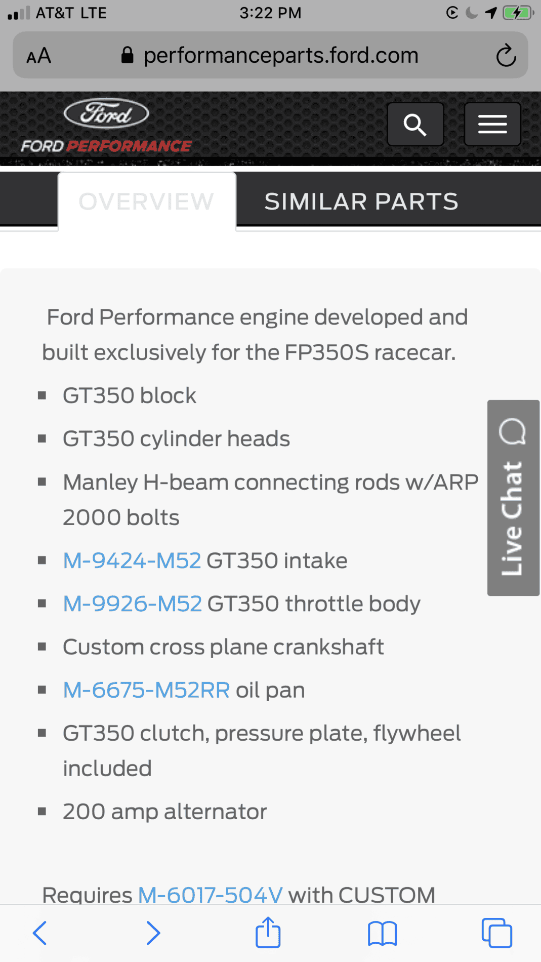

I will need one rich girlfriend and two of those.
I wonder what “custom cross plane crank” refers too?
I wonder too .

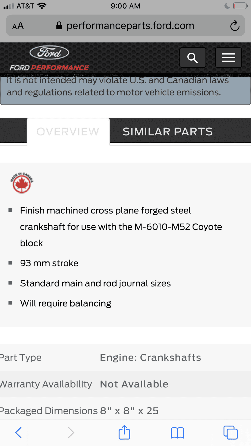

Ford racing does make a “5.2” crank they use wirh the alluminator XS .I am not sure if this is the same crank they use in the predator in the GT 500.
It has a longer stroke-93 mm vs the coyote - 92.7 mm .....but it’s $800-$900 more expensive at about $1150 retail (best I have seen).
I will be using a coyote crank with my “predator “ block build for my 18, like I have done with my other “5.2” builds ....technical it won’t be a 5.2(317 cu inches ) but a 5.15(314) . Lol
I will also lose a point of compression with the Voodoo 12.0 pistons but 11.9 is not bad and may actually be a good thing .
https://performanceparts.ford.com/part/M-6303-M52

Looks like it’s the same crank used in the predator.
Part number is KR3Z-6303-A.
https://parts.autonationfordwhitebearlake.com/oem-parts/ford-crankshaft-assembly-kr3z6303a
I have been searching and found the ford racing version for $1066 vs $366 for the coyote so it’s about a $700 spread .
I know some sites list the coyote crank for $325 but by the time they add tax and shipping it’s almost $400.
Still debating if it’s worth the extra . I mean, If Ford could have used the cheaper coyote crank in the predator /Alluminator but chose not to ,must be for good reason, right ?
