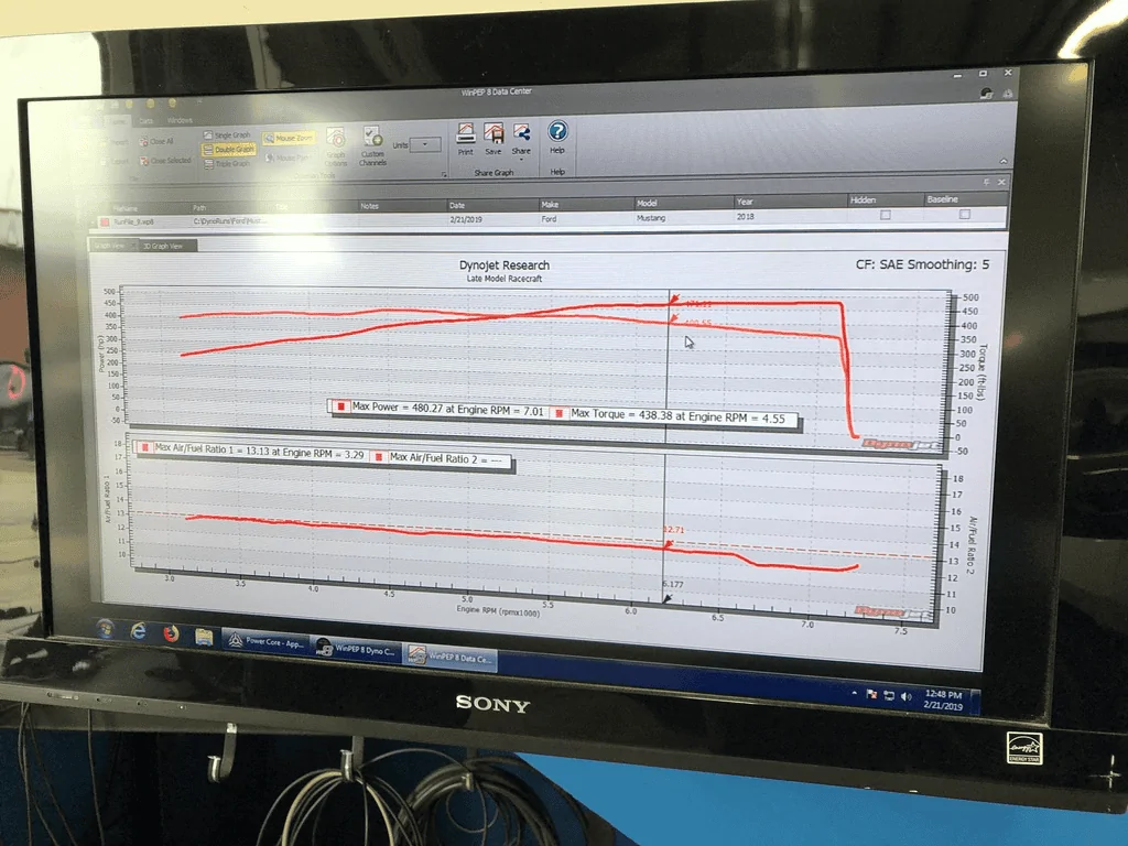

Stock 2018 5.0 off the lot made 398rwhp
MODs:
E85
JLT CIA
Long tube ARH 1 7/8
Roush axle-back
325/30/R19 rears (about 1.5 lbs heavier than stock each tire/wheel)
now 480rwhp 438 rwtq on SAE numbers
Dynojet on SAE, 55 and rainy in Houston so always humid lol

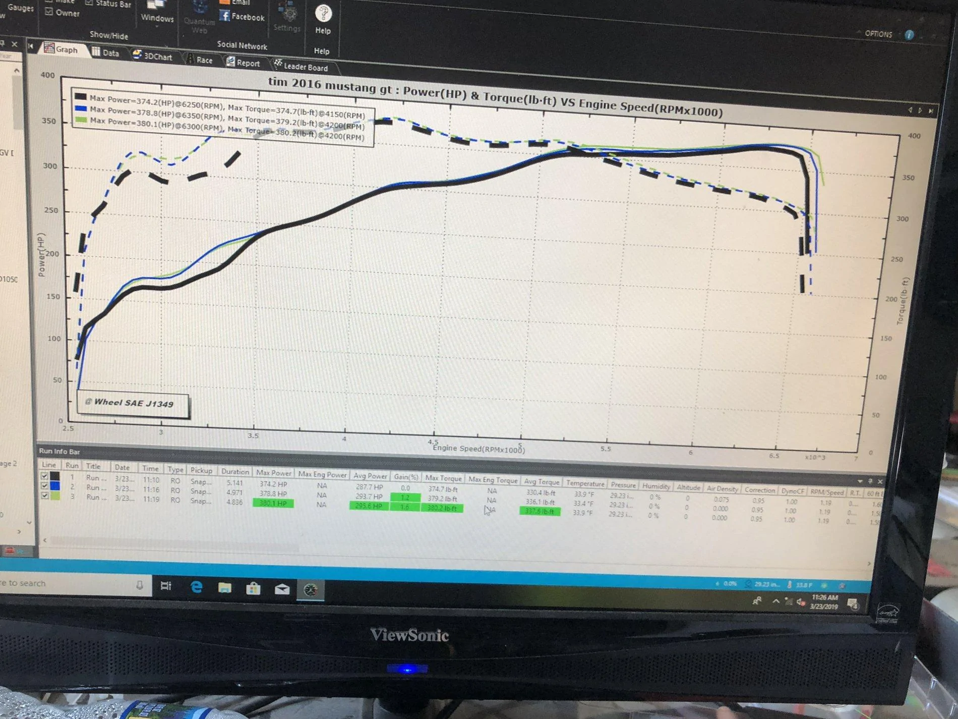

Mods JLT intake corsa extreme cat back and Lund flex fuel. Car had 93 in it and locked at e17.
Made 380 wheel and torque pulls were done in 4th gear due to it being a auto with 3.15s.

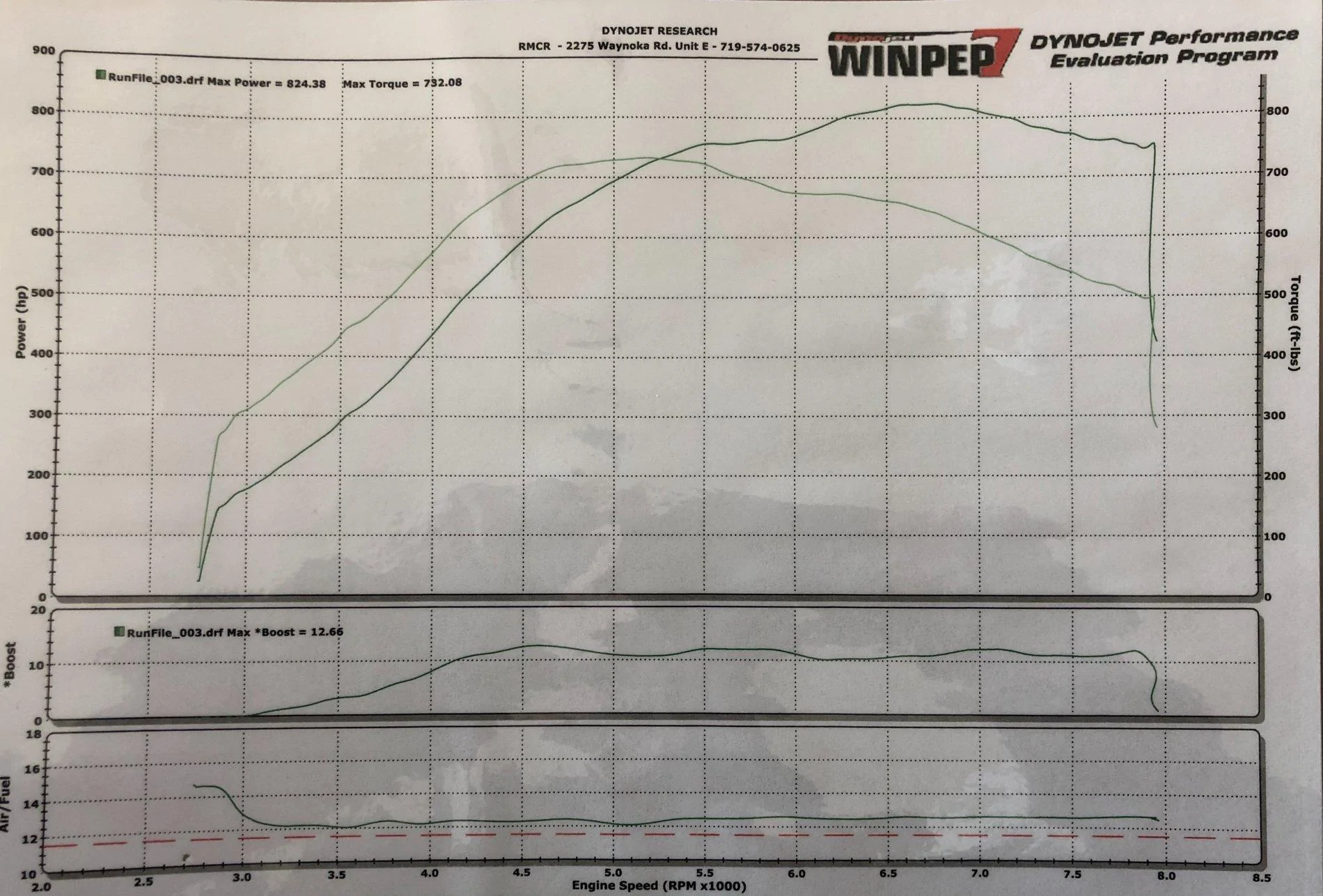

2015 Mustang GT PP with Following Mods:
-aluminator sc short block
-procharger d1x/stage 2 ic/red race valve
-custom cams (baker)
-long tubes/x pipe/gibson
-id1000/fore
-rxt
-calimer stage 3
-mgw shifter
-dss 1000hp shaft
-3.15 rear
-dss 2,000hp half shafts
-315/30/20 toyo r888r on 20" x 11.25" niche methos (widened from 10")
-93 pump gas
-custom tune (baker)
-elevation of approx. 600' with indoor dyno at about 70f
-dynojet std
807hp/554tq
