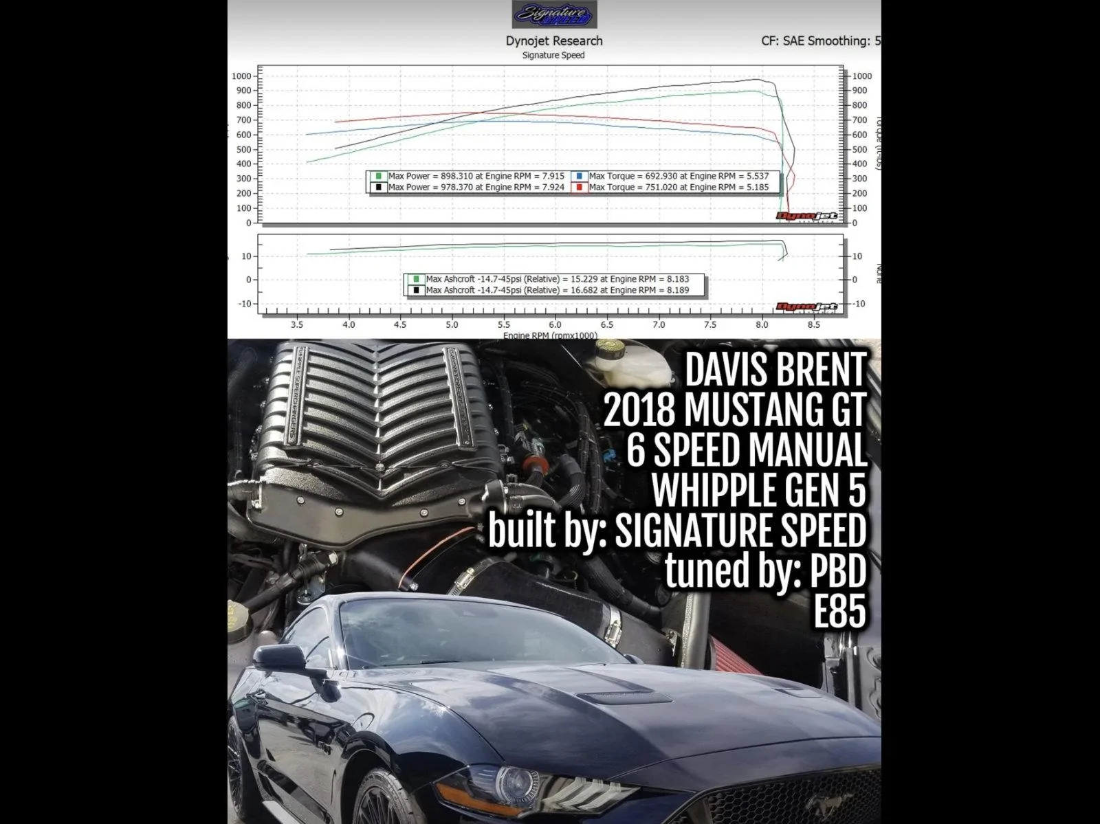

Wow. Those gen 5 whipples are something else. Seems to be the way to go.
Well it is a great option but it all depends on how you want your power curve to be. The Whipple is instant on the hit whereas the centris and turbo cars may be a tad less on the hit. I had a twin LPF kit on my ‘16 GT and this Whipple would kill that car from the hit and possibly hard to catch it.

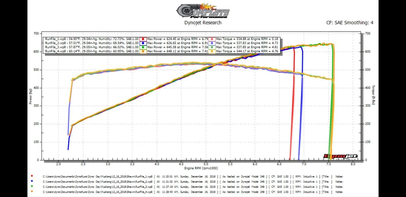

Roush Phase 2, BBK Longtubes, Flowmaster X and Exhaust, SCT x4 (no idea on boost but less than 10lbs or who it was tuned by) DynoJet @ Complete Performance Marietta Georgia Atlanta S550's dyno day.

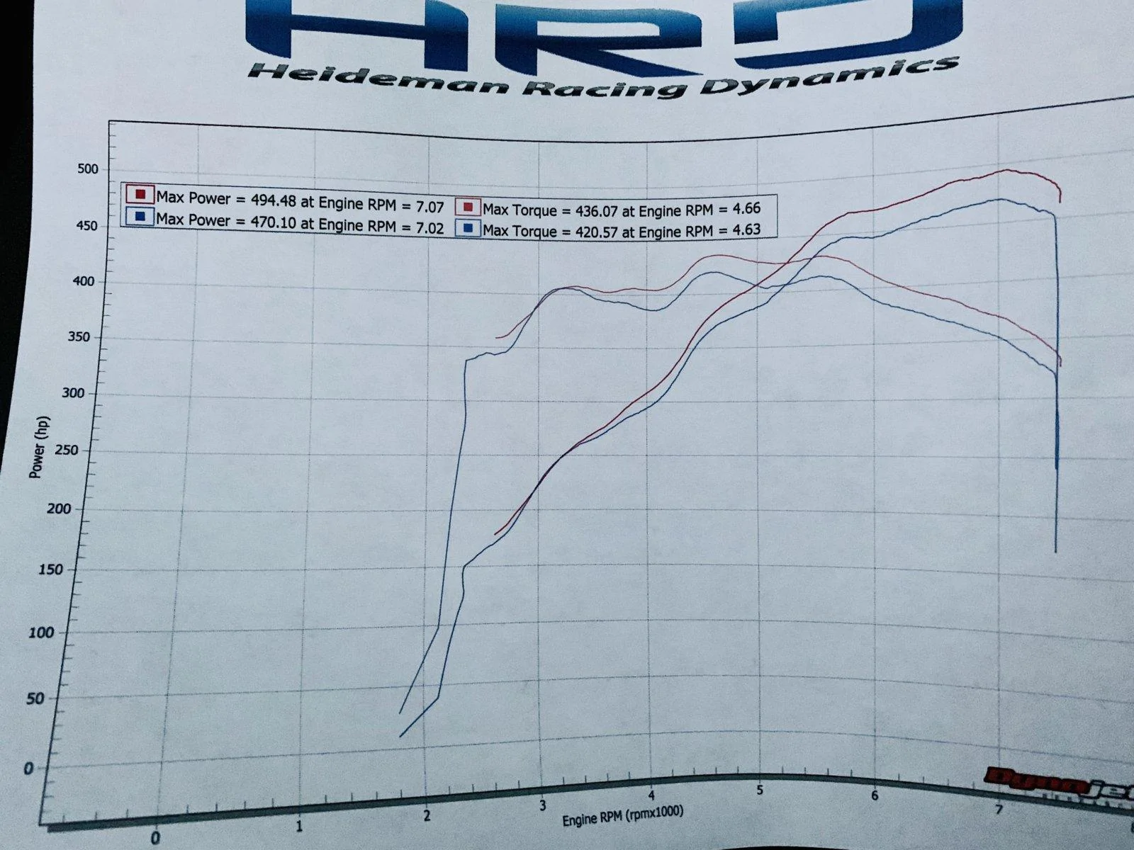

2015 Mustang GT
whipple stage 2 gen 3
3.75
132mm TB
Whipple intake
DW 95LB injectors
DW 400LPH fuel pump with a votage booster
long tube headers with green flow cats
Plugs brisk-rr14ys .40 gap"
VMP IAT
Thoughts?

I think you should use a tuner thats mainly into coyotes ex. Lund, Palm Beach Dyno, AED.
Id expect that car to make over 700whp esp with the 132mm TB headers and decent fuel system.
IIRC jannetty is mostly LS stuff?
Not saying they cant tune but the VCT on these engines makes a massive difference when tuned well.
Thus the reason Id trust someone that knows the coyote engine very well.
Tune will make or break any setup.
