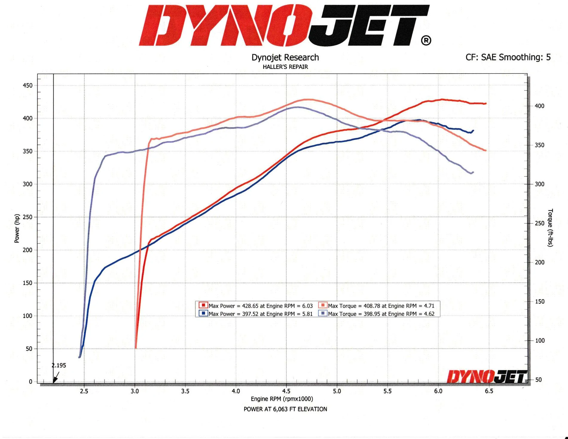

2018 PP1 GT 6MT : 6,200 miles
Baseline dyno run last week: Stock w/ AFE dry drop in filter, 91 octane (397 whp / 399 tq)
Yesterday's dyno run: AFE dry drop in filter, Lund E85R tune, Roush axle back, E85 (428 whp / 408 tq)
Both dyno runs on Dynojet at 6,063 ft. elevation.
Last week's run: 80 deg. / 30% humidity
Yesterday's run: 85 deg. / 34% humidity
4th gear pull on both runs.

Surprised to see the TQ so close to the HP. Why were the pulls done in 5th instead of 4th (1:1)?

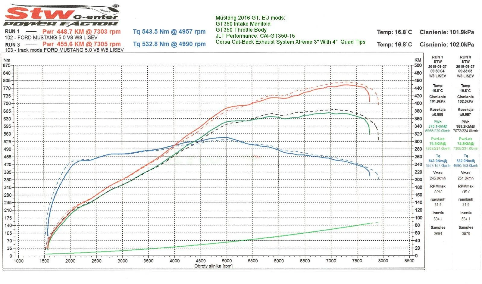

2016 GT Auto, Europe edition with following mods:
GT350 Intake Manifold
GT350 Throttle Body
JLT GT350 CAI
Corsa Extreme Cat-back
Tune
Mind that these are metric units in graph.
1 KM (metric) = 0.98592 horsepower ( imperial )
16,8 (celsius) = 60.8 ( fahrenheit )
Elevation: Around 330 feet
Pull done on 4th gear on DynoProject dyno. Unfortunattely I haven't done dyno prior to mods installation :(

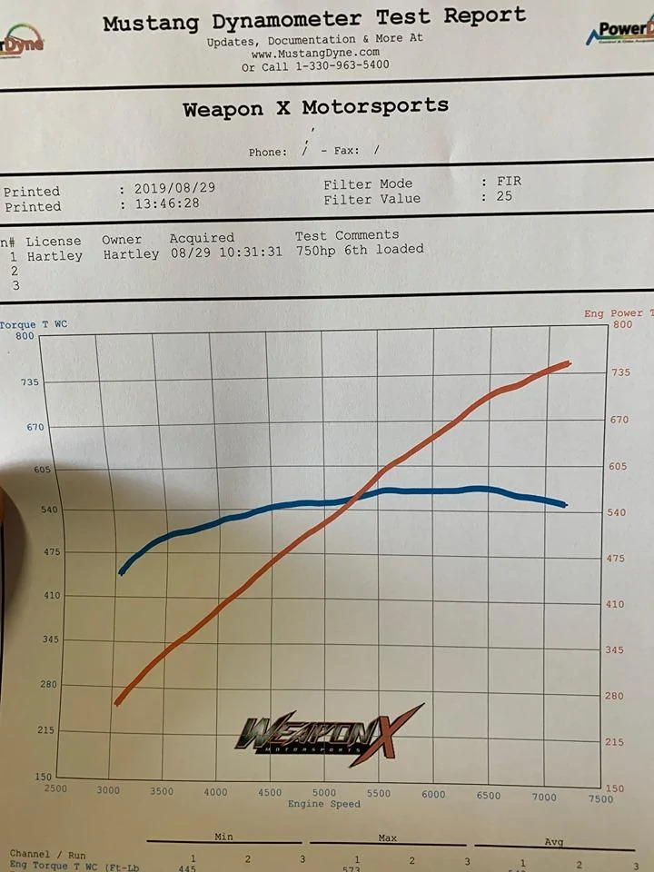

  • MMR Billet oil pump gears and crank sprocket
  • Whipple 3.0L stage 2 w/132mm TB / 3.5 griptech pulley
  • Texas Speed full length catless headers and x-pipe
  • Fore Level 2 fuel system with dual 267’s and filters setup for e85
  • Injector Dynamics ID1050x
  • NGauge programmer
  • E85 tune by Lund
Pull was done in 6th gear due to some clutch slip in 7th.
Mustang Dyno 750/573

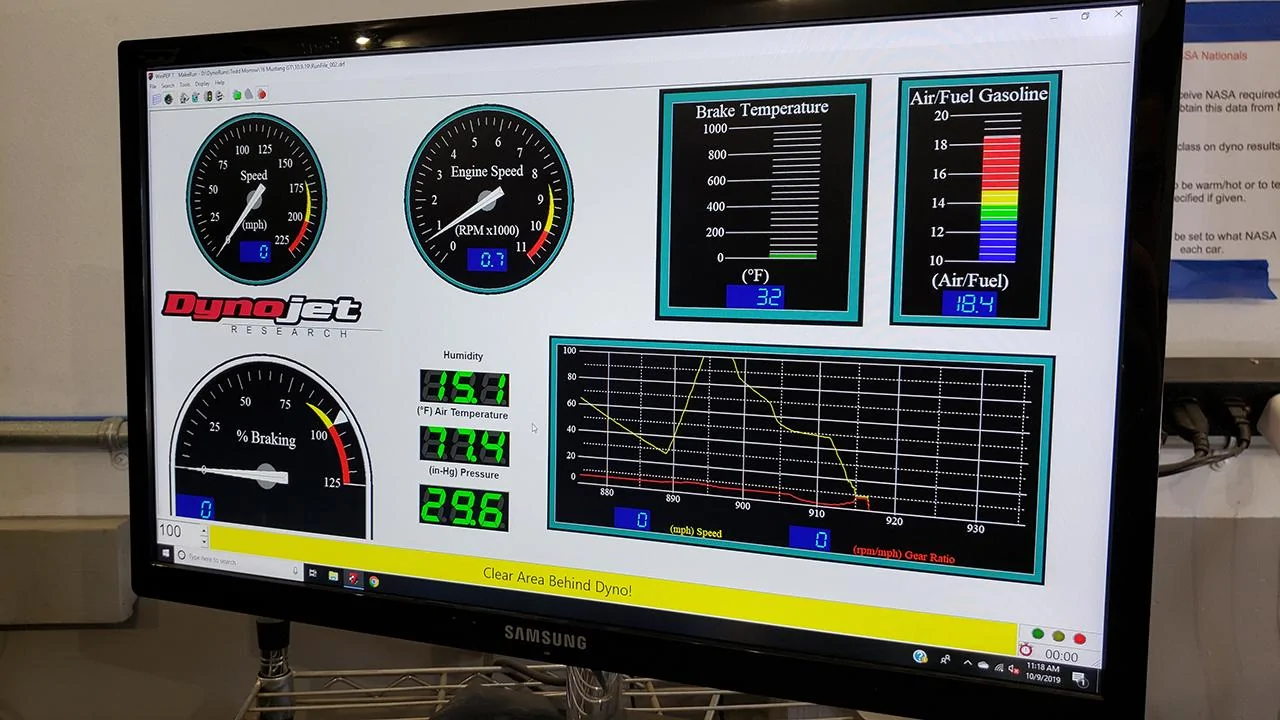

Third Dyno Session: 10.09.2019
GT-350 CAI, TB, Ported IM, 47 lb Injectors, CS, OPG with 91 and e85 tunes by Palm Beach Dyno with Custom Dual Magnaflow exhaust. Dynojet at TFB Motorsport @ Sonoma Raceway.
These pulls were on 91 and yielded more power than last run at RPM. I wish all the runs were more consistent with the second run lol.
Weather conditions:
