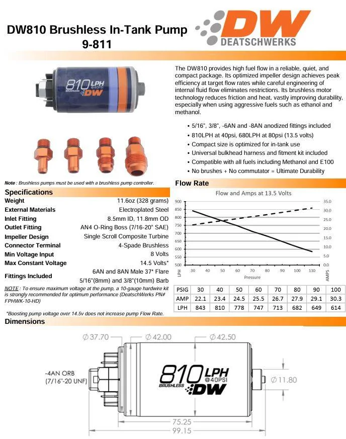

You can do all of that OR just get ONE of these:
https://deatschwerks.com/collections/dw810
At first I jumped, hadn't seen that. No check valve and can't be boosted more than 14.5V. Also draws quite a bit for the flow/output. I don't think one pump with an external check valve and all the system friction losses would get to 900 rwhp (especially if partial leak due to the siphon system)
All you need is the flow, it flows more than two 274 pumps at 55 psi. 2 274 pumps can make 900 on E85. No need to boost the 810. The two 496 pumps that I have would still out flow one of these, but for the cost and ease of setup this is probably going to be a more potent set-up with failures in mind for a two pump setup.
It's better to compare at the target pressure, which is around 70-75 psi (base pressure + boost to make 900 rwhp). At 70 psi, the 810 flows just over 700 l/h. At 70 psi the 274 flows roughly 355 l/h. So a pair of them would have virtually equivlanet flow to the 810.
The main differences being A) the 810 doesn't have a check valve, so an external would have to be installed in the feed line, which is usually a couple of PSI pressure drop (slight reduction in flow at sustained 70 psi) and B) the 810 does not have provisions for the siphon system, so that would have to be plumbed internal to the bucket. Not a big deal, just FY and C) the 274's can be boosted, the 810 states that boosting it over 14.5V will not result in an increase in output, essentially you get what you get.
Cost wise, it's probably a couple hundo cheaper to go with twin 274's (if you need the controller version of the 810).
Essentially, it would work, just require a bit more customization (check valve and siphon connection) but would be more efficient in that at idle conditions the 810 draws around 25 amps, whereas a pair of 274's at idle will draw around 32-33 amps together.
In summary, you get a little bit more efficient system, for a couple hundred more, but have very little room to grow in the future unless you add another pump (instead of boosting).
