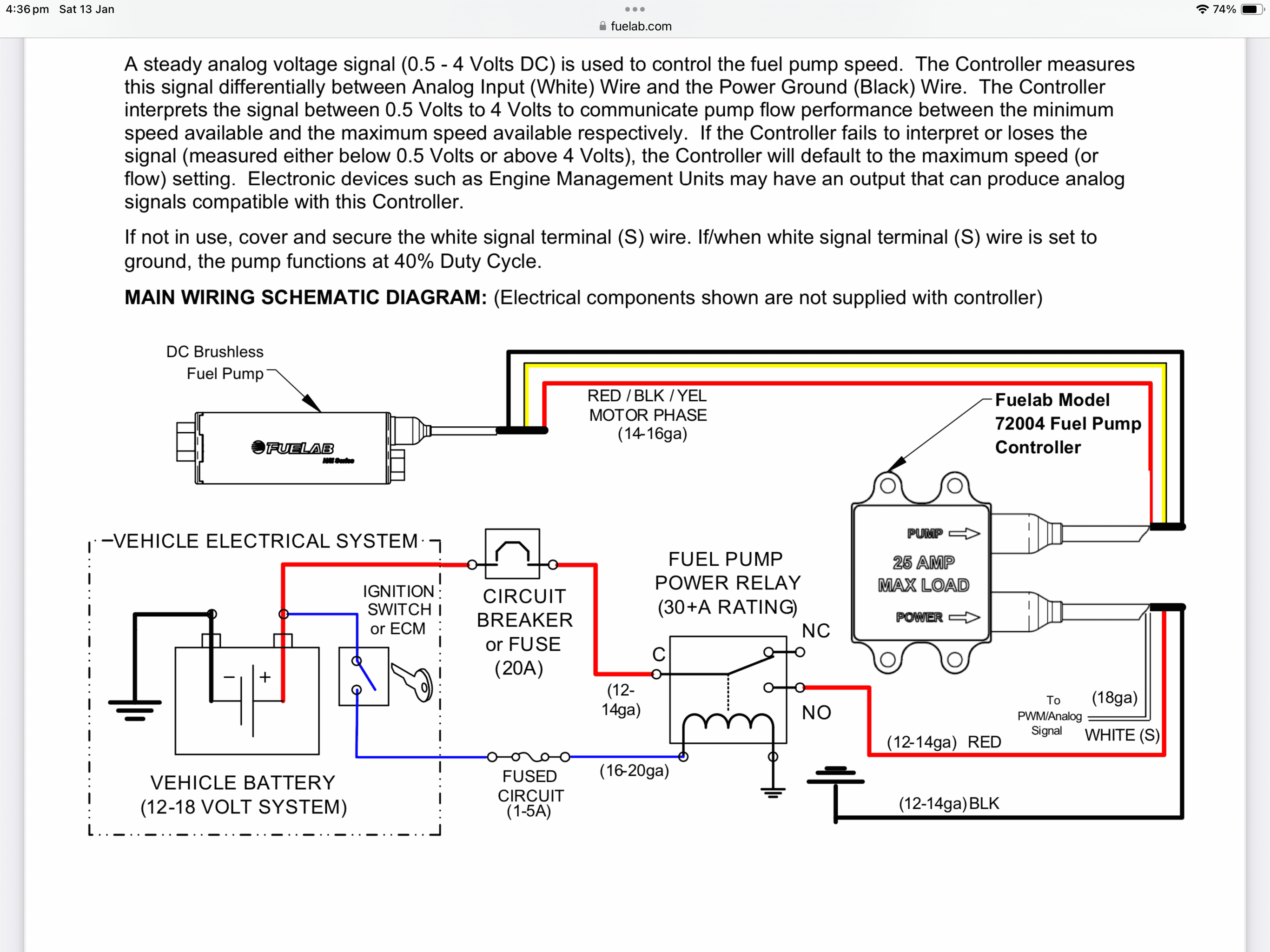

Not trying to do anything but learn atm.
yeah just interested in a way to control brushless motor speed.
gives you the ability of having the fuel pump working at variable speeds , 25% , 50% and then 100% under boost…. Fuel regulator pressure controlled via Boost curve. Maybe 15psi.
controling the speed via 0 to 5V. Maybe from TPS , MAP or throttle pedal Etc
or maybe just add a Honeywell pressure Sensor with 5v signal , then manifold pressure will control pump speed , fuel reg will take care of the rest.
electronic fuel reg is interesting Thanks.
This is what I like about the fuelab controller. Pic attached
So I have Fuelab 496 pumps, all you need to do is use a 0-5VDC Map Sensor, For me, I use a 1 bar map sensor, once the controllers sense ANY boost, you get full power (Pump Speed) from the pumps. This pretty much ensures that the engine will never be starved for fuel.
Now they have new controllers that can do Either PWM input or 0-5VDC Input.
