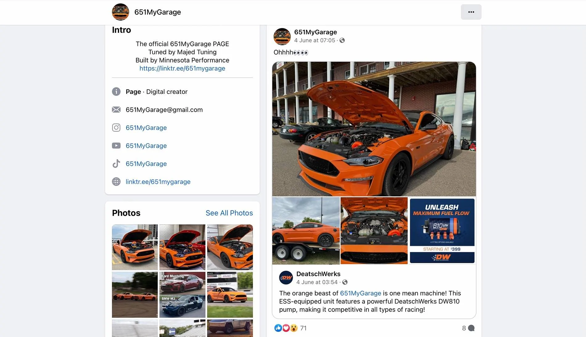

ive Looked into this a little for a future set up for my self. You could use throttle peddle or throttle body To get the signal.
i also got into contact with DW and the owner of this car. Check out his YT account.
he runs a radian bucket , single DW810 brushless with their controller , 50% and 100% settings and just controlling it with a hobs switch. He is 1000hp
he changed from a fore system due to issues with fuel starvation with less than 1/2 tank etc.
I like the simplicity of this set up for sure.
