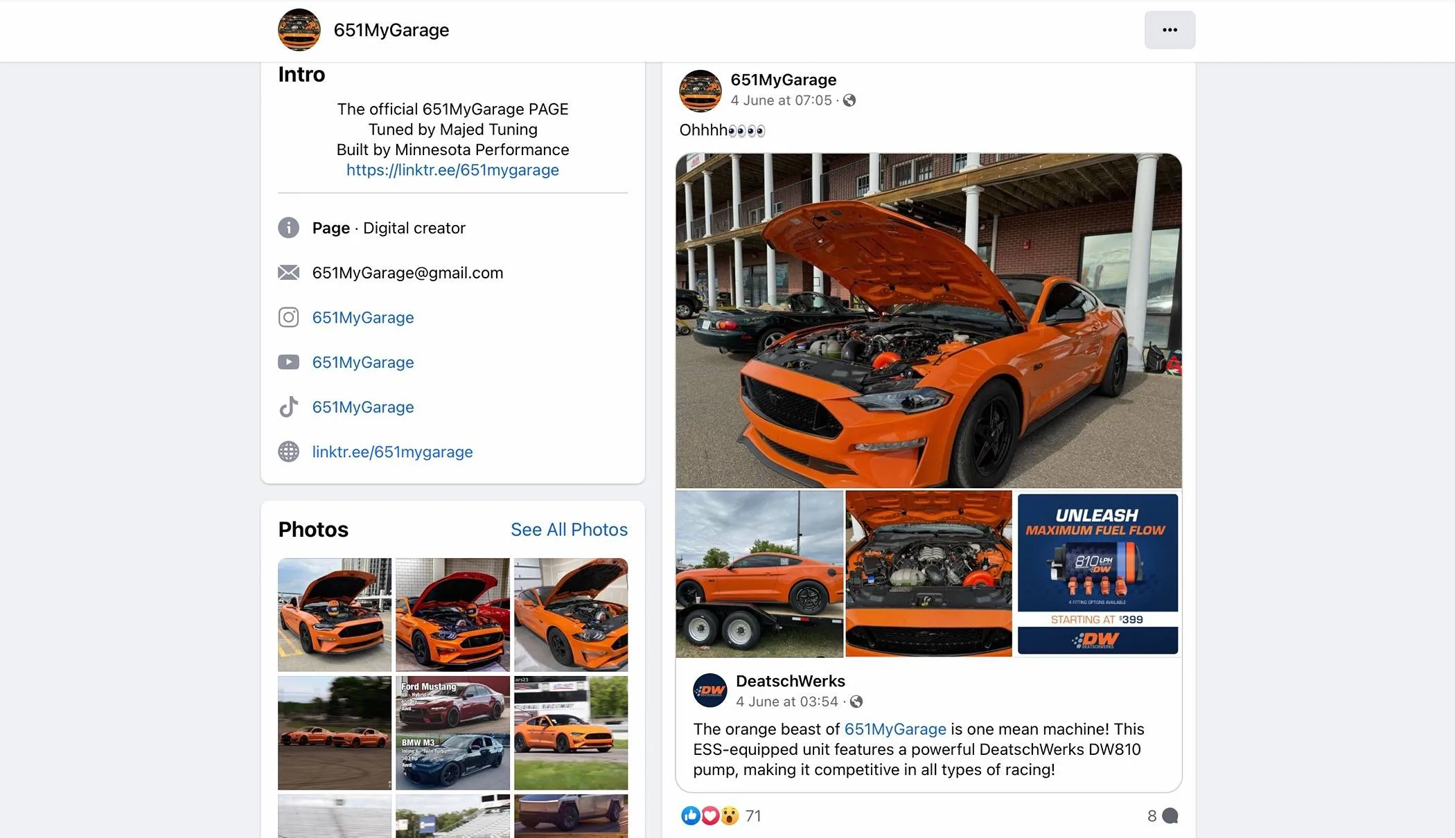

He mentioned it in his lastest video about swapping.
I’d like to know how he has the DW810 set up ? He has now change from a fore system due to fuel problems and now running a single dw810. I think he is around 1000 rwhp.

he is running a return system with the standard dw810 kit with 2 speed controller (hobs controlled) 1/2 speed , full speed…. In a radium bucket.
