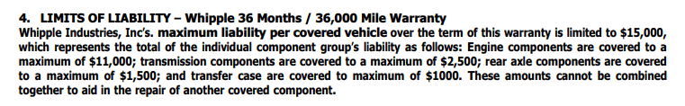

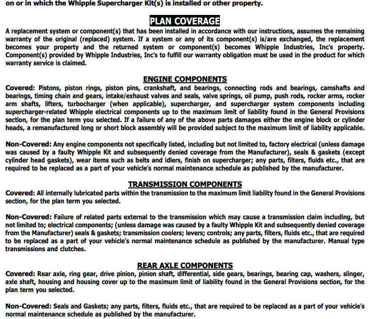

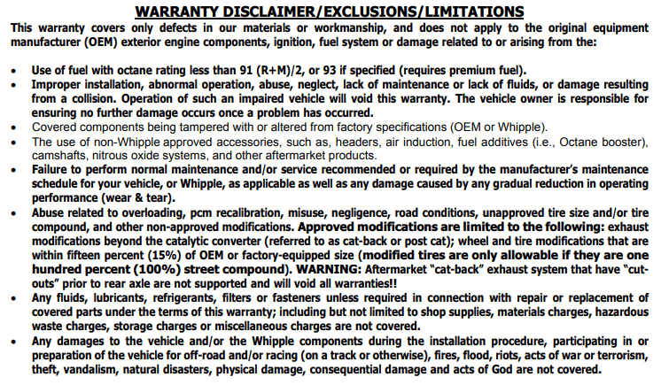

That depends. It isnt a bad warranty. I would encourage you to read all of the terms carefully. Consider your future goals as its not going to cover items if you turn the power up further or do custom tuning. Consider what a dealership or CERTIFIED Whipple installer will charge you vs doing it yourself or some other more affordable (but compitent) installers will charge. It might be right for for you. I personally dont like warranties and go outside the bounds of coverage anyways. Just some things to consider. I will say Ive installed a lot of Whipple kits and there is very rarely a problem with the kits themselves. Things usually fail due to abuse, launching on sticky tires, improper maintenance, poor fuel, ect. Both the car and kits are very reliable when used within those parameters with the Whipple tune, proper custom tune and supplied boost levels.
Yeah you make great points there. I need to find out what the deductible is and what the install cost is. I always install everything on my cars my self hate to have a shop do it.
If anyone can chime in that got the warranty would be great, deductible is not on this document attached(Straight from Whipple website).

Most bigger performance shops are going to be in the 1500-2000 range. We charge less just because its a side gig and we can get away with it not having all the overhead. If you are mechabically inclined its nothing you couldnt do with some proper tools and a free weekend of time. Even better if you dont need the car and you can really take your time. Whipple supplies good instructions.

Not sure how recent this PDF is but here's some pics of Whipple's warranty terms to add some info in here. Although, what I don't know is if they've actually paid anyone or not if they've kept within Whipple's terms of warranty.

I think that whipple warranty start the day u took delivery of your car. So if u like me and get whipple warranty it only get u 1.5 year more. And I never get to 36k.only got 4200 miles now.so i would just have to 🙏 and hope the engine & trans don’t blow

Add any other parts that don't come with a Whipple or Roush and the warranty is void not to mention it must be installed by a ASE certified mechanic.
