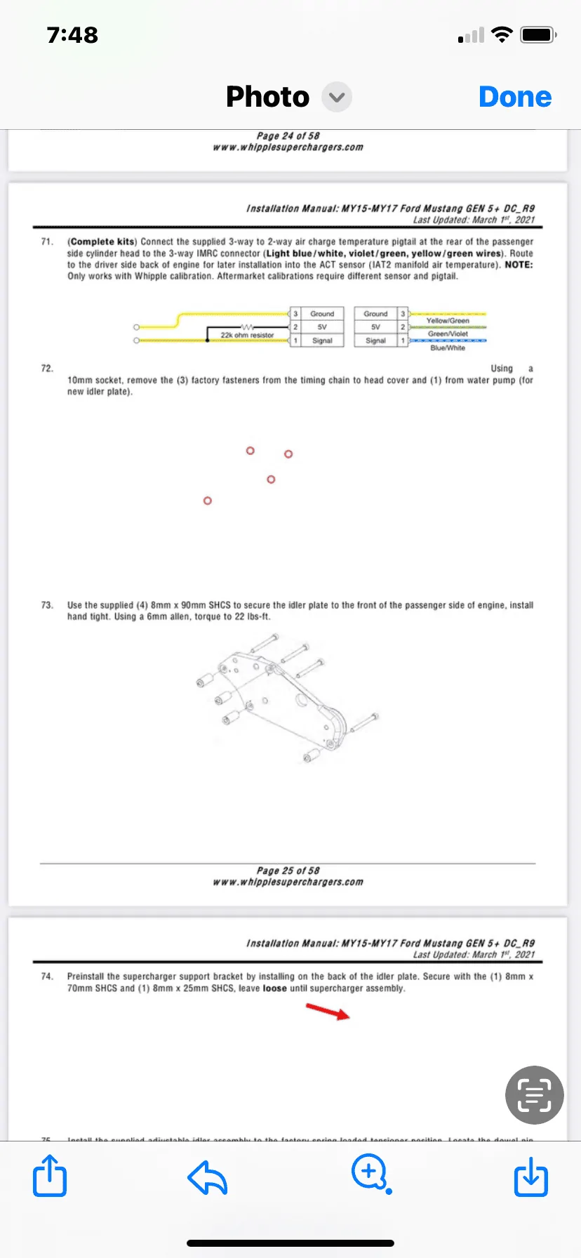

I bought a whiipple 3.0 for 2018-21
I have a 2015. I have iat extender and everything else looks good. Just don’t know what to do with imrc. Do I just cut and make new connections?

The imrc will be gone, so I believe you just leave the pigtails empty.

Yes ziptie back the connections so they are not flopping around creating false knock. Pretty simple

The whipple has a plug for imrc so just don’t use it?

Whipple uses the imrc input to get the charge temp into the pcm.

So that plug is more for them I don’t need it if I am using Lund is that what your saying?

Yes but you can confirm with Lund.
Personally I don’t like this method because you lose the ability to log ambient iat and compensate the maf signal for iat.
