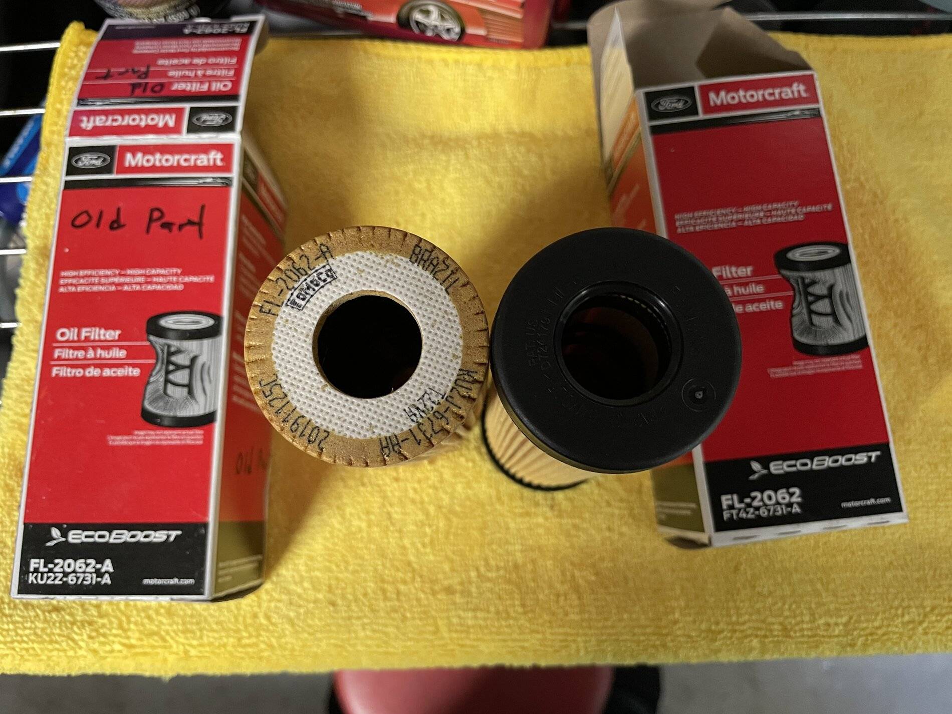

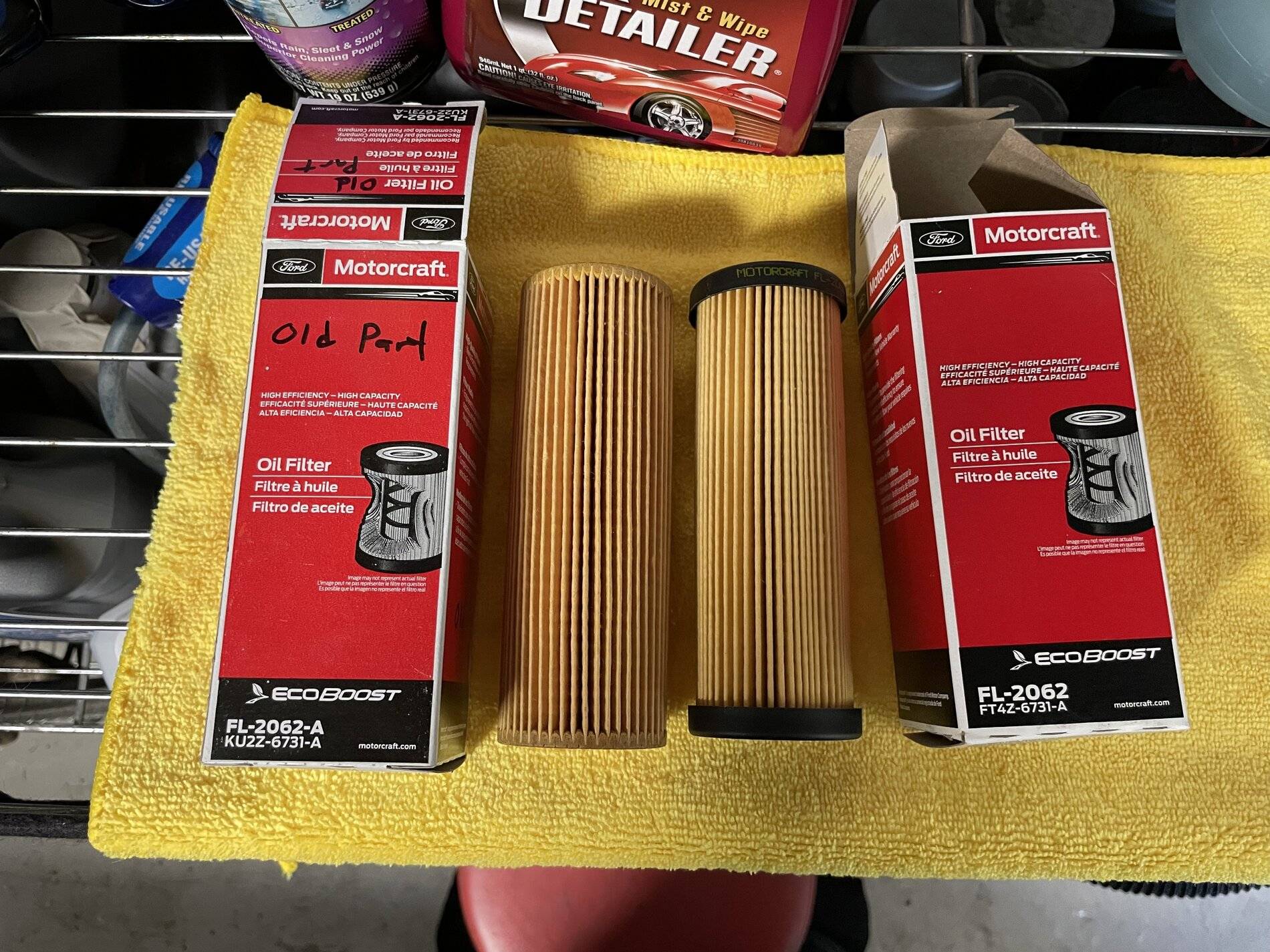

I bought a 2062A in a panic when this filter shortage hit.
Now, is the 2062 and 2062A that different?
Here is the 2062A and it looks nothing like what the OP is showing.
Here they are side by side. I've used both with success.

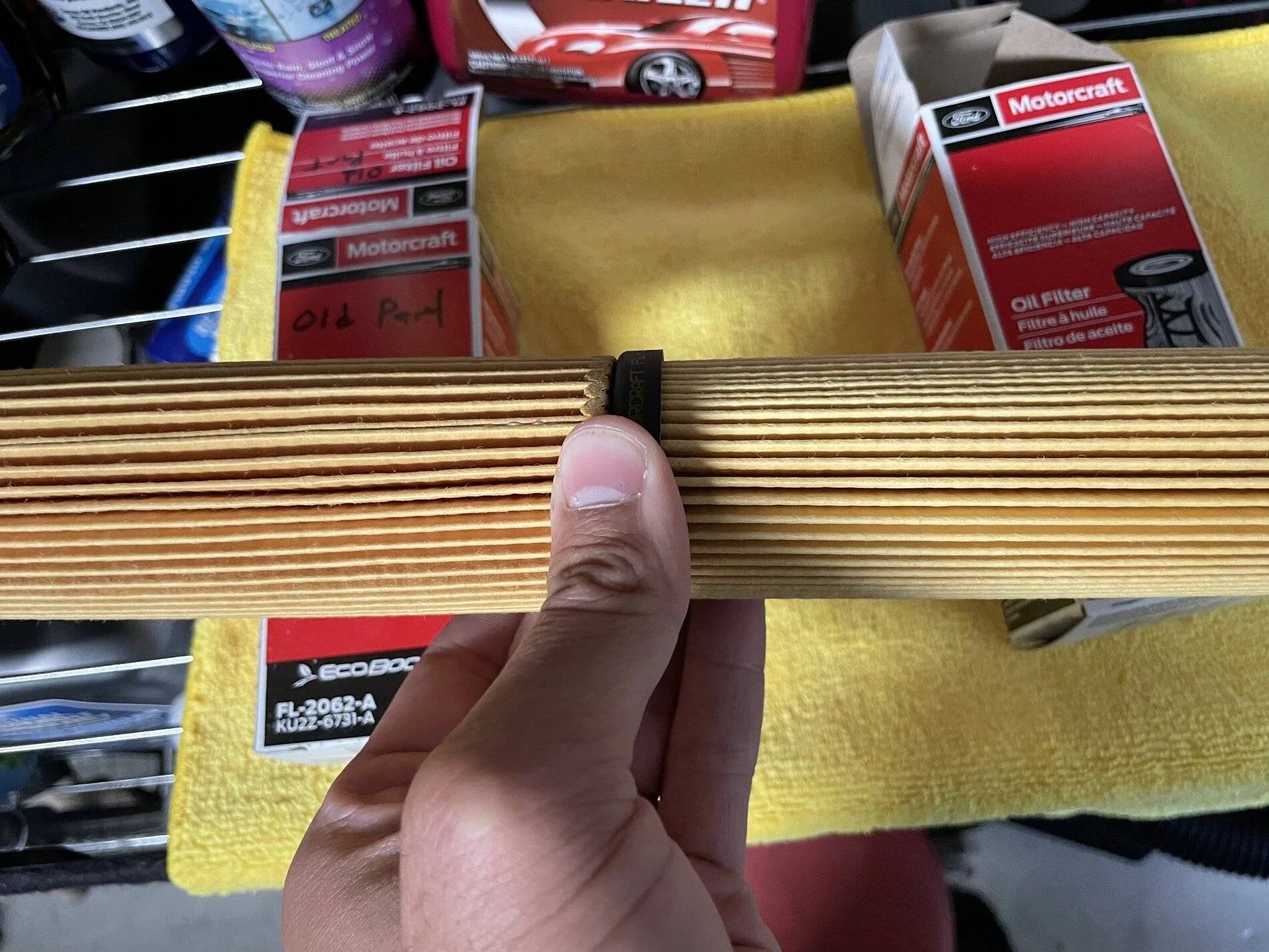

As for squeezing the filter upon installation, what could cause it to dimensionally bind? Surely the engineers that designed the piece wouldn't have allowed a situation where the housing can be tightened to the point of pinching the filter? And if it's inserted into the assembly, what's there that it could catch on or not align/seat properly?
I don't think it would have been while tightening the housing. Look at the bent top shoulder of the filter in the last pic. I could see a situation where the tech is working fast, puts the low quality filter in the housing, reaches up into the engine bay without looking to see where the housing aligns, hits the top edge of the filter on the edge of the assembly deforming the edge of the filter as he keeps moving the housing around until finding where it lines up, and screws it on with the filter already deformed. Again, not saying that's what happened - just considering any reasonable possibilities.

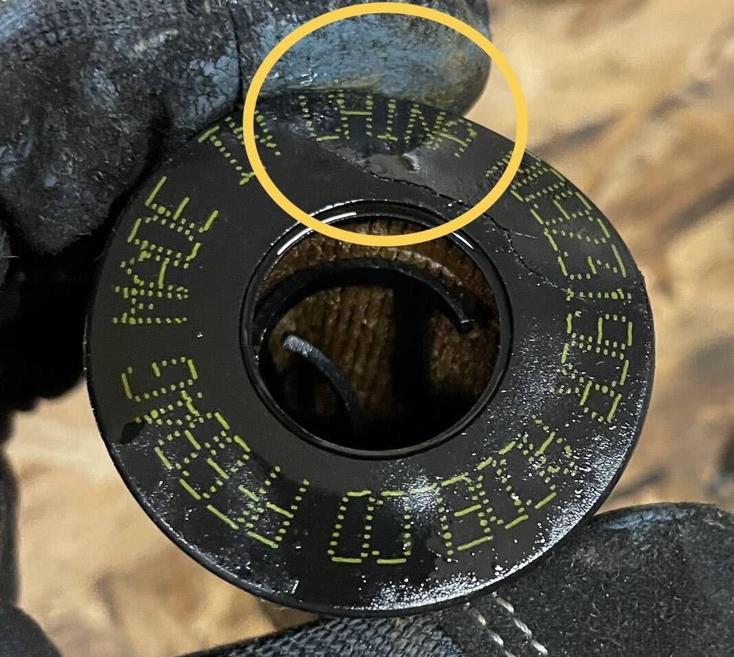

How do you know the old filter was a genuine Ford filter? Those 3 words on top "Made in China" says it all. I don't know offhand, of any Ford parts made in China. My 2087 filters have no such words on them, or the packaging. The packaging clearly say made in US.
It's not. If you look carefully at the photo, it's an AC Delco PF684G.
But it's equivalent to a Motorcraft FL2062.
I agree with some of the others. It looks like improper install to me.

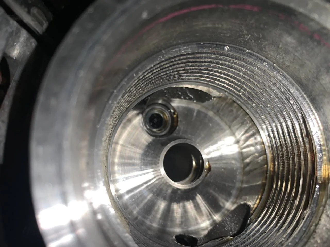

Clearly an improperly installed filter that was crushed by the nipple inside the engine block side:
This is what the engine side of the filter mount looks like. That nipple extends less than 1/2” from the base:
It wouldn’t be difficult to misalign upon installation, then twisting the housing crushes it.

Looking at the images of the FL2062 and FL2062A, there's an obvious size (length) difference between the (2) units. Shouldn't the purpose of the filter cartridge be to fit the filter cup so that it seals and is seated as designed? That's like defeating the purpose of a proper install too by using a part that isn't the proper part for the job - but we're going to cast the "its made in XYZ"...
Throwing out the fact of where an oil filter cartridge is made - it does appear that the AC Delco cartridge could have been installed incorrectly or it had moved/twisted when the oil can top was replaced.
A freestanding paper filter cartridge element that is not enclosed in a metal casing like the GT350 is prone to slight movement of the filter pleats due to engine psi and R&R of the filter. The pleats on some filters may not be as strong and would compress or "squish" sooner than other designs.
The other (2) issues too is the more debris that gets trapped in the pleats, the higher the oil psi will be and the heavier the pleats become, which is also prone to collapsing the pleated column of the unit. And if the material is more restrictive from one filter media to the next, that too affects oil psi.
