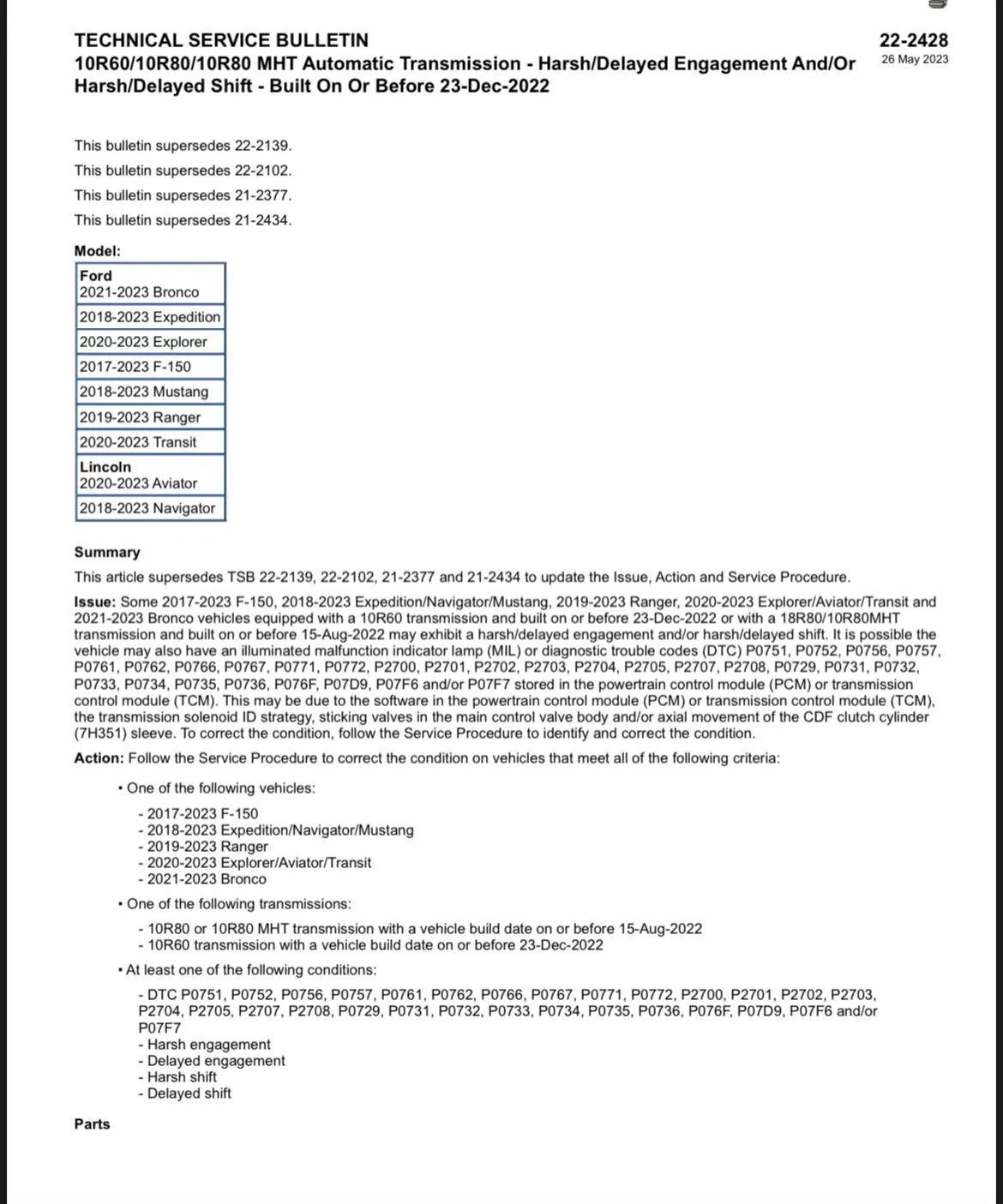

For what its worth... there's a TSB about this kind of thing
