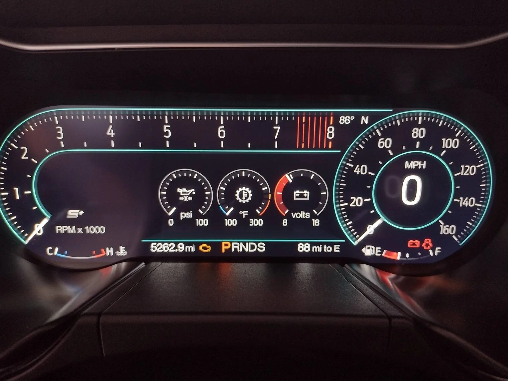

Cool, that's what I'm shooting for.
I successfully downloaded Forscan. I successfully downloaded the drivers for my OBD interface.
I went to the Forscan forum to try and get the free access and they are no longer doing this. AND my email server is on their very lengthy blacklist so I can't join the forum.
So if I understand what I have to do I should be able to connect to the car's OBD port and generate a "menu" on my computer?

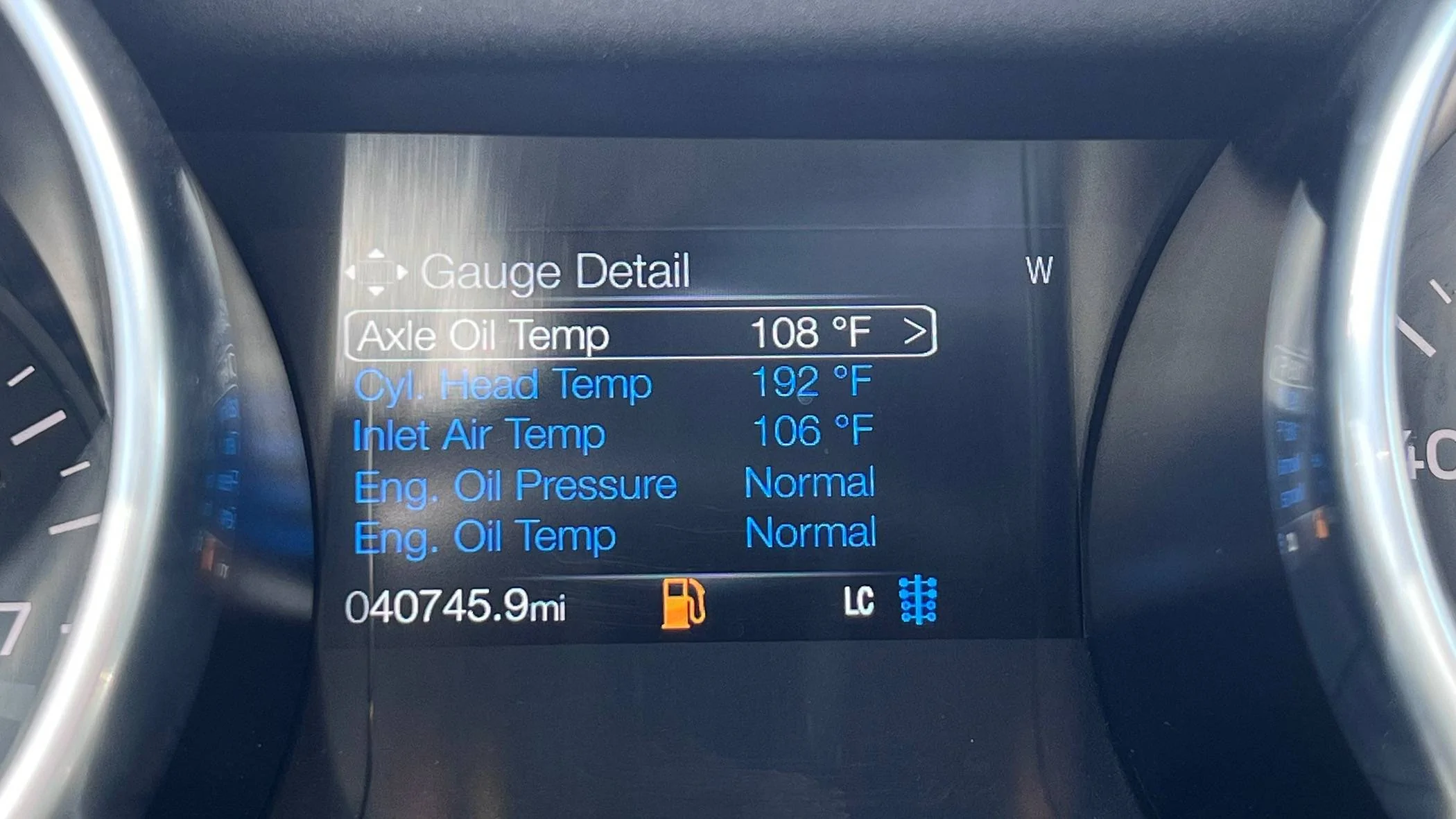

Thank you. I was able to get the gauge to display. But this list didn't change. I noticed in the tutorial at 8 seconds and at the very end you (MrBD1348) have several more lines than I do. Do you know how to edit this list?
