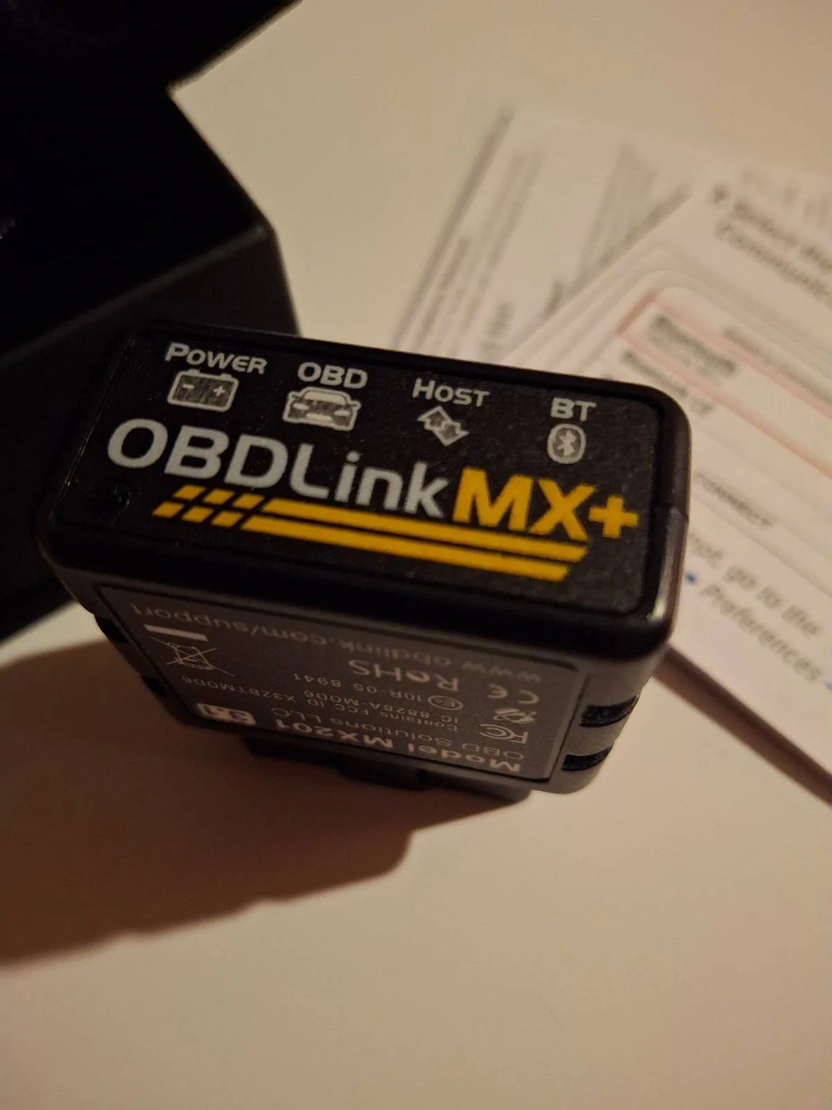

Unless they changed things the MX+ cannot write changes to the car.
It's nice to be able to reset modules. Ford once told me I needed a new steering rack. I used forscan to reset the steering module and all is working fine. 3 years ago.
