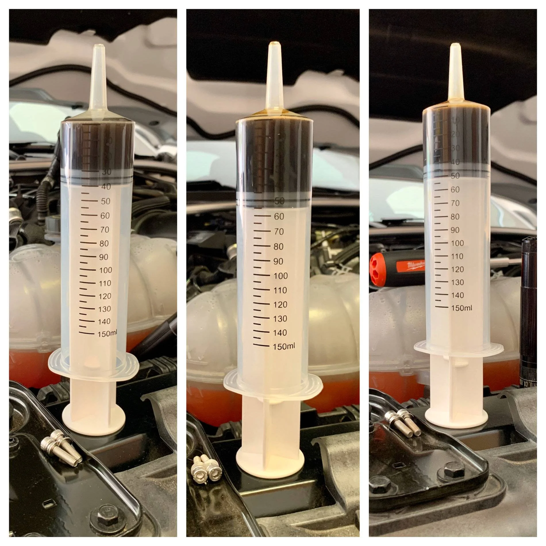

I can tell you they work.
Left = 2000 after oil change
Center = 4000 after oil change
Right = 6000 after oil change
