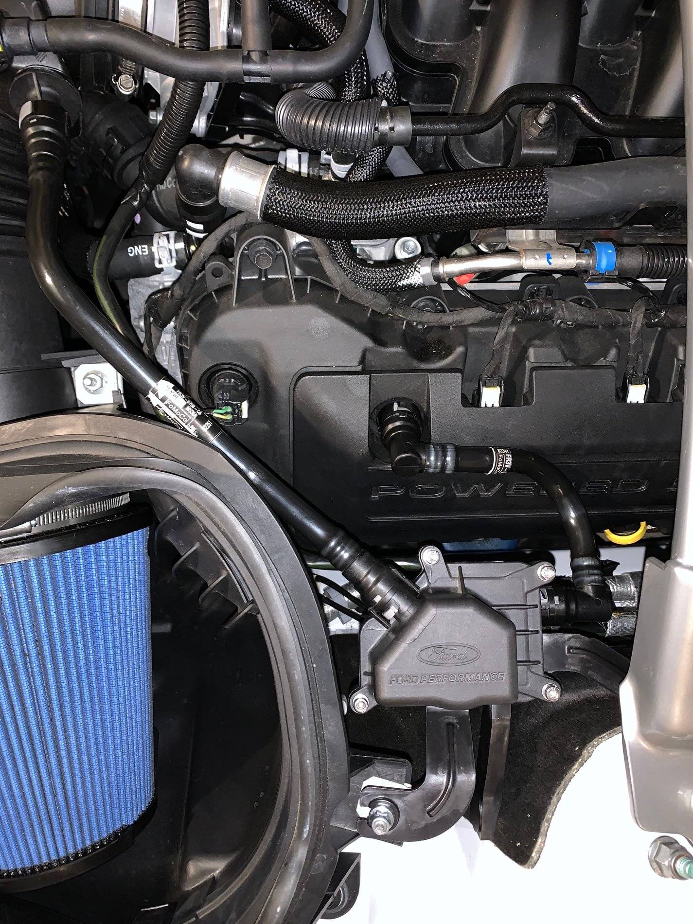

Just installed Ford Performance oil separator driver's side. Notice how separator gets in the way of oil deep stick. It's a little difficult now to check the oil level.
Pull from the firewall side of the strut brace. Comes out straighter and cleaner.
