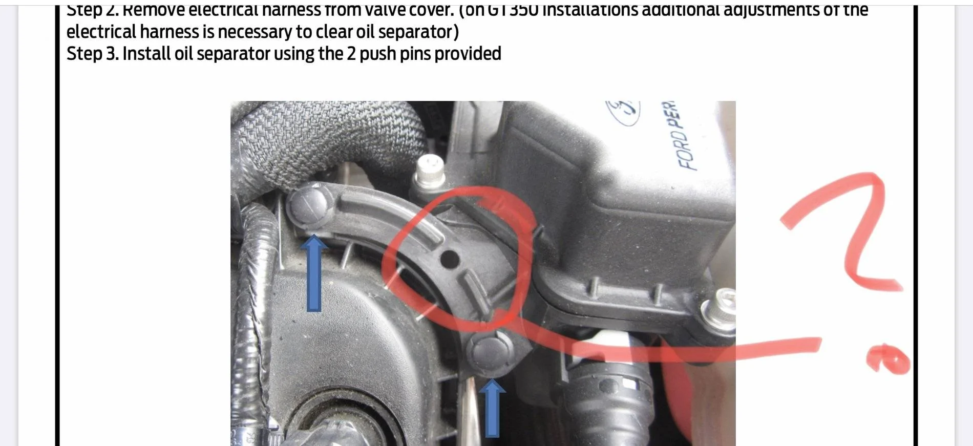

Just purchased the oil separator from ford performance.
M-6766-A50
the one I received didn't have the hole in it for the wire harness. Anyone else run into this? View attachment 432611

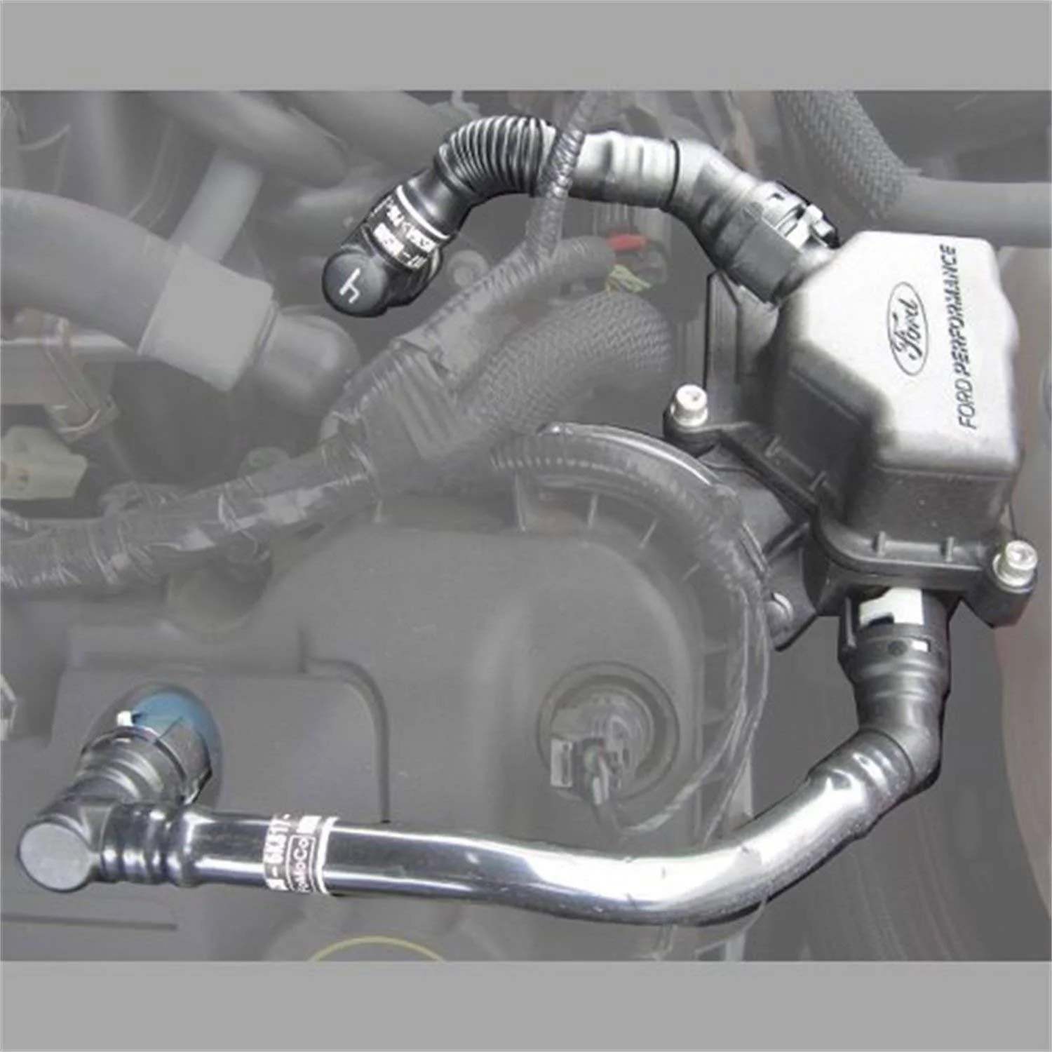

I don't remember there being a hole for a wire harness. Your image isn't loading, here is a screenshot from Amazon:

this photo is from FP instruction PDF for this part
The hole In that pic is covered up by the wire harness installed back into it

I have an early one and it has the hole. Apparently, the hole was eliminated because it weakened the bracket. The mounting tab that curves off to the left in the picture would break off where the hole is, apparently. Anyway, the newer ones don't have it any more. Mine does and it's fine.

The first one they sent me had broken off in shipment. Was definitely a weak point in the mount. Don’t drill a new hole — you don’t need it.

This is 100% correct.
Thank the Ford engineer behind the part, Ron Ewert, for listening and implementing a running change to the part that made it stronger.

The hole was eliminated (not long after the separator was introduced) to mitigate fracture issues.
