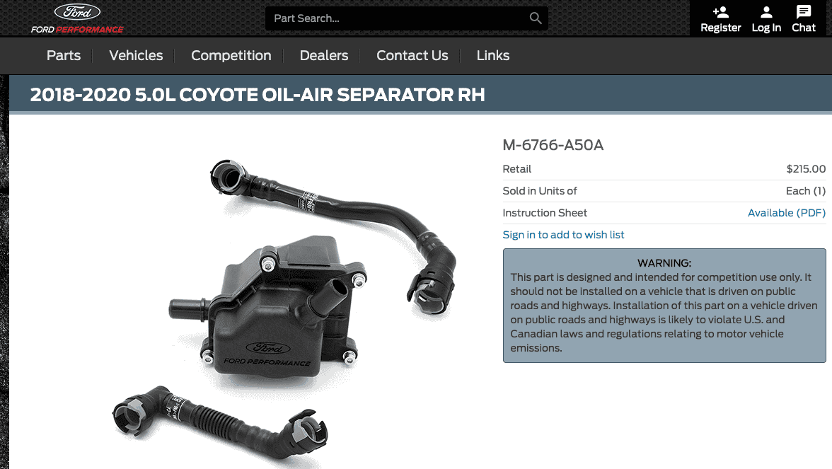

Saw this warning...
Voodoo Velocity
May 4, 2019
529
595
Tampa Bay
2019 Shelby GT350 / 2016 Acura RLX Sport Hybrid
They have to post that. An OAS will likely cause a car to fail smog tests in states / locations that have vehicle inspections. They do however, give protection to your engine's intake and combustion. I assume people who have vehicle inspection simply remove the OAS to pass inspection and replace afterwards.
ParkCity06
Dec 28, 2019
221
223
Utah
Mark
2020 GT350R HEP LR032, 2020 Raptor
Makes sense--thanks for this.

torque124
Torque
Aug 13, 2016
66
1,500
778
MA
Shelby GT350R
I need an explanation on how these will cause a smog test to fail... I don't see any relation between the PCV system ( a good working one) and the smog test which mainly relates to the health of the cat converter, o2 sensors and exhaust.
OK, if you burn a lot of oil, you will most likely trip a light as your cats efficiency will go down and secondary o2 sensor will detect that... but installing an oil separator which in fact reduces the oil entering the engine ( so it has less chances to be burned in there) to cause a smog test failure?
Voodoo Velocity
May 4, 2019
529
595
Tampa Bay
The short answer is - I do not know exactly. From what I have read it appears to be more about altering the PVC emissions system set up by the manufacturer. It may depend on the state who may fail the smog test based on a visual of the OAS. I have also read that if you do not alter the PVC flow and have a closed system (As is the FP OAS) they may pass it. Bottom line, it may vary by state and the knowledge of the tech performing your emissions test.
TX State
Jan 4, 2020
118
51
Unites States
2016 Shelby GT350 track pack
That is correct. The PCV is considered part of the emission system in a vehicle. Could it technically fail smog if it had one? Probabaly, would a random smog isnpector ever know what to look for or know what it is? I don’t think you will ever see that happen. Like stated iv ha done on every car iv owned and they catch a lot when I empty at every oil change. To me it’s worth it just seeing how much it catches and is not getting recirculated into the combustion chamber.
