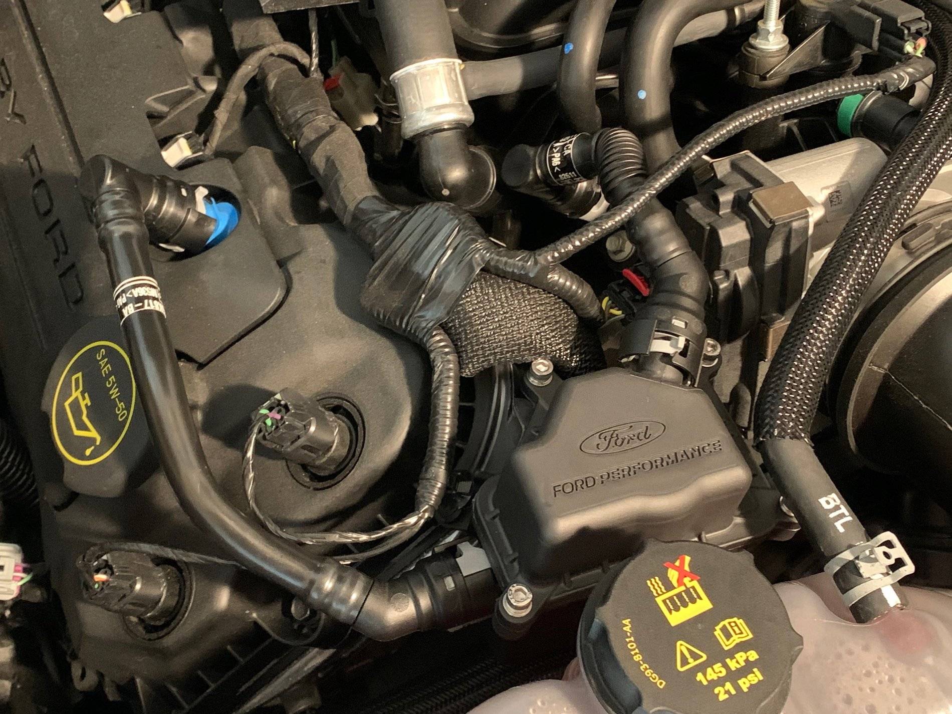

Passenger or driver side?
I have it on the passenger side. Driving car spiritually, not yet tracking. Oil separator have oil inside. Driver side tube is dry. So, I'm not installing on the driver side.
Not sure if oil separators are needed in voodoo engines as it's port injected vs. direct injected engines. View attachment 443859
