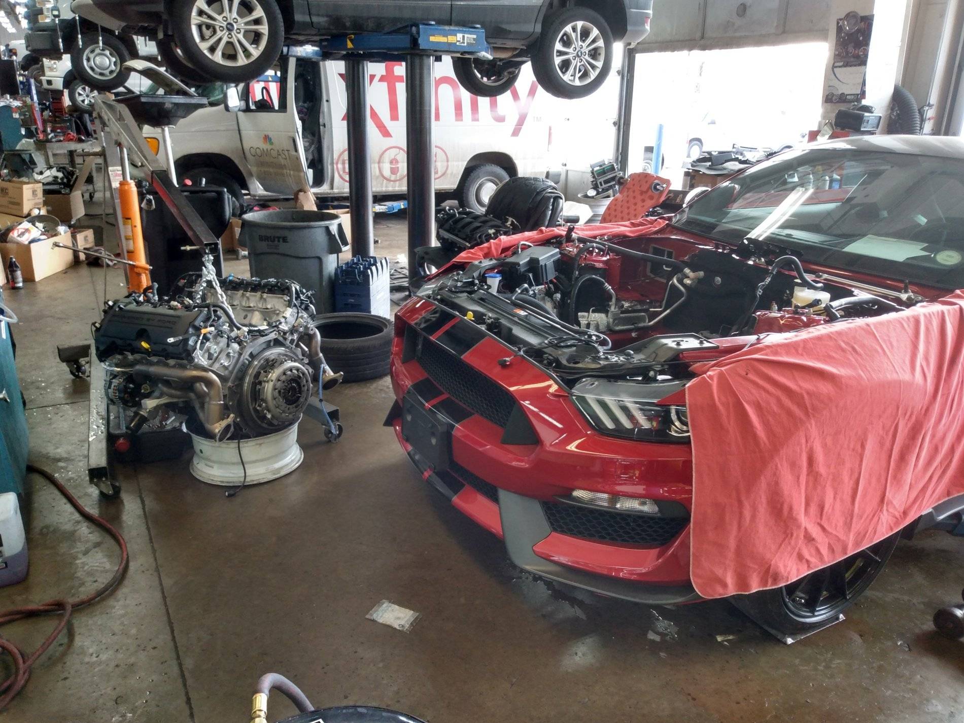

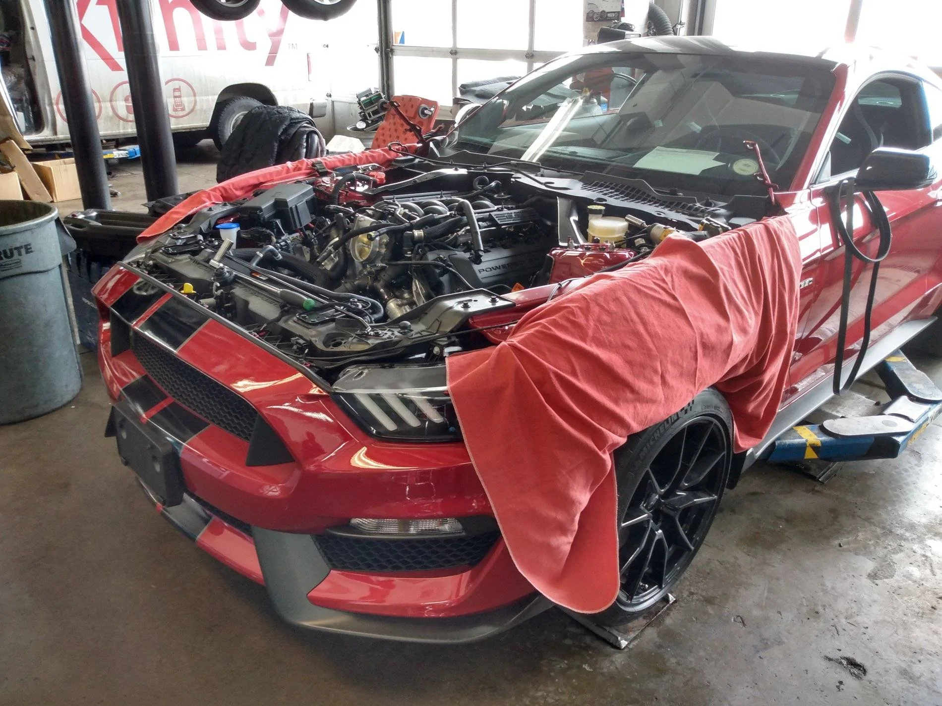

Bought a 2020 GT350 from a local Ford dealer on Feb 17. On Saturday, the engine shut down, luckily in a Target parking lot. Car was transported to the dealer’s service department on the same day. Today, got the word that the engine has likely seized up and will need to be replaced. This at 206 miles on a car I paid 70K cash for! Does anybody know what would have happened if this had happened on a freeway?
I no longer trust this car! Service people were not surprised that this happened! Wow!

Oil starvation? As for what would have happened on the freeway, worst case scenario you were going around a corner and the rear tires would lock up. You'd maybe be fast enough to throw the car into neutral or press the clutch, but most likely it'd end with you hitting another car or the guardrail.
Best case scenario, you'd have skidded to a stop or you'd have enough momentum to keep the engine turning, thus the wheels spinning.

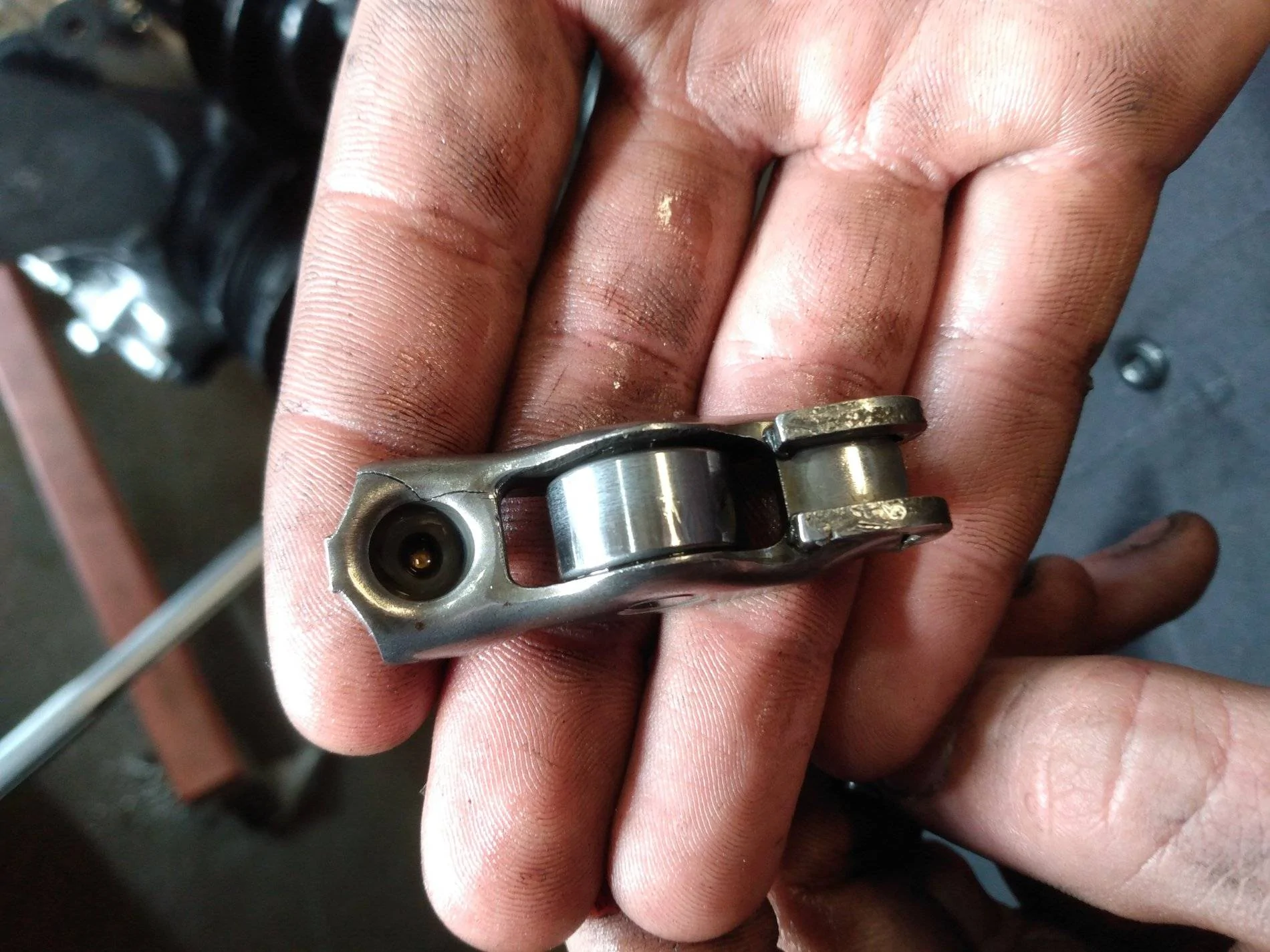

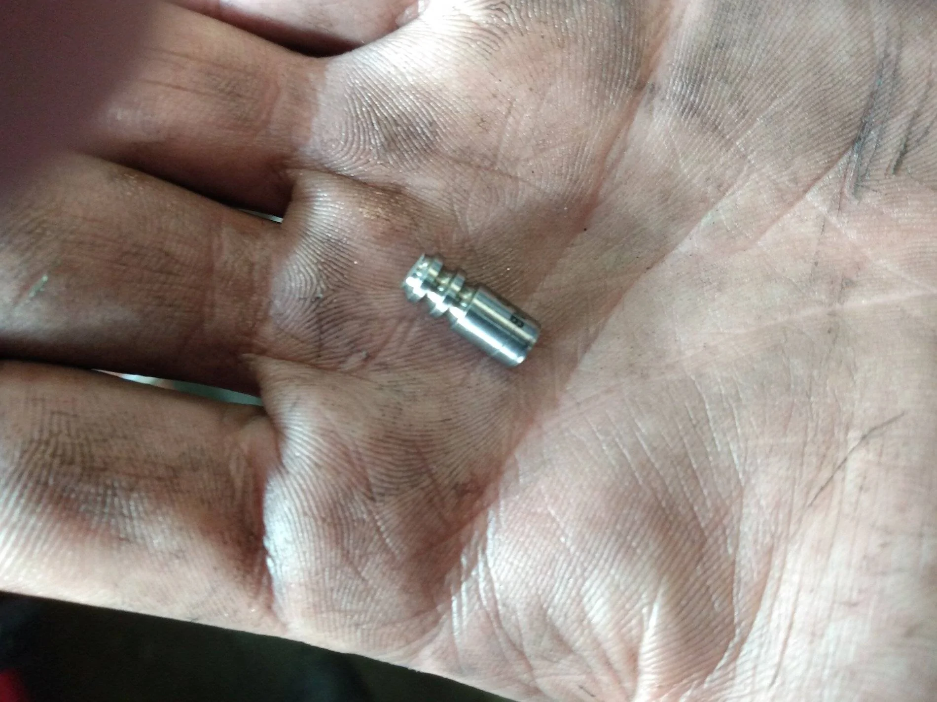

I’m betting on the bad batch of valves that their supplier is sending them ! One bad apple spoils a whole barrel

Ford buys most of the components from first and second tier suppliers and the engine builders just do assembly. I doubt Ford x rays any of the components looking for cracks and voids not visible to the eyes, including valves. So yes it’s possible a supplier sent a bad batch of valves or other components to Ford. This should be traceable though but I doubt Ford let’s anyone know what happened, due to legal issues with their suppliers.
