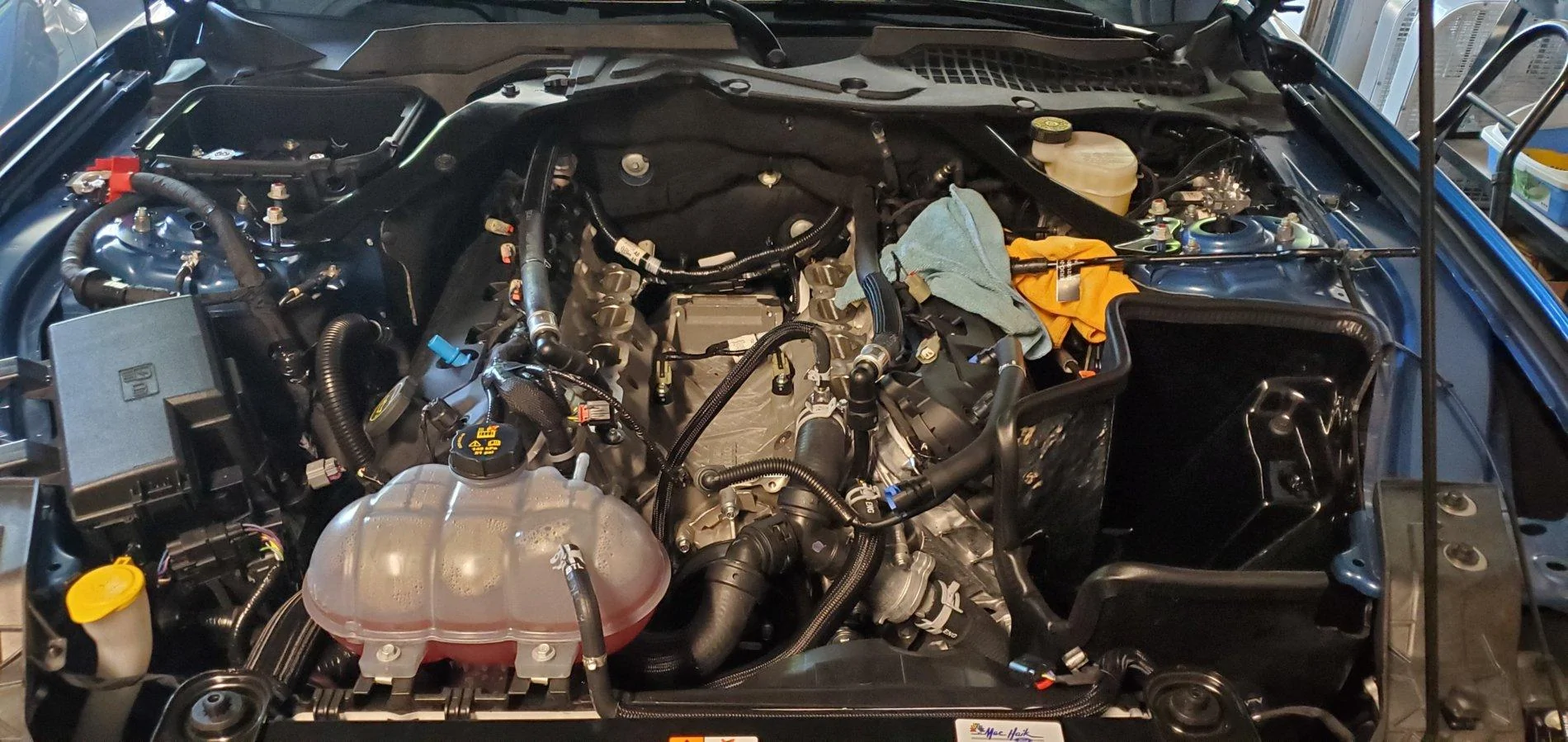

    I only saw 2 knock sensors on top when i pulled the manifold off my MY 2019. Maybe there are 2 more somewhere else. not sure..

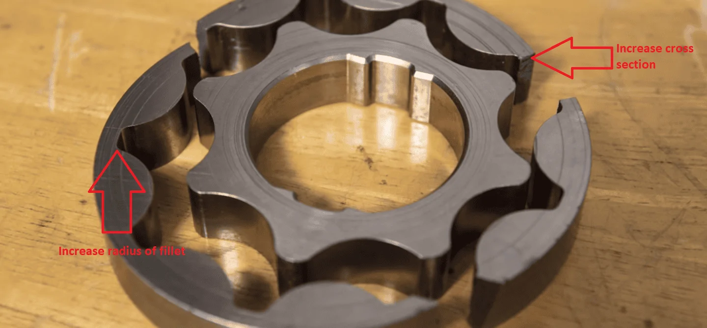

    Honestly it should be easy to make the OPGs stronger by increasing a couple dimensions...
    My issue with powdered metal is quality control. If they had some process to magnaflux the gears after forging to check for porosity or in the case of oil pump gears, possibly anneal them to reduce internal stress build up i might feel more comfortable.
    Honestly i'm unsure of their process, and i would hope that they would have some quality control in the process.
    I feel like with how some sets seem to be egg shell brittle and others seem indestructible that either porosity or excessive internal stress causing the part to be brittle would be at fault for the majority of the failures. Oil Pump Gear Changes.png

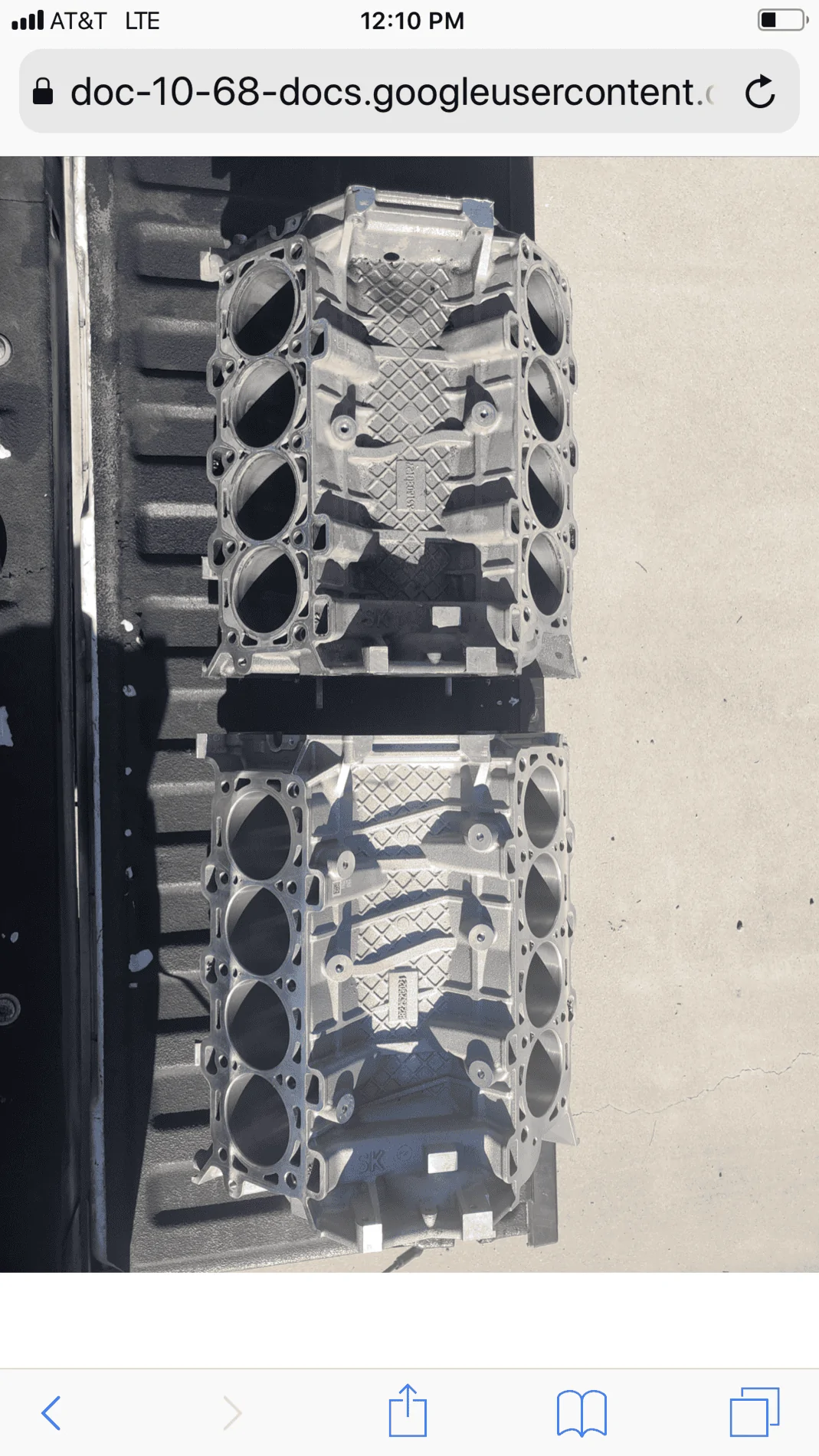

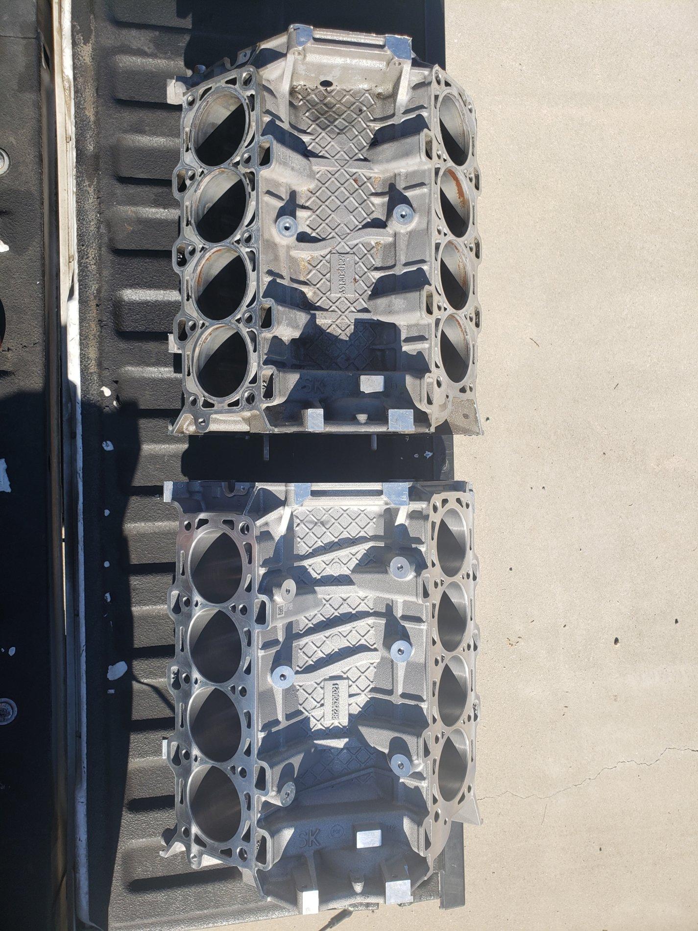

    Gen 1 and 2 side by side
    Gen 2 definitely has 4 knock sensors A7C793DE-BBB0-4A24-8A76-E743D970864A.png A8EED970-0B62-4FAA-83DC-B711D613A67A.jpeg

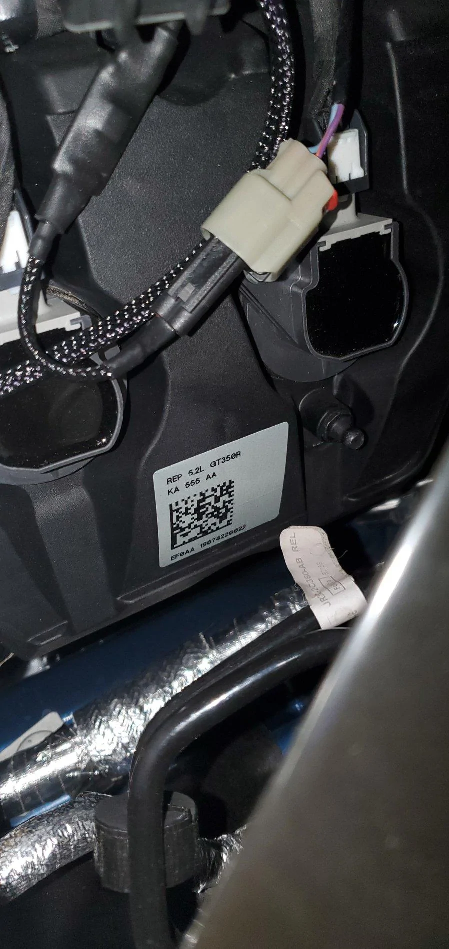

    I can see the 4 bosses but looks like only 2 sensors are installed .

    I misspoke saying the new block has 4 sensors. I meant bosses for 4 sensors (actually now looks like 6 ??)
    I assume the GT 500 uses 4/6 sensors .
