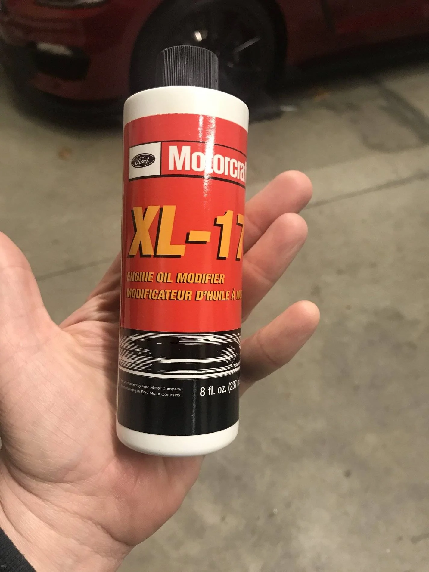

My 15 5.0 had this sound after every oil change. This is the BBQ tick as I understand it. I used full synthetic oil and read a thread awhile back from another GT owner who wouldn't give up regarding the tick. In the thread a field engineer did indeed diagnose it as cavitation. The thread stated that the field engineer mentioned he had heard it before with the F250. I tend to believe this explanation as the noise would disappear after 1k miles or so once the oil thickened up. Furthermore the only fix that I found other than ceratec or patience was a whole new short and or long block with mixed results. I wasn't interested in having my dealer perform surgery on my car or the decreased resale value so I just decided to live with it. I had an extended warranty and was mostly stock so I figured if it went boom then I would cross that bridge when I had to.
Oil typically gets thinner with use due to shearing. Look at any UOA and the used oil will have a lower KV40 and KV100 viscosity compared to the new oil viscosity.
Theory is the ticking may go away with some miles on it because the oil has become contaminated with combustion soot which acts like "carbon dust" (carbon black) which is essentially what the old Motorcraft XL-17 additive was. Ford use to recommend the XL-17 to quiet the engine ticking.
Another theory is new oil also strips some of the anti-wear/anti-friction additive layer off parts (hence the tick shows up after an oil change), and it takes some miles for that anti-wear/anti-friction layer to build back up. So seems the ticking is more related to the friction level between parts, and not actually oil cavitation in the journal bearings. If it was oil cavitation, why do some cars tick and others don't?

Out of curiosity, why did Ford 'used to' recommend XL-17 but dont any longer?
I don't know, but Ford no longer makes XL-17 oil treatment. If you go back and find reports of BBQ ticking in the early days of the Coyote, Ford field engineers would recommend the XL-17 to cure the ticking, which it usually did. Maybe Ford developed XL-17 because of the ticking issue. I'm not sure why it was originally developed.
XL-17 was developed to help engines break in without ruining them, by allowing it to perform better during the break in period without causing harm. Basically, the graphite lube slows the break-in process to prevent damage.
I went to my local Roush dealer to ask about additives, since I use Ceratec, and they said one of the best alternatives to XL-17 is Krex.
Krex is basically identical to XL-17 in being a straight forward Graphite lubricant suspended in a mineral oil base. Like Ceratec, you can use it with any oil.
I've been thinking of trying it out, since it is slightly less expensive than Ceratec, and you can use it EVERY oil change with no adverse effects. Although, they say that about Ceartec too, so heck I dunno. Also, unlike Ceratec, it is black, and you don't visually notice it in the used oil.
Yeah, seems basically the same as XL-17. Maybe XL-17 was made by Krex for Motorcraft. Is DriveSure the maker of Krex?

I have a bottle and have been very tempted to try it but it’s coal black and will turn the oil black. If something happens to the engine I fear they will disallow my warranty because I used it
