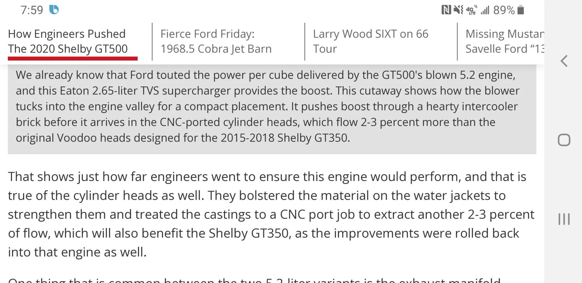

Muscle Mustangs& Fast Fords, Mustang 360°, Aug. 5th:
Cool. Curious if there would be any actual hp gain since the intake and it intake manifold are unchanged.
Wonder of ported intake manifold, the new 92mm TB off the GT350, and these heads? Any really significant gain to be had? 2-3% better flowing heads doesn't seem like much OR is it? Hmmm....
