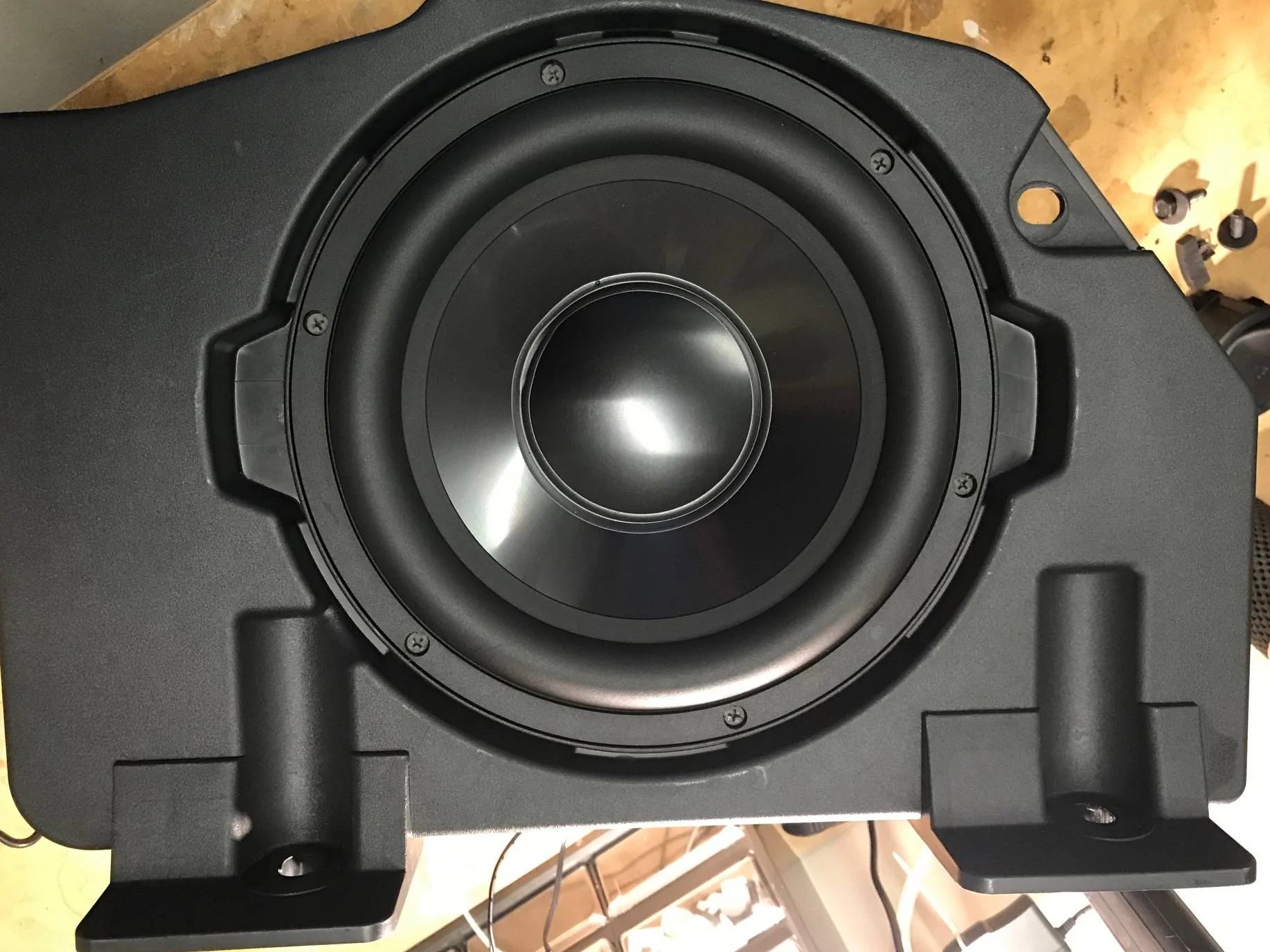

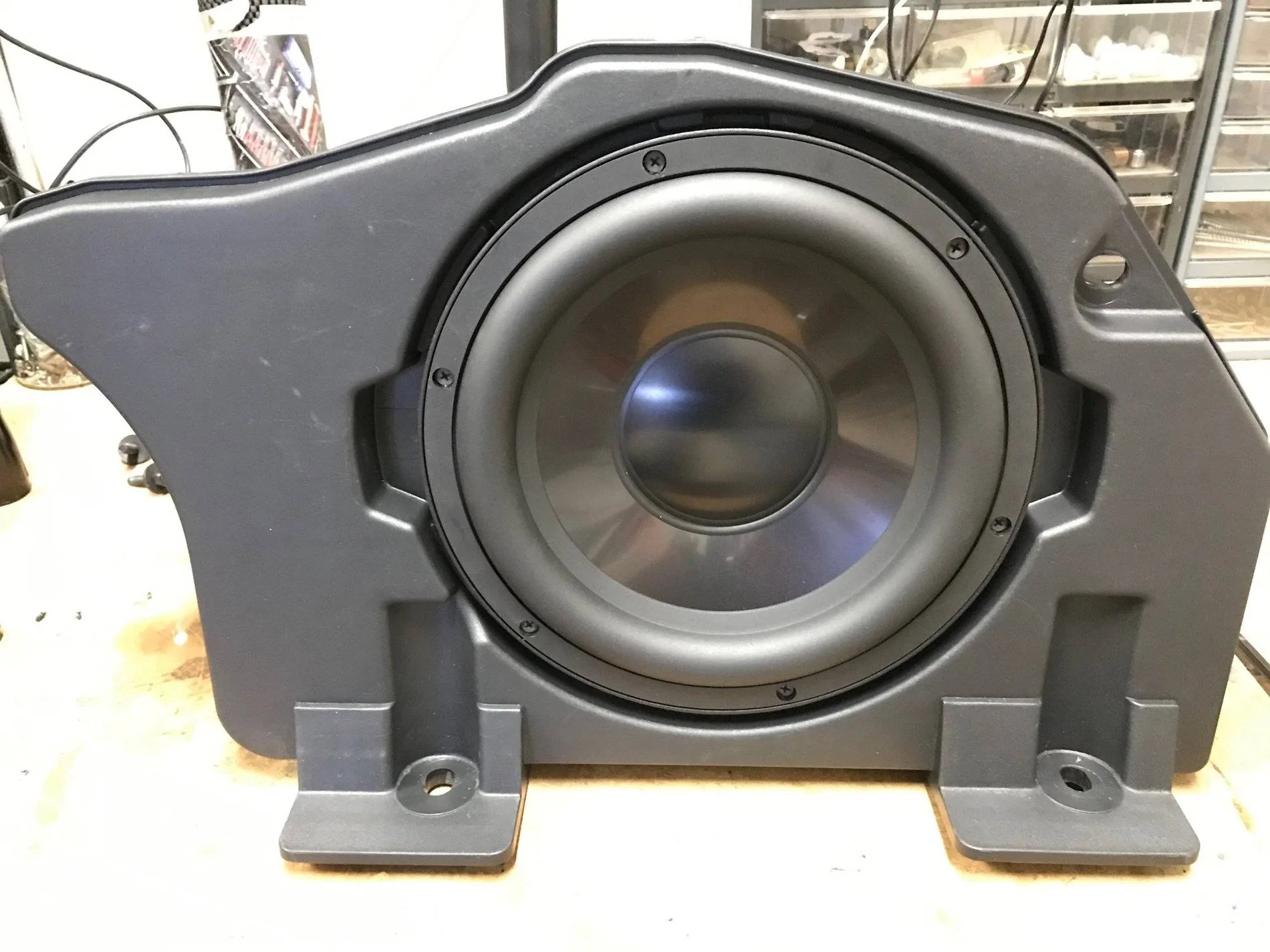

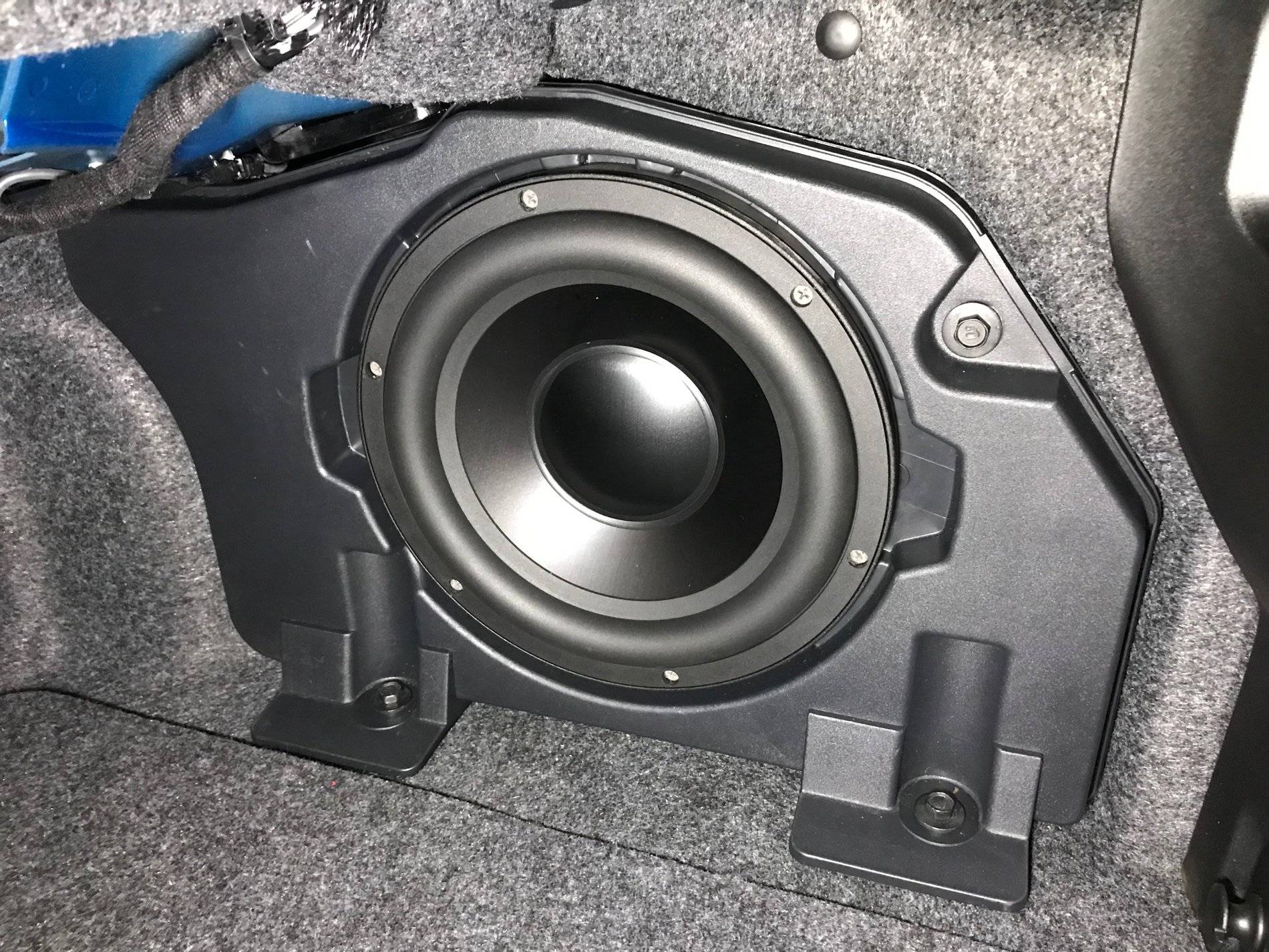

Here's what I did.
Sub: Dayton Audio RSS265HO-44, this sub is a DVC 4 ohm on each coil.

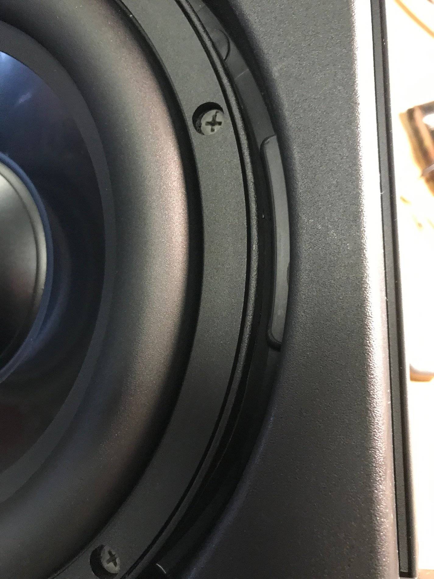

As you can see from the first pic, this sub fits in between the raised sections in the housing perfectly. Unfortunately the basket is too large for the housing so it will not sit flush without cutting the hole bigger. I didn't want to cut the hole any larger as it would have weakened the mounting structure. This means you can't re-use the original cover, but I think it looks great without it. I'ts only just slightly larger than the whole so I looked for a gasket I could use to move it away from the face of the cutout. I installed a 15mmx15mm EDPM rubber gasket (.059") around the sub with contact cement, then screwed it to the housing. Fantastic sound, but next step will be an LC2I and a separate amp. Until then, this kicks pretty hard:)

Here's what I did.

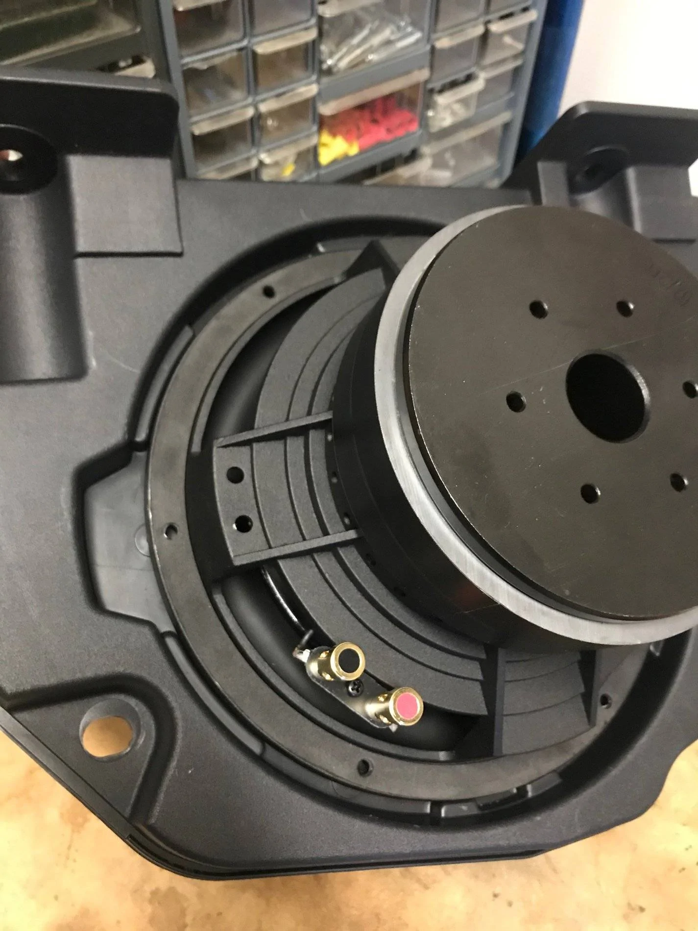

Did the bolt circle match between OEM and Dayton woofers?
Only the inner circle was off?
Did you push the connector pins out instead of snip the wires?
I may try this woofer, but wired in series to be 8ohm. Currently I run my B&O subwoofer at only a couple clicks off minimum loudness. Rather than deal with line level attenuation, it would be simpler to just quadruple the impedance. That should (theoretically) drop the sensitivity by 6dB, and that still may not be enough for balanced sounding bass.
I supposed I could also mount this woofer backwards, and then there would not be an issue with the inner hole circle mismatch. Another idea is to get the Dayton 8" woofer version, and then make an MDF adapter plate between the box and woofer. Could possibly then reuse the OEM ring and grille. The 8" response could very well be flatter than the 10" because the cone area is smaller for the small sub box.
No, the bolt circle doesn’t match, and since subs are fairly standard in their hole spacing I don’t think any would. There is no inner circle there is only one. Also the diameter between the factory holes is quite a bit larger which is Why looks kinda like it has ears on it.
I snipped the wires.

Came out looking pretty nice. My only concern would be damage via items in the trunk.
