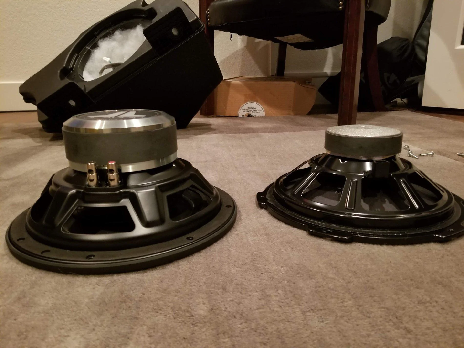

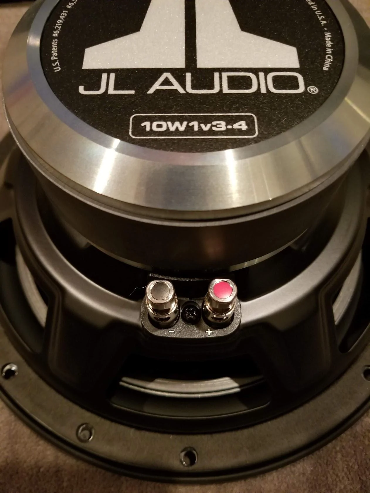

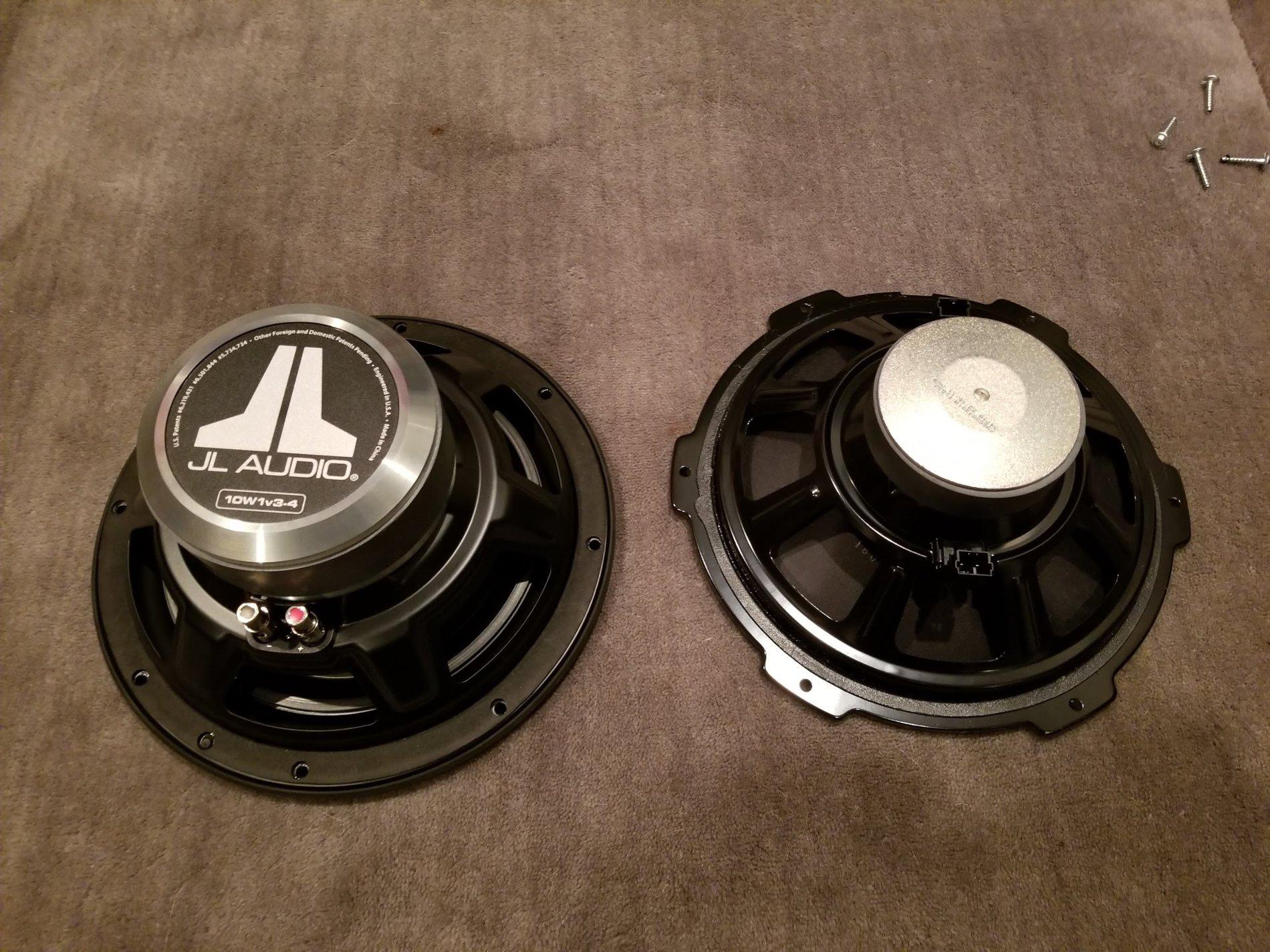

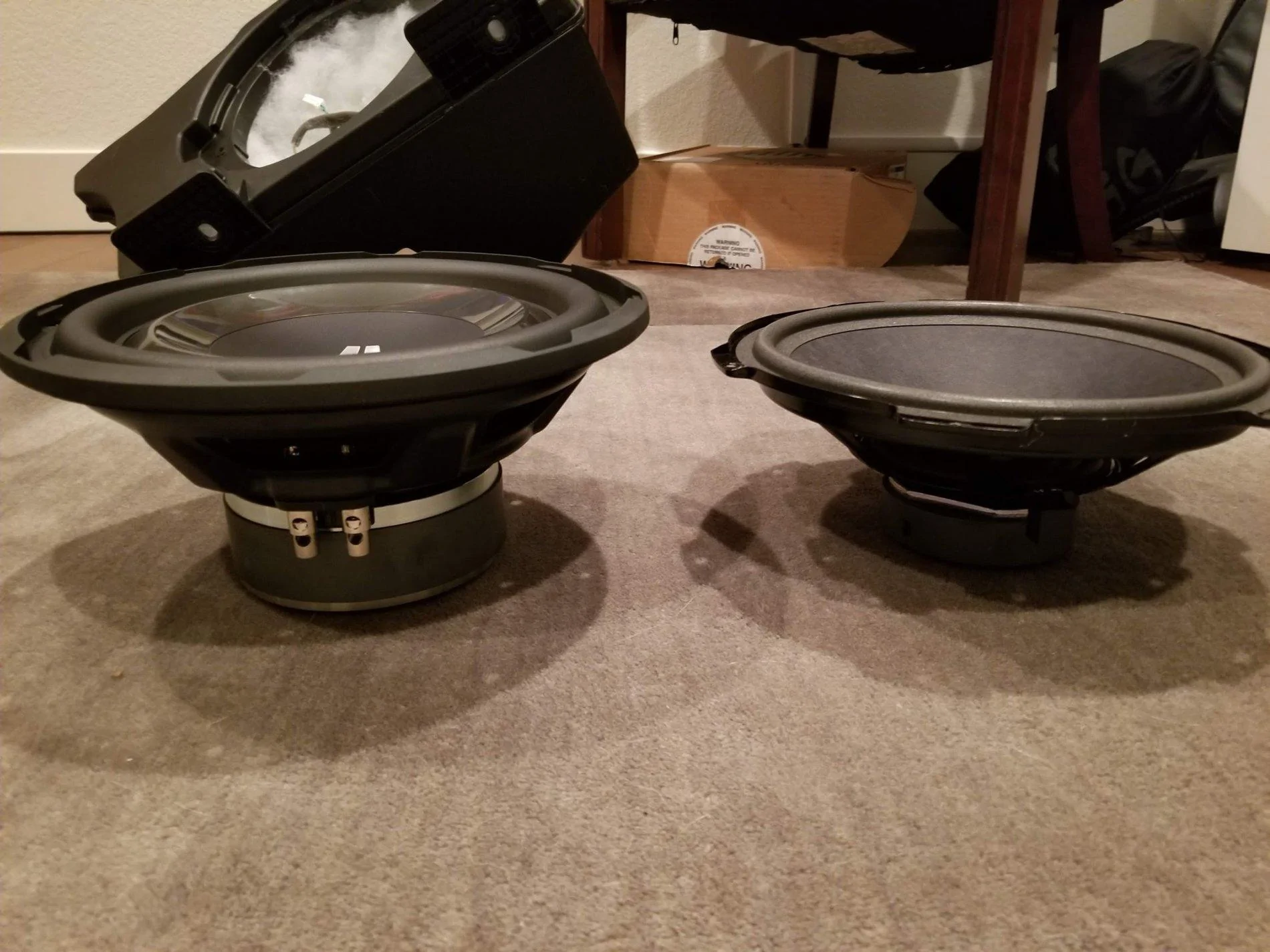

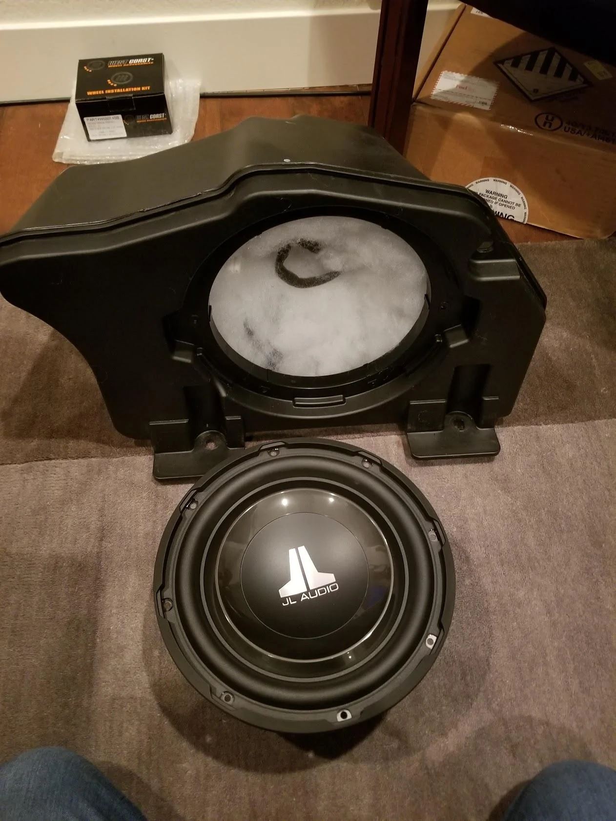

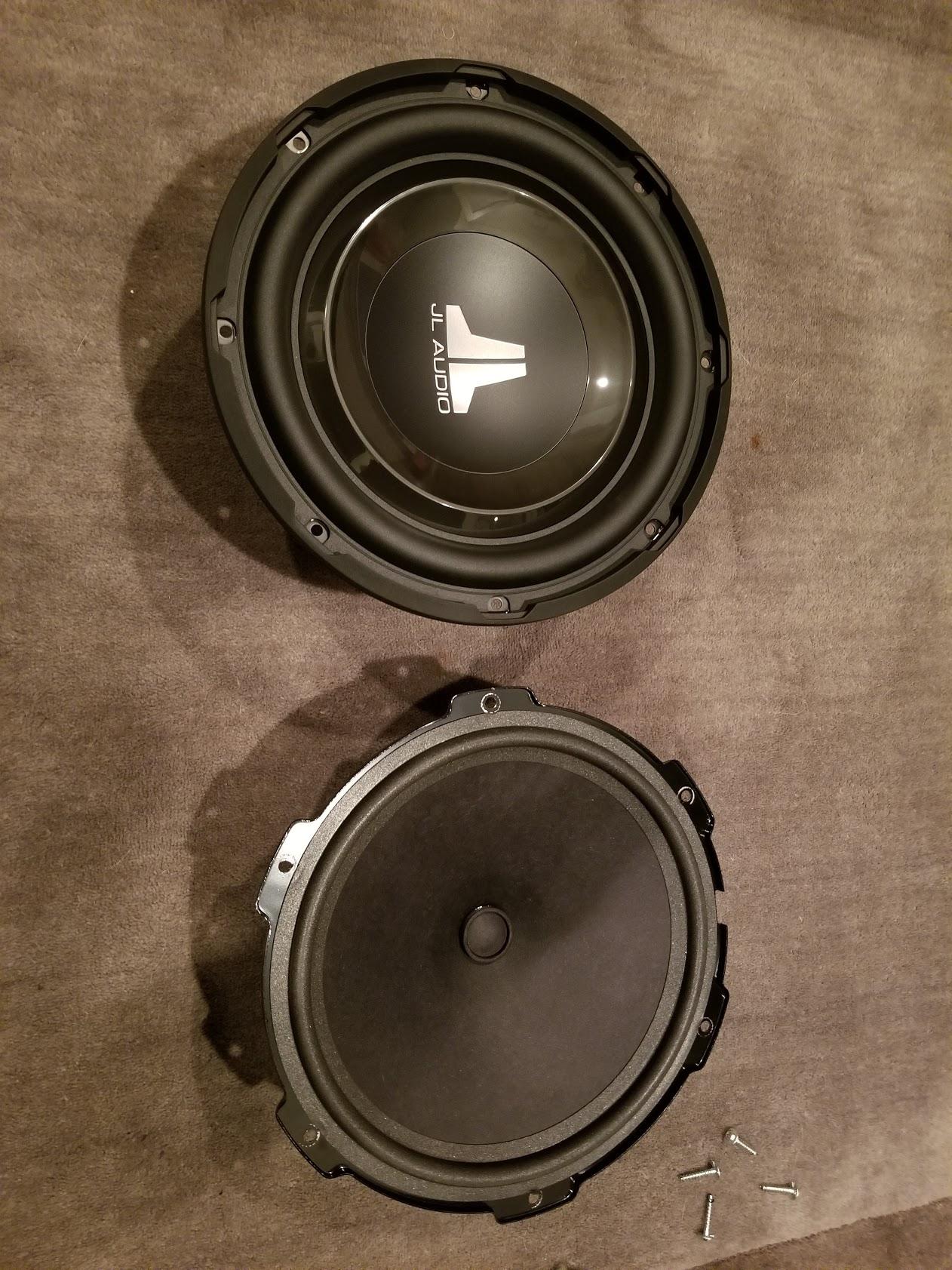

Hey guys,
Hoping more experienced dudes can chime in to help confirm.
Got a 2019 GT with 401A B&O system. Sounds pretty good, better than Shaker for sure...but Subwoofer wasn't a tight bass sound that I'm used to with systems.
Added Poly fill to the enclosure which helped tighten the sound up a bit, but still wasn't happy.
I Bought a JL 10W1v3-4 Subwoofer Driver 4 ohm 300w (These are 10 inch subs in the B&O) and I'm ready to install it.

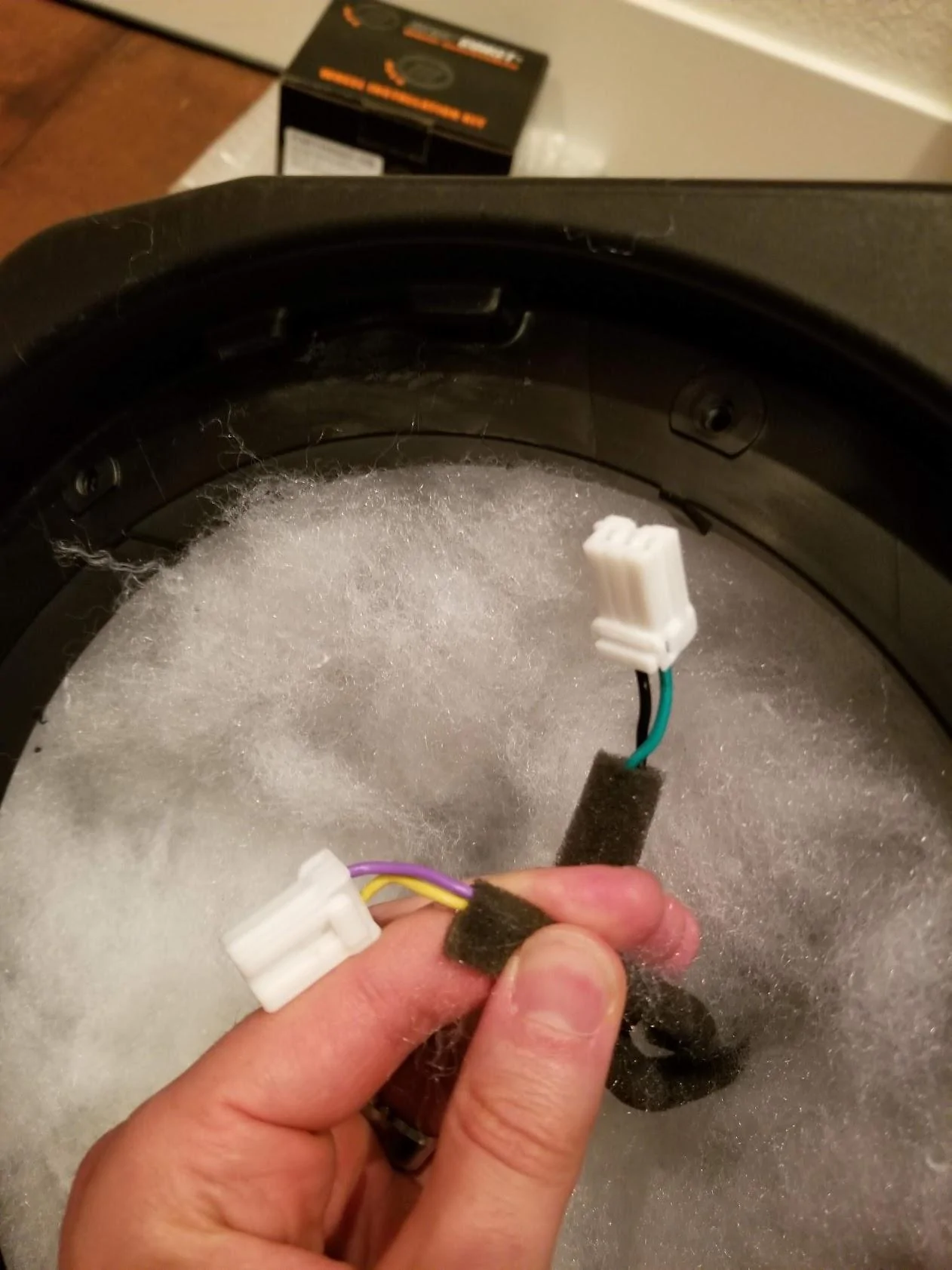

Question I have is about wiring the stock connectors to the Positive and Negative input on the JL sub.
Do I just combine the Black & Green Wires together and connect to the Negative input on JL?
And combine the Purple and Yellow wires to the Positive Input on the JL?
Pics below of enclosure, stock sub and JL sub comparison and connectors.
Thanks!

I think your going to be told to cut them, and wire 2 wires to each terminal. 2 positive 2 negative. I think thats for double voice coil. (jut going off my memory) wait til others chime in. it'll be wired for 2 ohm.
I dont honestly remember coloring pairs. im not good at this stuff, but I had to do this once and I did what I just wrote and ran the sub fine.

Anyone know how I can connect these wires to the sub? Not sure which wires are what....about to start guessing and connecting stuff here and see what happens

Just call a subwoofer shop, they can probably tell you with those 4 wires which are positive which are negative.
There’s 2 pairs there. I myself, would assume each of those wires in the clips is a positive and negative. Or else why would they be separated instead of 1 wire?
I’m not a pro. Just my guesstimate. Crutchfield should confirm.

Okay got impatient after work and got it hooked up sounds great! I'm sure a better amp would make it sound more powerful but it's a big improvement over stock sub.
For others who are interested...
Black and Purple wires go to the negative input.
Yellow and Green wires positive.
