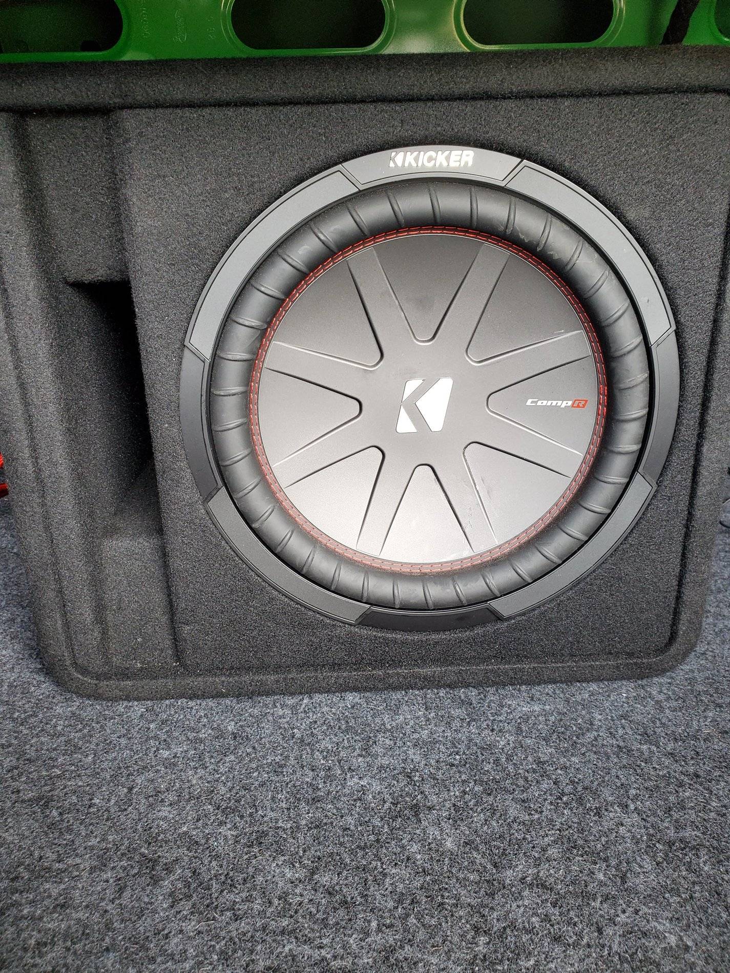

This amp is great. It's amazing how such a small amp puts out so much good power. Mine is actually putting out well over the rated 500 watts. I installed a Kicker 12" Comp R loaded enclosure and it sounded so good that I didn't even use the JL Audio subwoofer that I had put in the stock B&O enclosure. So, I have a brand new JL Audio Subwoofer that I have not used sitting in the stock location.

I use this subwoofer enclosure. It presents a 2 ohm load to the amplifier.
