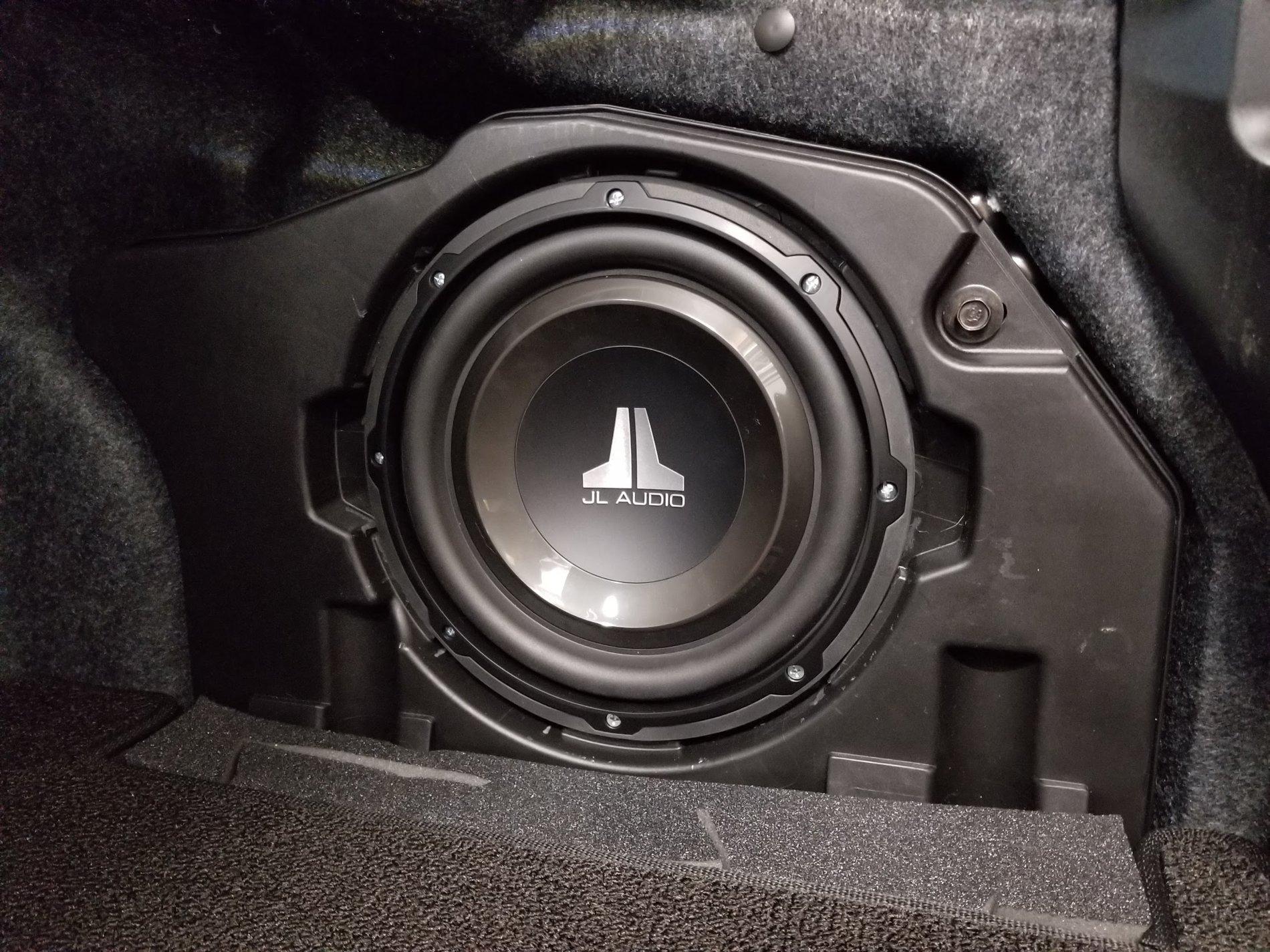

I didn't get a grill yet, I think JL has one for it. for now it's just open.
Here's a pic
Just in case others want to use this speaker, I had to dremel down the plastic bumps around the stock sub box so the JL speaker would sit flush.
I used the sand paper bit to sand down the plastic.
Wasn't hard just an extra 15 min

Thanks for the info...so not exactly plug and play especially if you want to go back to stock?

Thanks! Was there a reason why you chose a 4ohm vs 2ohm? It appears the OEM was a 2 voice coil. Just not sure what impedance.
I thought the OEM was 4ohm..oops...would a 2ohm sound better?
I guess if I want to upgrade the whole system later it's better with a 4ohm...I'm not very adept in stereo know how...any advice is appreciated!

Maybe. I honestly don't know the OEM stereo speaker specs. Not sure it would be worth the $ to swap to a 2 ohm in your case. Especially if you are satisfied with the sound. For me the stock sub is horrible! Anything would be better...
4 ohm should be safe. You don't want to go lower impedance than the amp can handle or it can damage it if you really keep it cranked up. The JL Stealthbox is 2ohm. But, their instructions don't give any wiring diagrams. The rule for good sound is to match the impedance of the amp and speakers. Also, if you can match RMS watts of your amp(s) and speaker(s) it will sound incredible. Efficient is key. You don't need a ton of power for good sound.
Here is a link that explains impedance. https://www.gollihurmusic.com/faq/31-OHMS_AND_IMPEDANCE_FROM_THE_OUTPUT_SPEAKER_PERSPECTIVE.html
