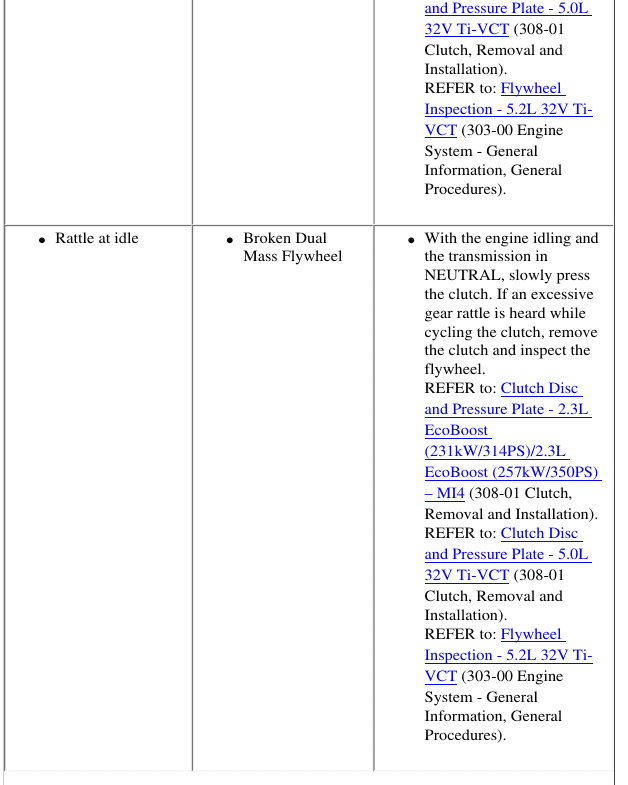

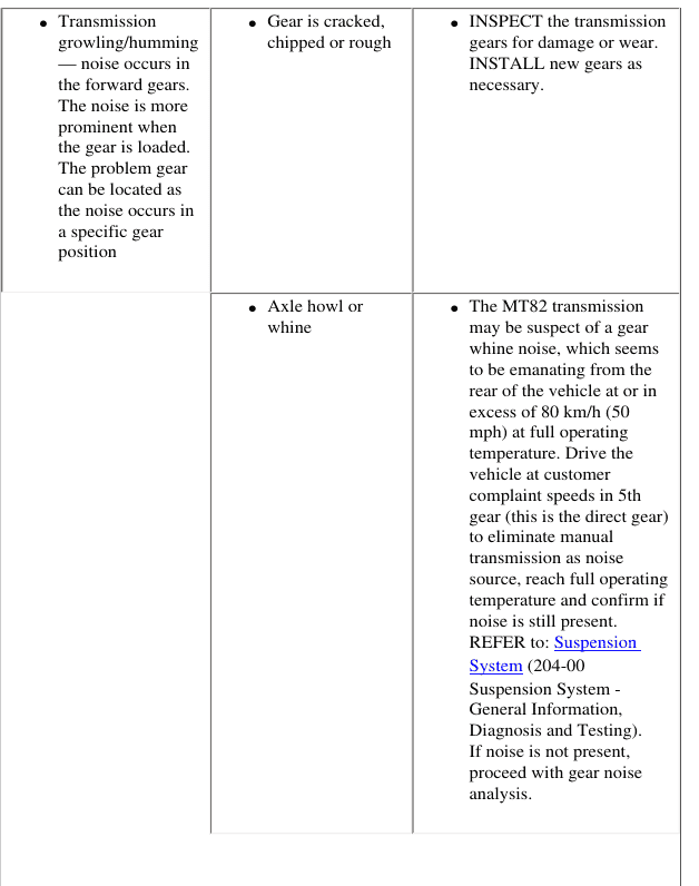

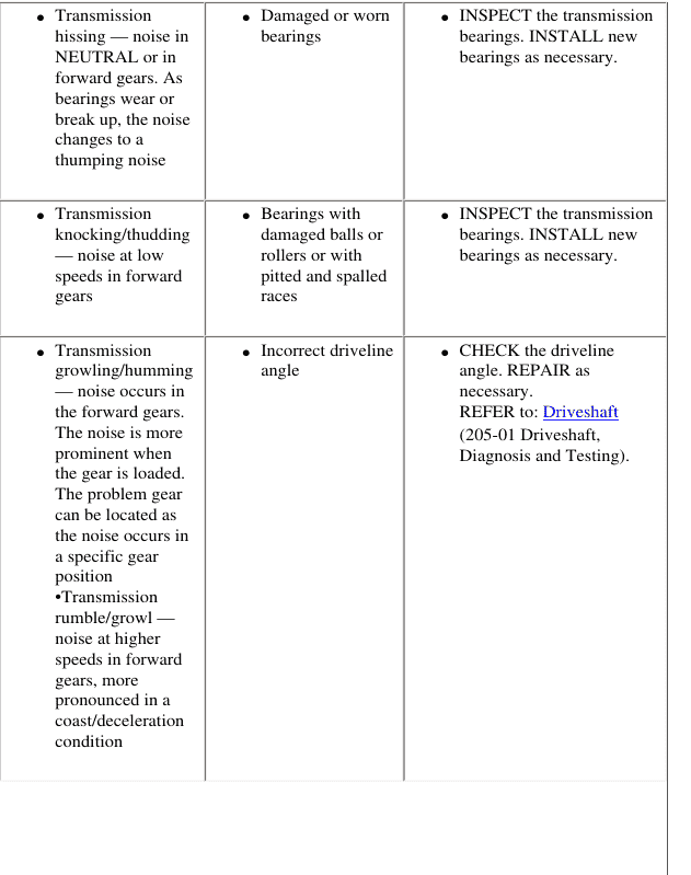

I found this in the workshop manual in the symptom chart for the manual transmission:
Symptom: Noisy in forward gears:
NOTE: While verifying the condition, determine whether the noise is gear rollover noise, release bearing rub or some other transmission- related noise.
Gear rollover noise, inherent in manual transmissions, is caused by the constant mesh of gears turning at the engine idle speed while the clutch is engaged and the transmission is in NEUTRAL.
Release bearing rub is sometimes mistaken for mainshaft bearing noise.
Gear rollover noise will disappear when the clutch is disengaged or when the transmission is engaged in gear.
Release bearing rub will disappear when the clutch is engaged. In the event that a bearing is damaged, the noise is more pronounced while engaged in gear under load or coast than in NEUTRAL
Possible source: Lubricant
Action: ADD or DRAIN and FILL with specified lubricant. REFER to: Transmission Draining and Filling (308-03A Manual Transmission- 6-Speed Manual Transmission – MT82, General Procedures).

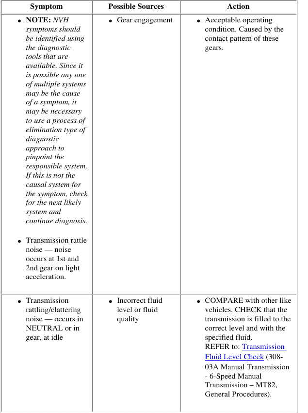

Since gear 3 is also affected it's not this:
symptom: Transmission rattle noise — noise occurs at 1st and 2nd gear on light acceleration.
possible source: gear engagement
action: Acceptable operating condition. Caused by the contact pattern of these gears.

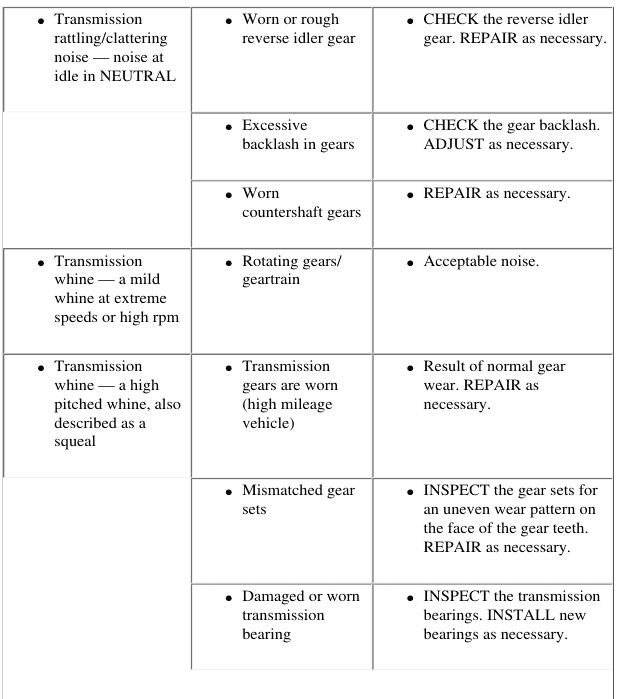

It sounds more like this one:
symptom: Transmission whine — a high pitched whine, also described as a squeal
possible source 1: Transmission gears are worn (high mileage vehicle)
action 1: result of normal gear wear - replace gears
possible source 2: mismatched gear sets
action 2: inspect for wear pattern and replace
possible source 3: damaged or worn transmission bearing
action 3: inspect, replace
