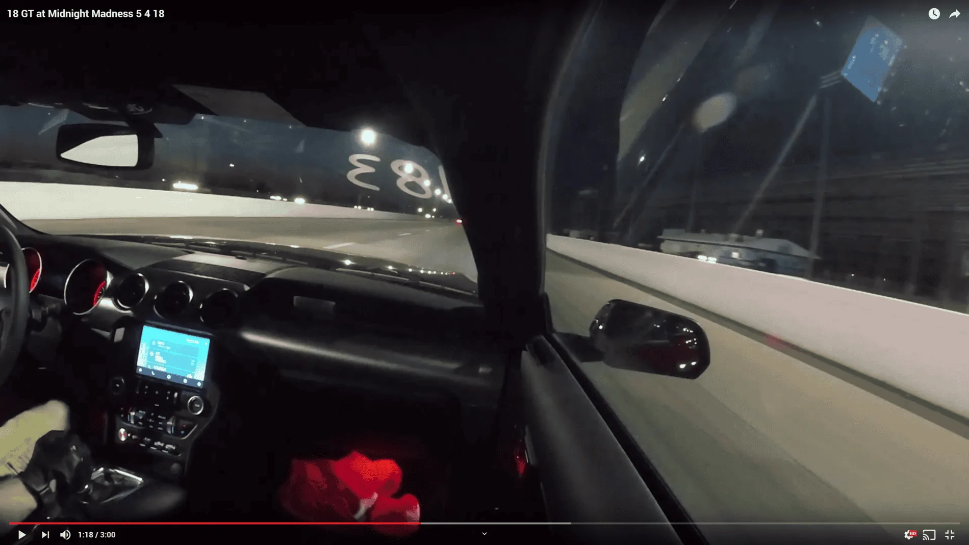

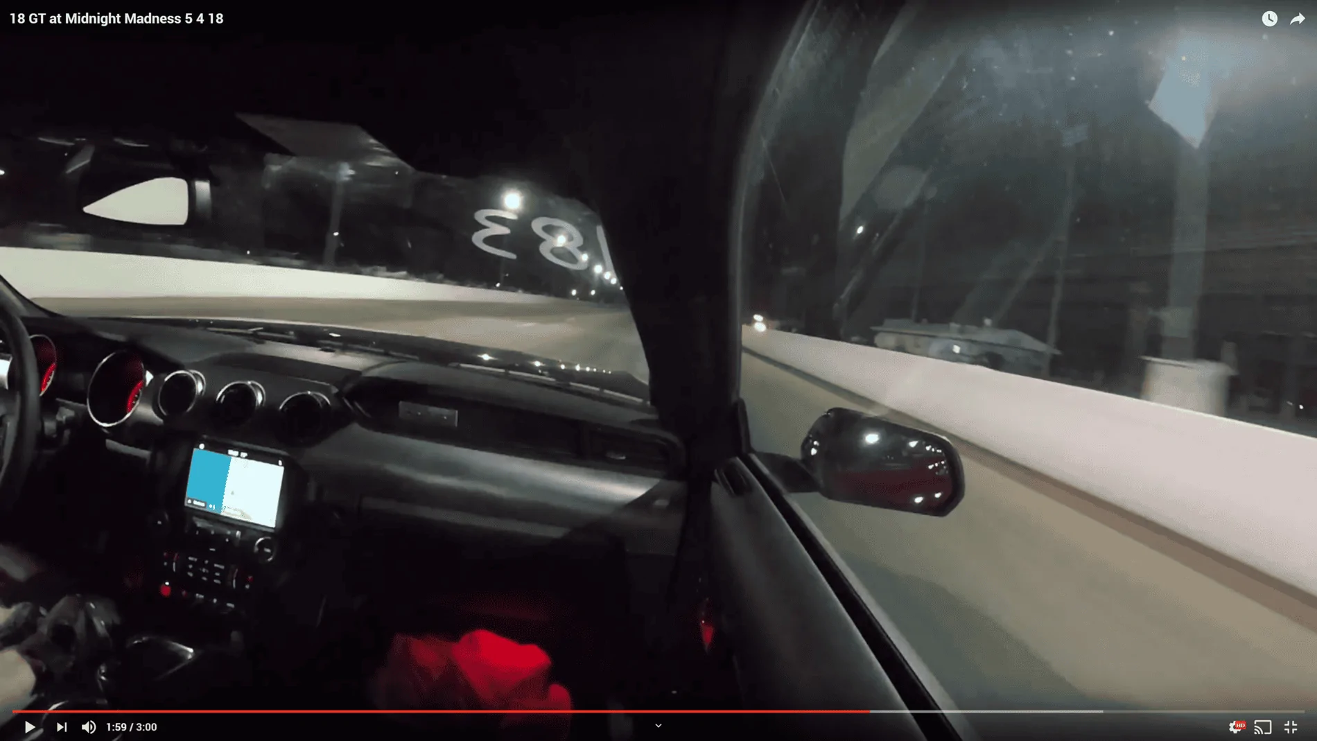

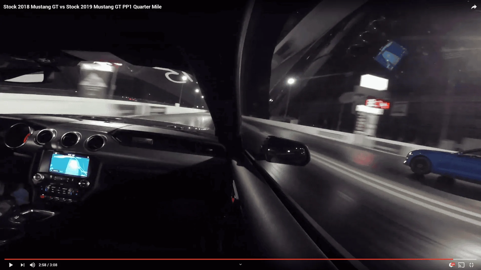

In the attached images, 2 of my 3 attempts to shift into 4th from 7500rpm 3rd fail, but in an odd way. Best description is that 4th gear turns into neutral, no grinds or "hard walls". I slap the console trim with the shifter like there's nothing there. Typically, I have to let off the throttle and put the shifter back into 4th to engage the gear.
Is this what you consider "lockout", or something different? I've always thought "lockout" meant the synchro physically won't let you shift and would feel like a rock wall.
I have the Steeda trans mount bushing and Steeda shifter bushing so far. My brother is going to try the Blowfish bracket on his 2019 (ships today).

This is definitely not the lockout most people are referring to. This sounds like your clutch never let you engage the next gear (I think if it was synchros, you'd hear gear grinding).
Do you still have the stock clutch? Also an MGW would probably be a more efficient solution than all three of the trans mount bushing, the shifter bushing, and the blowfish bracket.
I used to have the lockout most people refer to (hitting a wall when shifting); got an MGW and it went away.

I am still on stock twin disk clutch. My brother and I think a trans mounted shifter would be the solution. He's trying the Blowfish, and I am eventually going to install the MGW. It just bewilders me that I can move the gearshift so freely in these moments without any grinding. Figured I'd post about it to see if anyone else has experienced this. Certainly hasn't happened in any other manual I've owned. Hell, my old 1996 Probe GT shifted at 7800 better than this...
