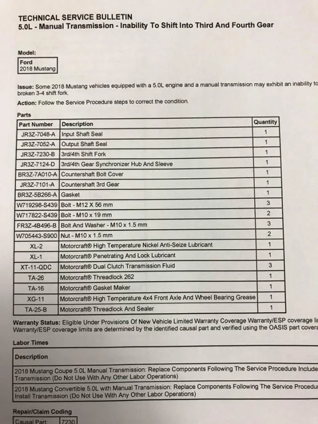

I made a post a while about about my MT-82 4D losing 3/4 gear.
Well, after 42 days now, Ford FINALLY has an answer for me other than "We have no ETA for your vehicle."
I was given the run around, told 4-5 different times that transmissions were being emergency ordered, that shift forks were back ordered for months.
All the while they were redesigning the forks/synchros.
I talk a little more about the TSB in the video below.
Watch it if you'd like, don't if you don't want too.
TSB 18-2175 is the TSB, if you are having issues shifting into 3/4 they will try and reproduce the error, if they can, they will replace the parts listed.

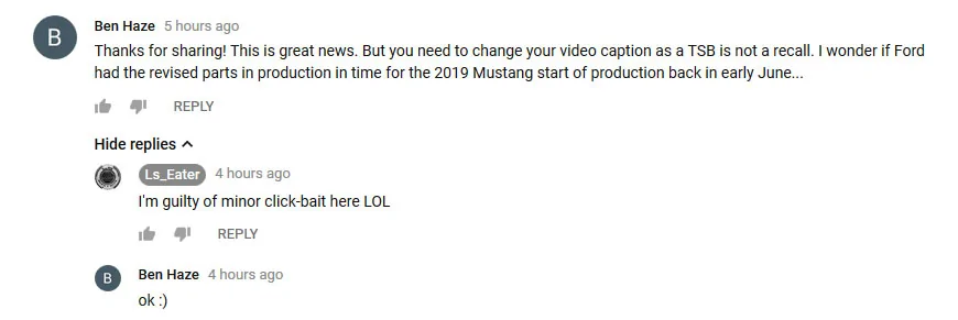

Do you think that Ford got this done quick enough to go in the early 2019?
I can’t imagine that they wouldn’t implement it into the new model year, but who knows *♂.
If I were a betting man I’d say it’s implemented in the 2019.

The unanswered question still is if the parts are redesigned or not.

"FU?" Really? Anybody can wreck a transmission, A real hamfist can wreck a bulletproof trans in 100 miles of driving, and a smooth operator can eke out many thousand of miles on a weak transmission.
Sometimes it's a little bit of both.
Glad you are getting taken care of. You do get a lot of attention bashing Ford and posting inflammatory titles. I mean, if everying was AOK there's no clicks so you must admit to exaggeration.
As an owner of a MT 2018, and an engineer, I'm looking for accurate information. You could have some. Let's find out.
I can't help thinking, having made a study of transmissions, that if it was a design problem it would affect more than a tiny percentage of cars. Likely a lot of people driving theirs much faster, on racetracks, with a lot more HP would have had issue.
So your unfortunate trouble is probably just another typical failure edge case in a complex mechanical part. Oherwise it really would be a recall, and not a TSB. Definitely a hassle and a far too long to wait. It would be nice if they compensated you for your trouble.
However, I can find no evidence that Ford "redesigned" anything. Can still be the fact that when somebody bends a fork, the TSB is merely helping dealer mechanics to make a quicker diagnosis and repair. Don't forget the Ford dealerships charge Ford corporate for warranty work, and Ford corporate would like to make those reapirs go faster.
Of course if they replaced a fork with a stonger one you may be right. But the thought that The MT forks were insufficiently strong is... hard to believe.
If you know of actual fork changes that are going into the new MT-82 please post a link to where you got this information. Not hearsay from a service manager. Transmssion documents are breakfast reading for me so please share for all of us.
I think none, but I'm happy to be shown that I'm wrong.

In a way you are right. The idea is to not just throw parts at a car. So, a TSB is not going to tell a tech to forget normal diagnostics and just replace parts without a reason. This is especially true when there is a part number change. Essentially, this type of TSB is a communication of confirmation from an OE that there is an established issue, and rather than make a tech and customer go through a ringer of diagnostics/repair, direct them to make a repair with “revised” components/software for the said confirmed issue, without actually saying, “there is an issue with XXX - please install the revised XXX”.
Companies do not want a recall associated with their name. They won’t initiate them if they can get away with assessing the situation in other means. I am not saying that THIS particular situation is/could be a recall. However, you cannot say, “there is no issue - you are 1 of 5 people that will ever see this.” If that’s the case, I will put money on it, there would be no TSB...
At least Ford is addressing it :thumbsup:
